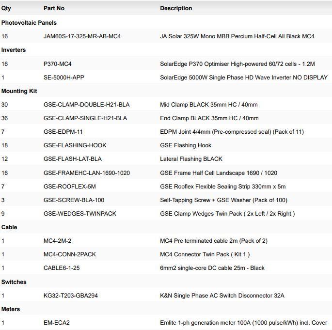

Conor Posted December 7, 2020 Posted December 7, 2020 (edited) I'm installing a 5.2pkW array - but split 50/50 from a south facing roof and a west facing roof. So most I'll generate at one time is going to be closer to 3.5-4kW. Edit: I may be adding another couple pkW in the future once we have our garage installed - should I future proof now? My supplier has specced a 5kW inverter. Is this correct or should I be using one limited to 4kw? I've not confirmed with my DNO yet, but I'm assuming I'll be limited to the usual 3.68kW export as I'm on a single cable shared with several properties. Edited December 7, 2020 by Conor

Conor Posted December 7, 2020 Author Posted December 7, 2020 Thanks @ProDave. Seems my DNO won't confirm whether they will go above 3.68kW until after my system is commissioned... cart before the horse!!
joth Posted December 7, 2020 Posted December 7, 2020 20 minutes ago, Conor said: Seems my DNO won't confirm whether they will go above 3.68kW until after my system is commissioned Hmm It would be illegal to commission the > 3.68kW system without approval in advance from the DNO, so no idea how you proceed there! The DNO application will need to know exact design, schematic and BOM for the install in order to approve, but you have most of that already. FWIW my original G99 went in for 7.36kW (i.e. 2x 3.68kW inverters) and that took months to approve (in parallel to the PP for it), but when we swapped to the newer 8kW single phase inverter (SE-8000H) then it was a couple weeks to get the existing approval updated. I'm not sure there's any downside in over-specing the inverter now and not installing all the panels to it until a later date; if I thought I might expand the system in future I expect that's what I would try to do.
Conor Posted December 7, 2020 Author Posted December 7, 2020 (edited) 1 hour ago, joth said: I'm not sure there's any downside in over-specing the inverter now and not installing all the panels to it until a later date; if I thought I might expand the system in future I expect that's what I would try to do. That's a good call. There's not much cost difference between inverters so I may as well go big. I can install the GSE mounts and even the panels and just not connect up the four west ones once I've approval for more. Edited December 7, 2020 by Conor
Conor Posted December 7, 2020 Author Posted December 7, 2020 (edited) Update. Supplier has said the solar edge can be configured to output at a lower limit. So I'll go for the 5kW inverter for now, and If I go for more panels in the future it can handle up to 7.5kW anyway. Edited December 7, 2020 by Conor 1
