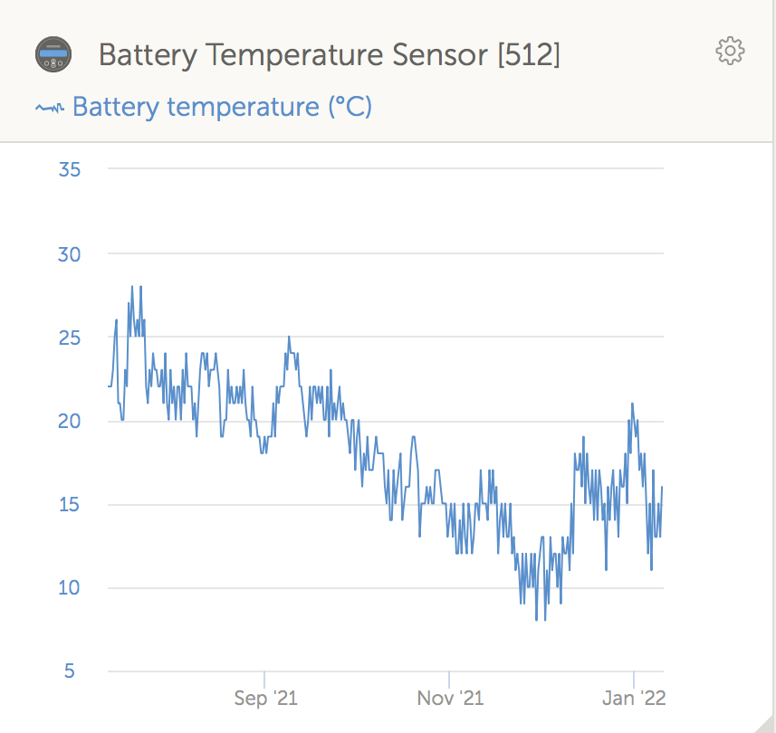

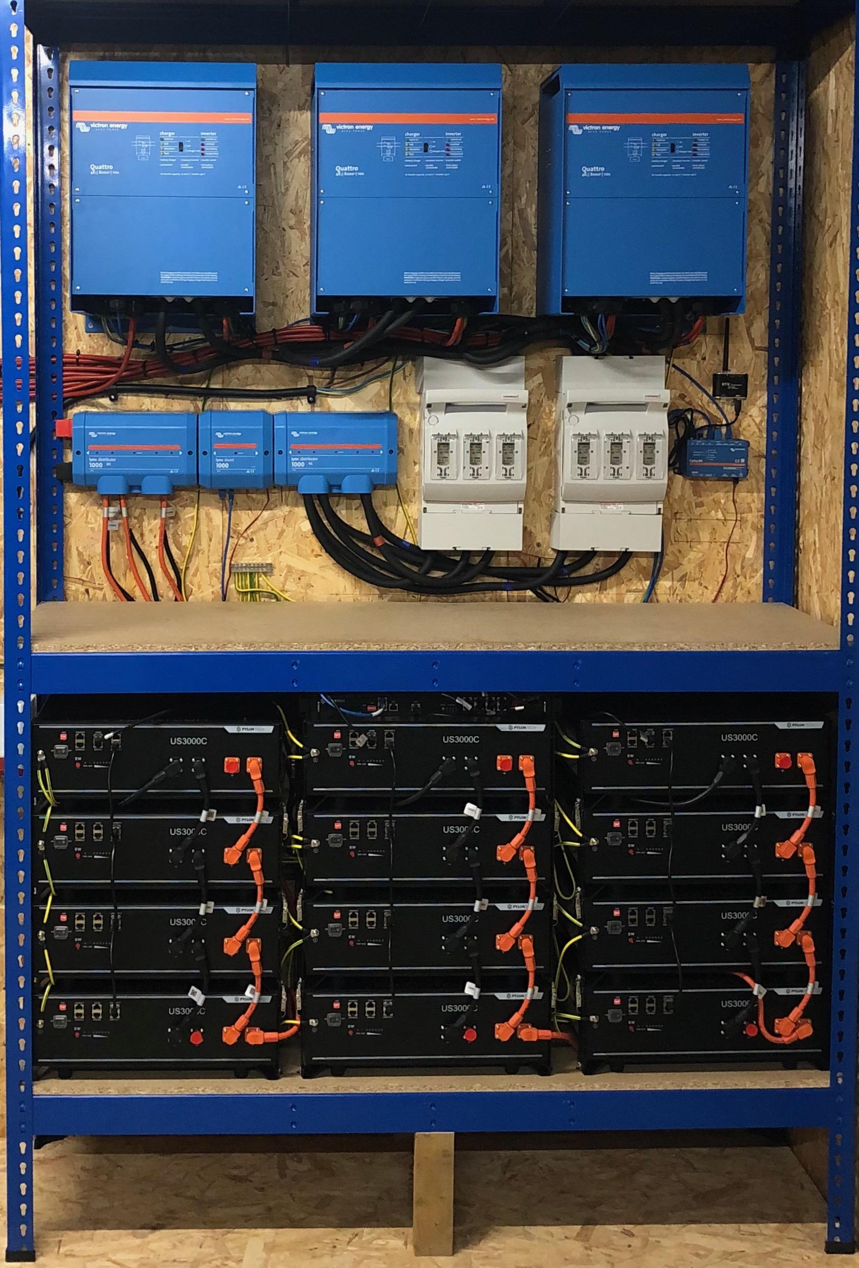

My battery setup is in an unheated and poorly insulated workshop. I found the heat generated from the batteries soon dissipated and the temp dropped. Since putting a crude cabinet around the batteries (mid December) the average temp is 15°C, workshop temp approximately 5°C. At this time of year I charge the batteries from the grid at night.

IMG_0824.thumb.jpg.3851e319ffe5b7735835dd77c4de0287.jpg909927733_ScreenShot2022-01-10at15_31_14.thumb.png.ac04d5d91ac4d3d6400b607d88aa0696.png
Thanks for the reply David. Thats a nice setup you have there. It's given me food for thought.
My garage sits at about +5C when the temperature outside is -2C. It's nice to know that the batteries will keep  themselves warm.
