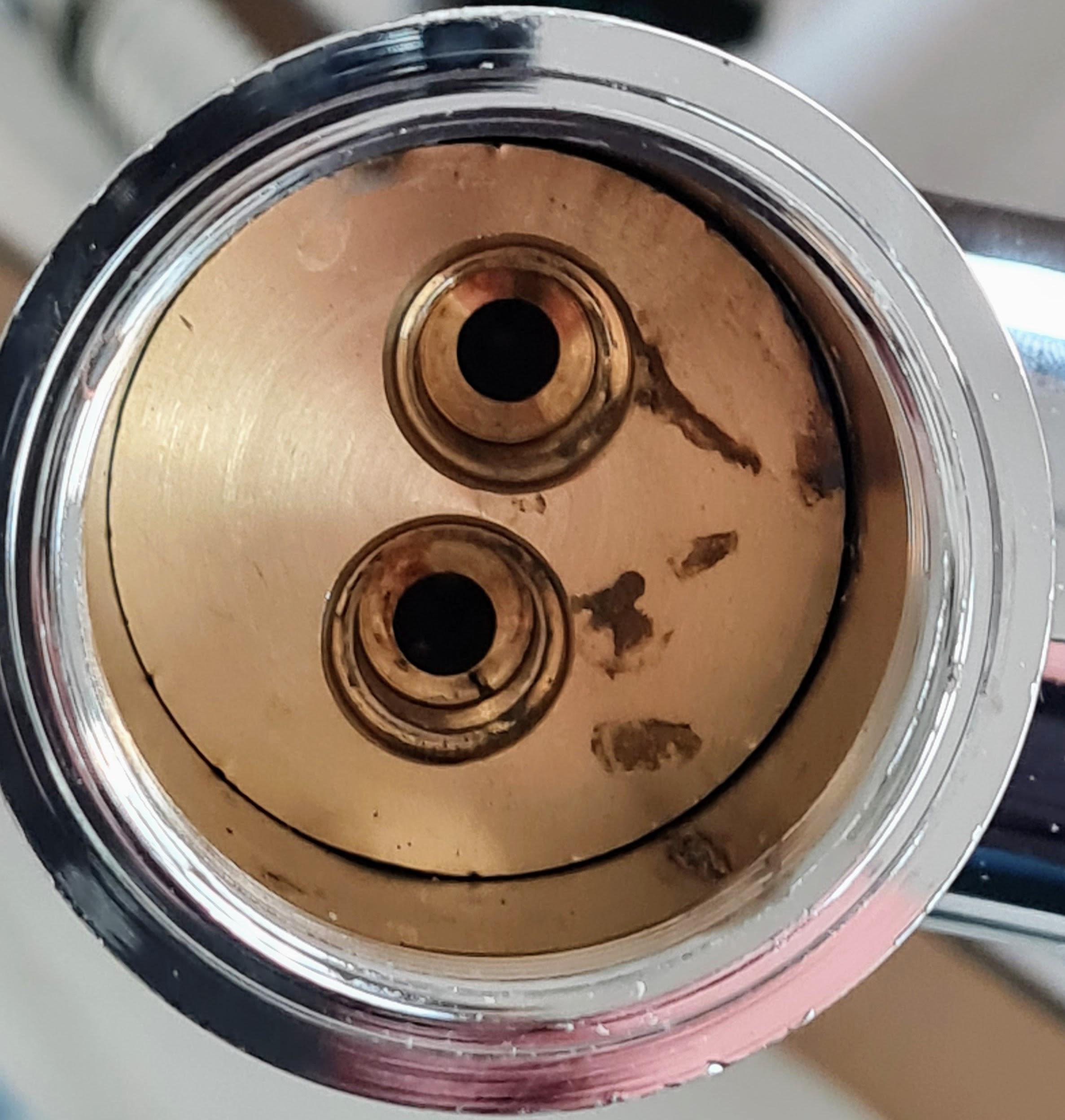

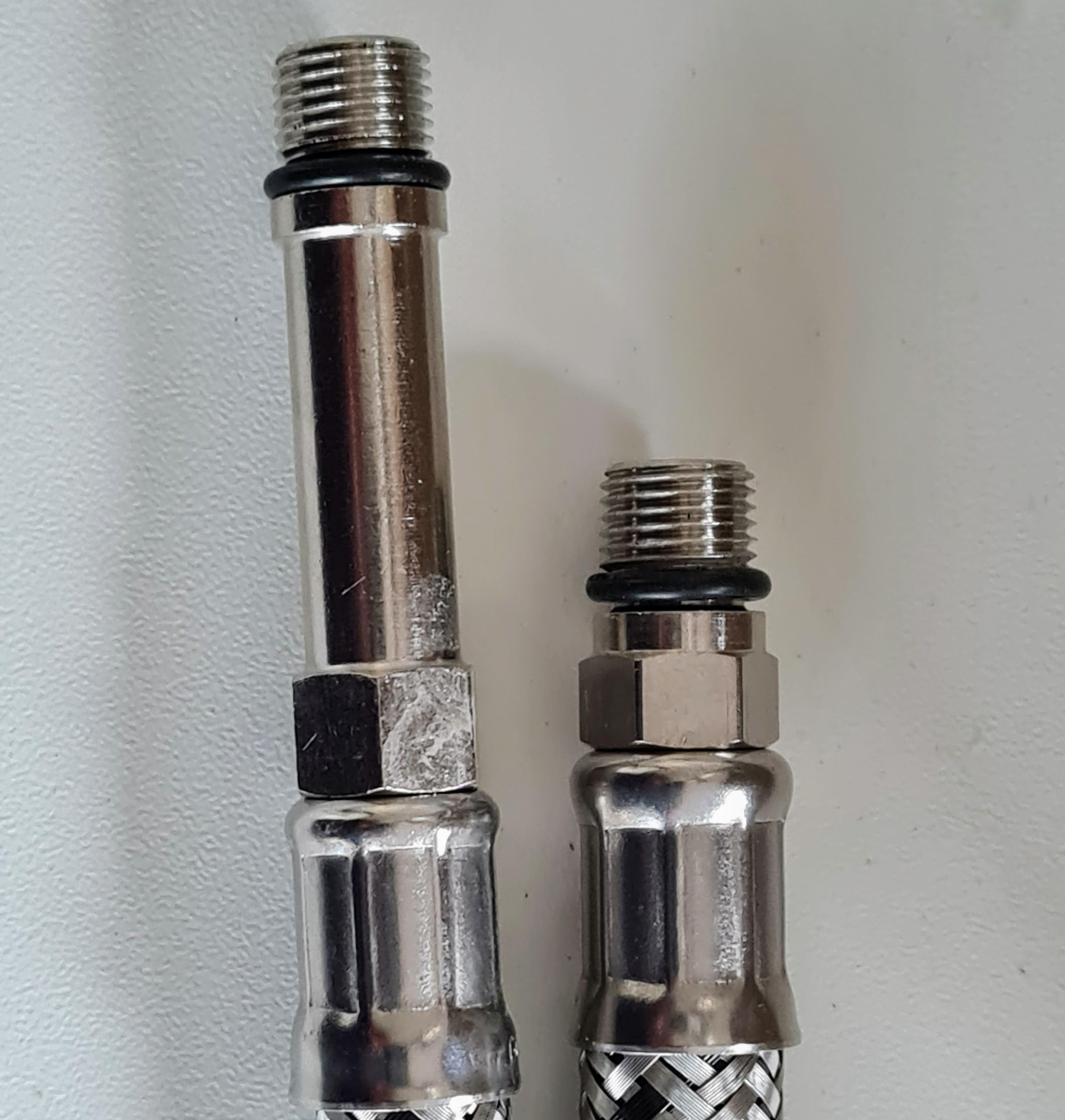

ToughButterCup Posted November 26, 2020 Share Posted November 26, 2020 Whassis about then eh? I mean just how much mind altering substance do you have to take to do this to an innocent tap connection , eh? Or: how to make the easy super, unecessarily hard. The monbloc tap , two innocent little holes... Choogle up to Screweez, and talk to the lass with the dry hacking cough and a sweat on ... (not jokin') : Could I have one of your finest PUSH-FIT FLEXIBLE MONOBLOC TAP CONNECTORS 15MM X M10MM please miss ..... (Oops, notice she's pregnant and has a highly polished sparkler on her ring finger ?) And she gives me this .... So, let me get this right. They give you one connector that's easy to tighten (left hand one because it sticks out of the bottom of the monobloc) and one which needs me to get a pair of tweezers to nudge the friggin' thing tight. Why FFS make the simple hard? Why Buildhub, why, and why me ? And don't tell me it's "Because yer 'ere lad" Please tell me I have missed the obvious. I'd be so pleased if that was the case. Please. Please. Link to comment Share on other sites More sharing options...
Declan52 Posted November 26, 2020 Share Posted November 26, 2020 They only go hand tight so just twist them to they stop. Link to comment Share on other sites More sharing options...
ProDave Posted November 26, 2020 Share Posted November 26, 2020 The flexi's that came with my basin tap don't even have a nut on them, the instructions say "finger tight" and they are not leaking. So don't over tighten them. Perhaps the idea is when you fit the first, short one, there is just enough room to get get a bent spanner in there to tighten it, then fit the second longer one. But AGREED it would be so much easier to either give you two long ones, or don't recess the bloody things up there in the first place. I am more curious how you clamp the tap into it's hole? There seems to be no normal tapped hole for a fixing stud? Link to comment Share on other sites More sharing options...

wozza Posted November 26, 2020 Share Posted November 26, 2020 Hand tight only, anymore than hand tight and you will compress the o ring too much and it will be squashed / forced out allowing water to leak. 1 Link to comment Share on other sites More sharing options...
