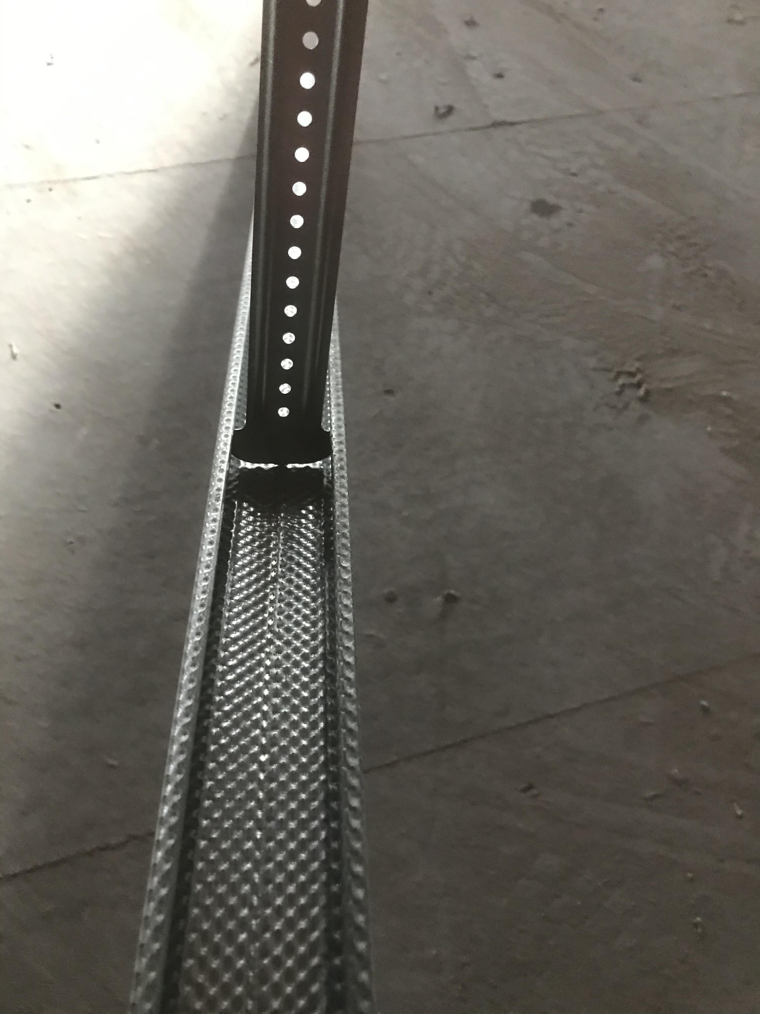

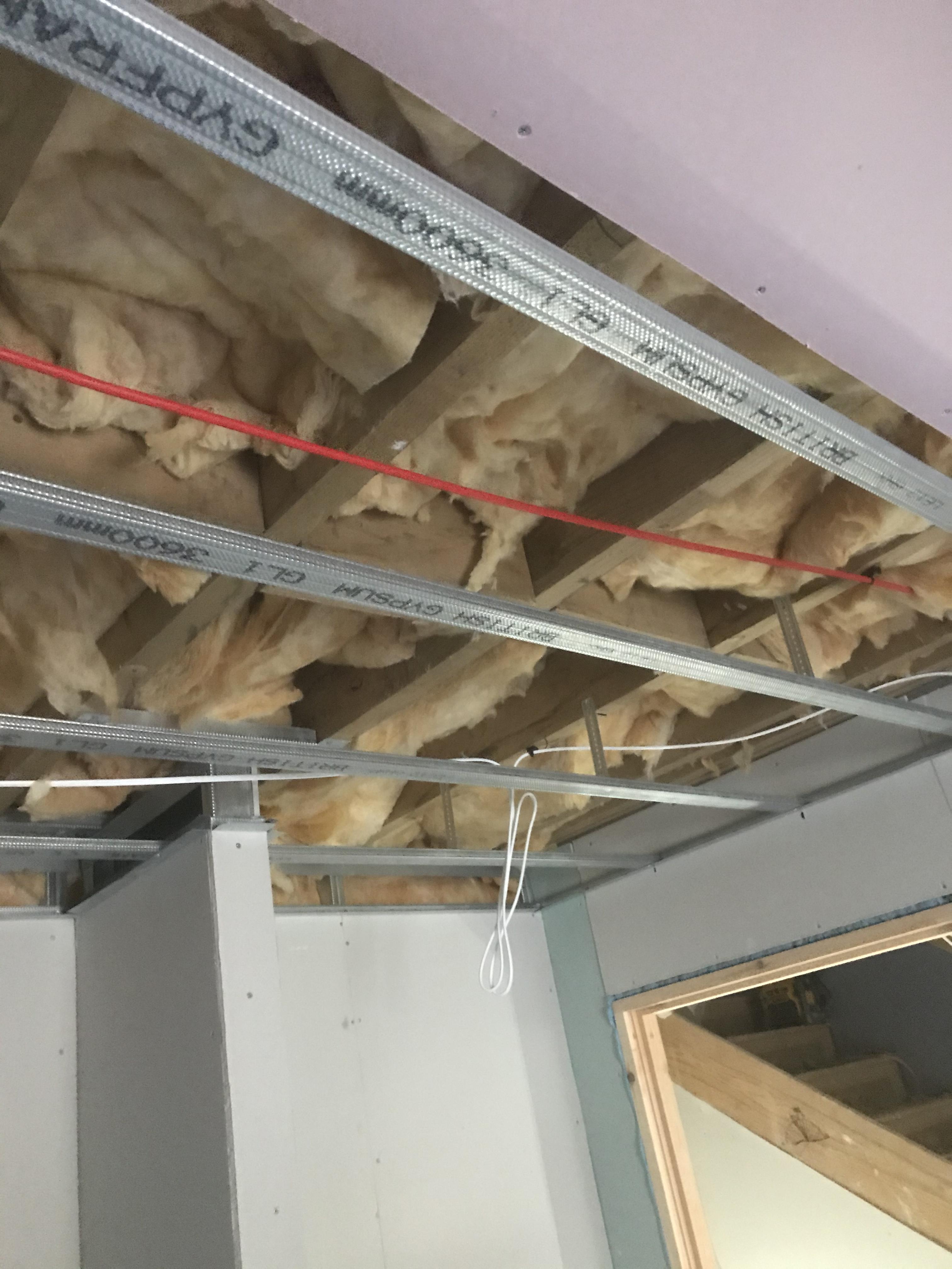

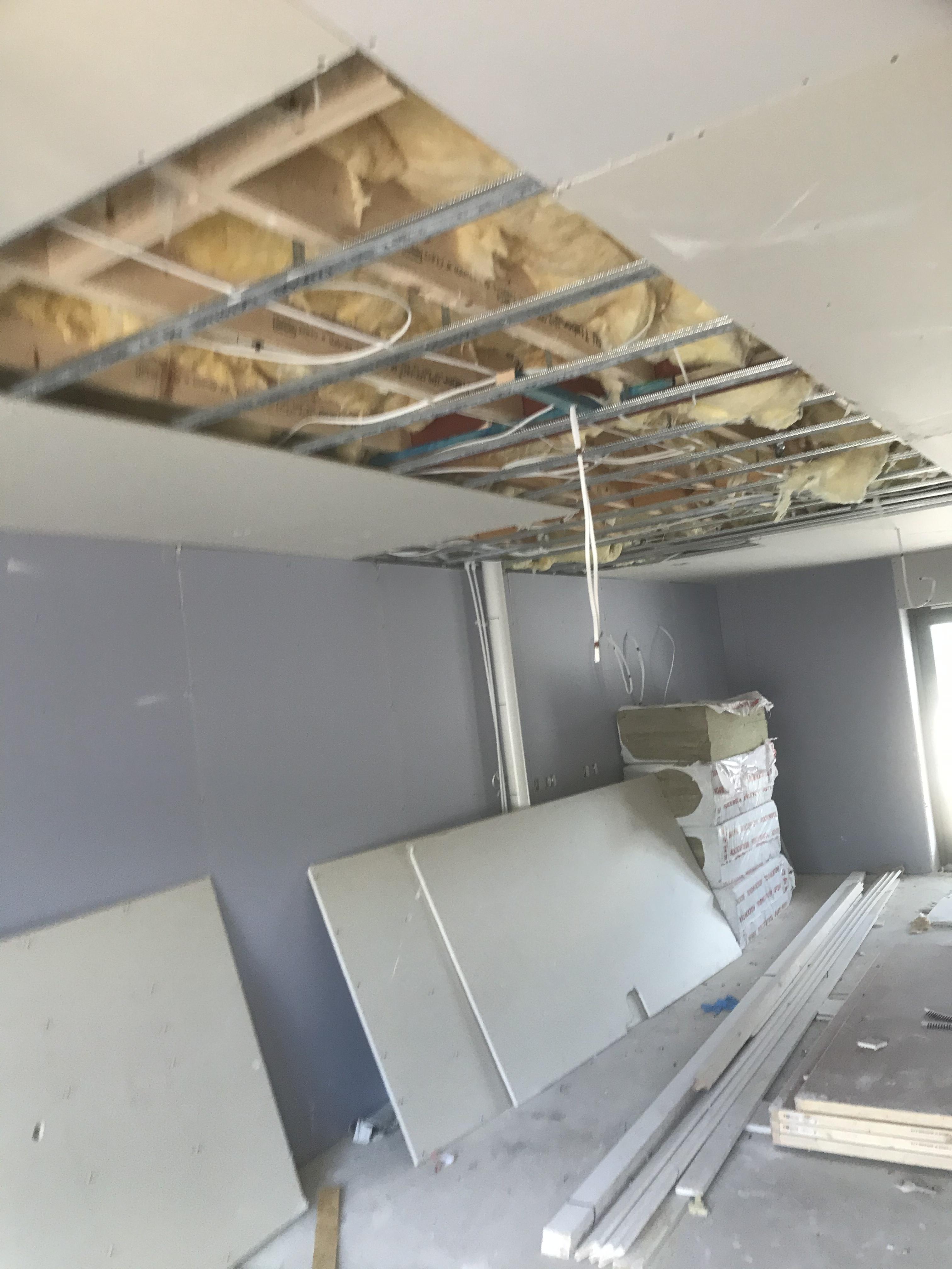

For the ceilings I’ve started using these as it out performs Res bar
26 minutes ago, Oz07 said:
@nod and his great camera again. What is it
My dusty work phone
Gypliner on click ceiling brackets Quick and easy to install Great acoustic performance
33 minutes ago, Oz07 said:
@nod and his great camera again. What is it?
They look like 70mm GAH2 hangers fixed to the joists.
Edit: looks like i was wrong
Edited by Moonshine
@nod
- Do you have a British Gypsum for system reference for the approach you are taking? Keen to take a look at the details..
- What did you do on top of joists/decking?
My dusty work phone
They are Gypliner ceiling brackets
On the floor is a 22 mil cabba deck Then we laid 50 mil acoustic slab Then 22 mil gyprock plank Acoustic sealing both around the perimeter
and finally laid a 22 mil TG chipboard floor glueing the joints only with a 10 mil expansion gap around the edge
It’s like walking on concrete

The  Gypliner on the underside of the floor with the joists packed with insulation Finished with 30 mil of sound block is plenty for a residential home
The properties we soundproofed to such a high standard where four story houses that had been built and stood for 12 years The banks had decided to convert them into flats selling at 250 k plus
