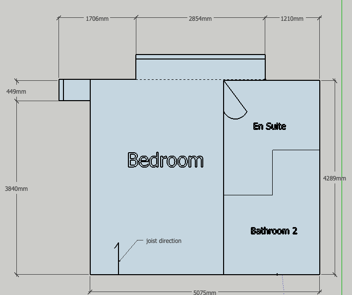

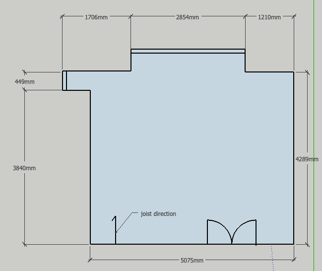

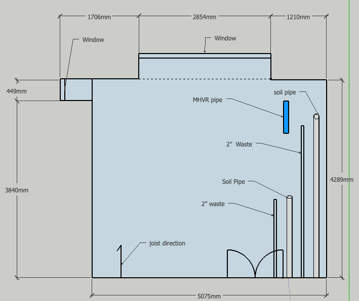

Kilt Posted November 20, 2020 Share Posted November 20, 2020 I have a SE plans for improving deflection of first floor joists, which is to cut joists, and insert an RSJ, sat on pad stones.. However due to services and punching through the timber kit to external stone work to build pad stones, the cost of work is significant, and will probably require a massive re-wire, as 80% of electrics run through the joists being cut. An alternative option by builder which is far less invasive (and thus cheaper), is under-slign an RSJ onto vertical steels, which are thunderbolt to the external timber kit walls (which will be beefed up). We have a screed floor with UFH, so digging down to foundations would be tricky (dangerous). The span is 5m The deflection is bad, however SE said the house isn't going to fall down. So any repair is purely to stop bounce, and level the 1st floor up, as it has also sagged. The repairs don't need to be structural, if that makes sense. I simply can't afford the SE's "invisible" option, as so many services would need to be cut/altered and I don't mind having the RSJs encroaching on the room, but I'm just putting it on here to get some thoughts. The bathrooms (above this room) have leaked 2-3 times with previous owners, as I have ripped out one of the bathroom and found evidence of the previous decor/mould. This has to be due to the deflection and movement. After it was built, the centre joists have sagged/settled by over 30mm, which will have caused some serious issues in a bathroom!!! Link to comment Share on other sites More sharing options...

joe90 Posted November 20, 2020 Share Posted November 20, 2020 Thinking out of the box, your first floor plans show bath 2 and en suite with a “ Stud wall?” To bedroom, can you not use steel rods up through that stud wall at intervals to “hang” the floor on and put steel in the loft! Link to comment Share on other sites More sharing options...

Kilt Posted November 20, 2020 Author Share Posted November 20, 2020 (edited) 33 minutes ago, joe90 said: Thinking out of the box, your first floor plans show bath 2 and en suite with a “ Stud wall?” To bedroom, can you not use steel rods up through that stud wall at intervals to “hang” the floor on and put steel in the loft! ha ha! I like your thinking. Maybe when we get a new roof? We'd prob need a 18m long steel in the roof to support the pulling up beam.. roof beams are 300 years old and riddled with woodworm, I worry then can handle my weight when I'm up there. Edited November 20, 2020 by Kilt Link to comment Share on other sites More sharing options...
