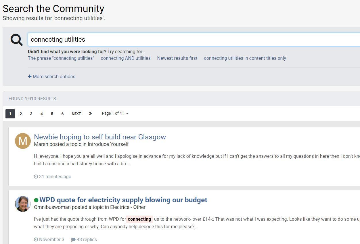

ToughButterCup Posted November 19, 2020 Share Posted November 19, 2020 27 minutes ago, Marsh said: ... What’s the most/least people have paid for connecting utilities? What sort of price are foundations for a 10m x 10m timber frame house? What timber frame companies can anyone recommend? How much usable floor space will I have upstairs in and one and a half storey with a downstairs 10m x 10m? Excluding the land is it unrealistic to think I can achieve my dream house for around 140-150k? Kit homes seem to be around 50-60k for wind and water tight so where does the rest of the budget go? (Naive question I know) ... You are very welcome indeed. Your first post I see, so you probably don't know how to use the site search engine: it's very powerful: lets take the first question: '... What’s the most/least people have paid for connecting utilities? ...' Take the key words : connecting utilities . Top right of every page > search copy and paste > connecting utilities - and this happens over 1000 results - too many Now play with the filters for example connecting AND utilities or in content titles only like I have linked to here There are more search options, some are extremely useful, others not so much. Your effort really will be repaid. There's very little that hasn't been covered before .... Go on, enjoy poking round Ian Link to comment Share on other sites More sharing options...
