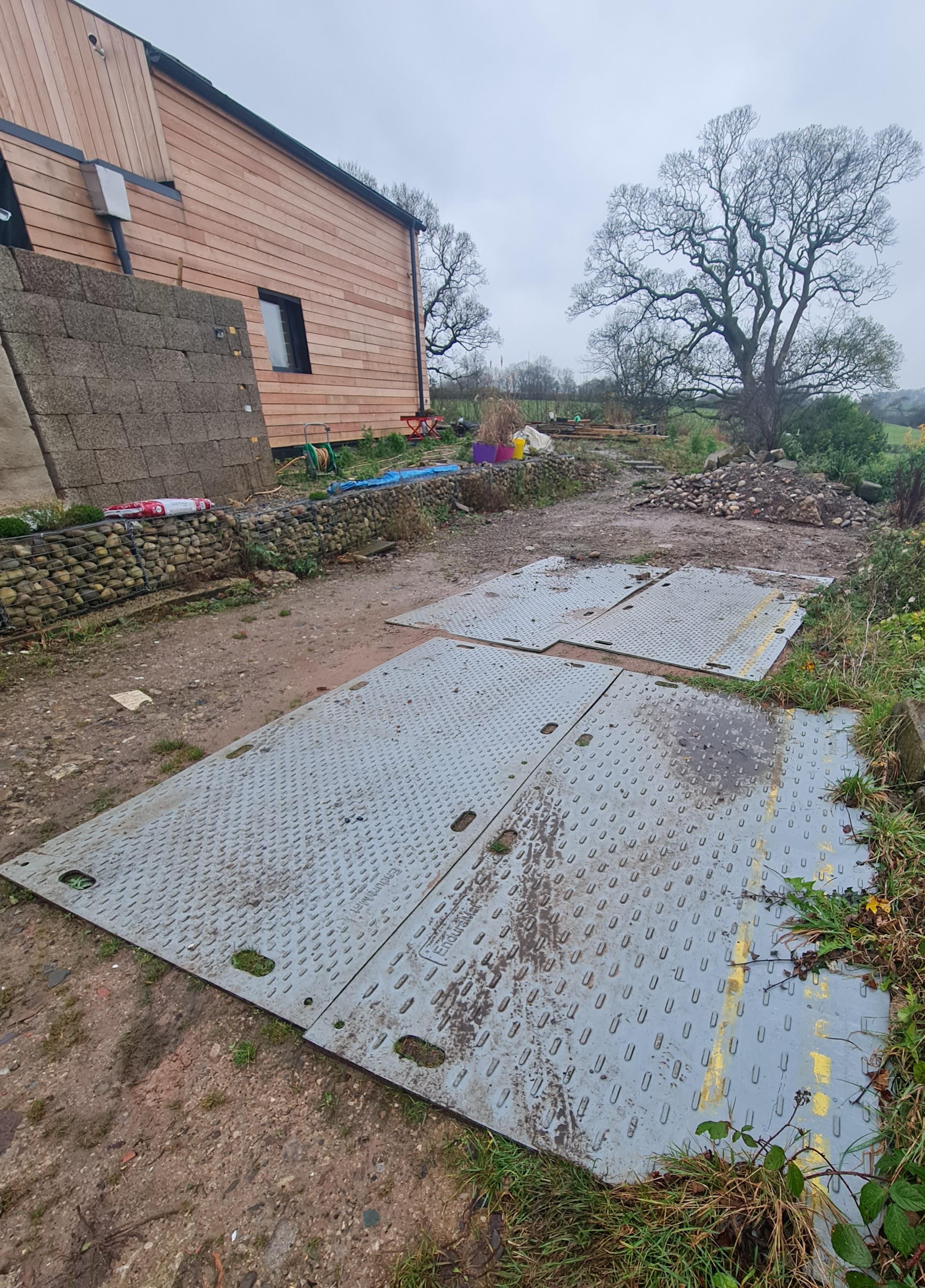

Jilly Posted November 19, 2020 Posted November 19, 2020 (edited) Can anyone recommend some kind of mud mats that aren't too expensive, please? The temporary entrance has been trashed. Events have conspired in that the builder underestimated how much spoil the piling contractor would leave, the rain came, the clay has done its stuff...everywhere. Edited November 19, 2020 by Jilly grammar

ToughButterCup Posted November 19, 2020 Posted November 19, 2020 Plastimatts or ground mats like these are maybe an idea.... We bought 10, over the years have smashed two, and we should get our money back on the other 8. Three or four visitors have commented on them - and every lorry driver does: on our mud , they are a godsend. Even better if you have a digger and can sling them to a bucket .... 1

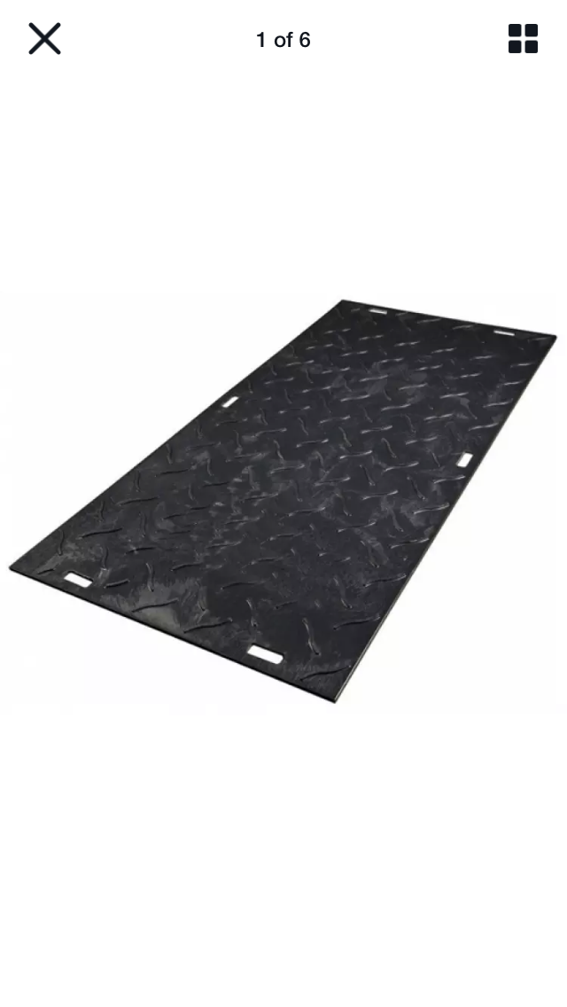

nod Posted November 19, 2020 Posted November 19, 2020 I have about a dozen of these While they are pricey They are virtually indestructible You can run a tracked machine or 20 ton lorry on them Just pressure wash them down when you no longer need them and put them on eBay for nearly what you have paid 1 1

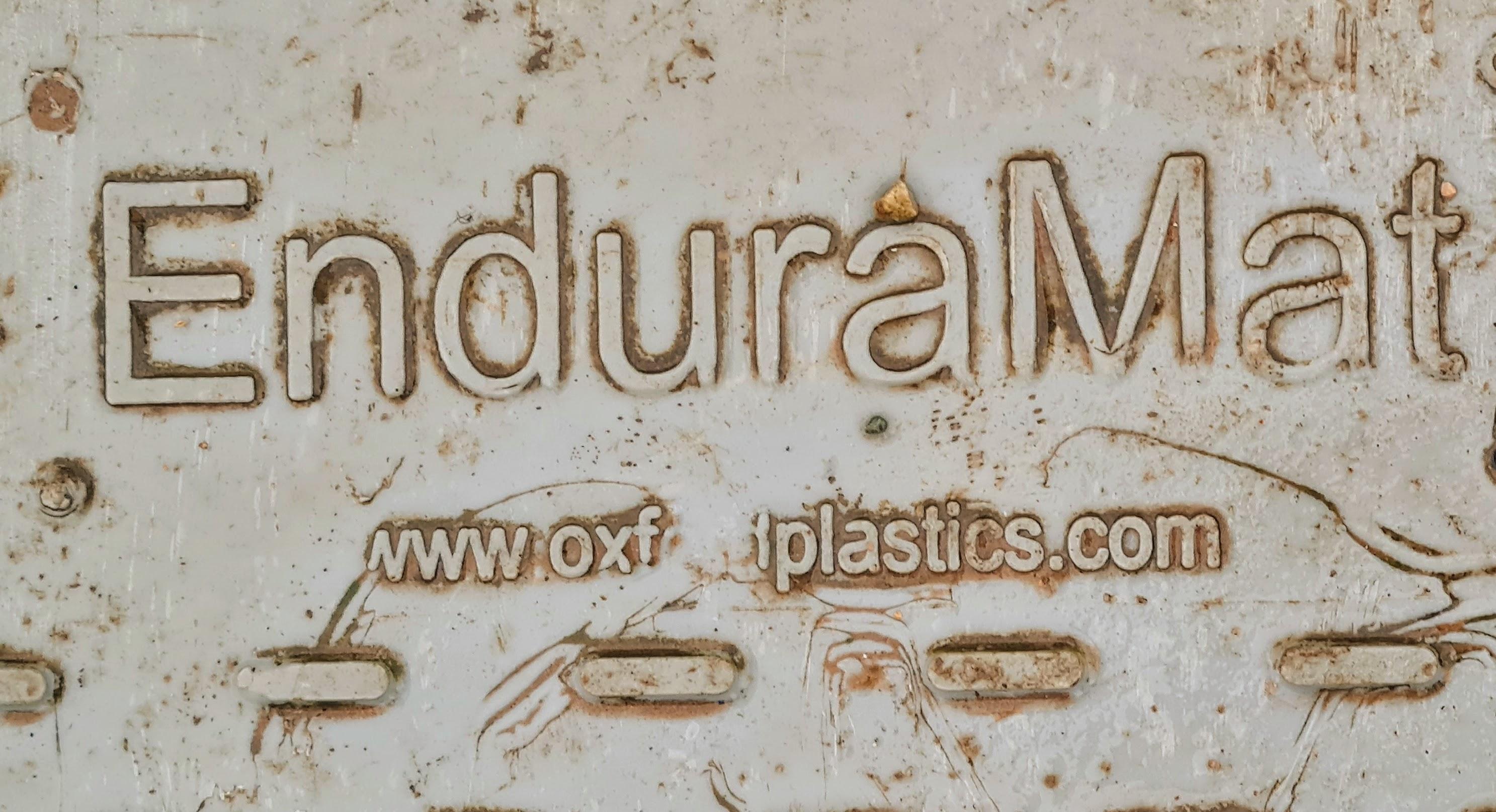

Jilly Posted November 19, 2020 Author Posted November 19, 2020 What are they called/what make are they, please?
ToughButterCup Posted November 20, 2020 Posted November 20, 2020 I'll pop out, have a look and get back to you .... 1
ToughButterCup Posted November 20, 2020 Posted November 20, 2020 (edited) Here you are .... 4 years in, no maintenance As Gary says ( @nod ) says they are pricey, but we'll re-sell them at about £80 or so. Won't get the VAT back, though. We (well, I ) smashed one by driving over it with a trailer that was loaded with a 3 tonne oak tree: the mat bridged some deep ruts which I had not filled in. Was a bit piddled off until a visitor told me that whenever he made the same error, he cut the mat up into appropriately sized chunks and used them as ersatz paving stones. There is no down-side to buy something like these mats: same logic as buying your own scaffolding. Pssst, wanna buy a few? ? Edited November 20, 2020 by ToughButterCup
