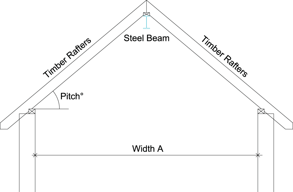

Temp Posted November 13, 2020 Posted November 13, 2020 (edited) On 12/11/2020 at 21:16, oldkettle said: Separately, I would like to have vaulted ceiling, ideally no joists. Is this technically possible? Feasible? Im sure you know that the issue that must be addressed is the weight of the roof pushing the walls out. This is normally achieved by triangulation/joists but another way is to use a structural ridge beam... This works by using a steel or possibly a large wood beam instead of the normal thin ridge board. The ends of the beam carry the majority of the weight of the roof so must rest on padstones in the gable walls or possibly on steel or large wood posts that go down to the foundations. If possible avoid having doors or windows in the gable walls as that can complicate things. The rafters should meet above the ridge beam and be connected together (perhaps with steel straps) so they effectively "hang" from the ridge beam. There are versions of this that use purlins to carry some of the load. These also reduce the unsupported span of the rafters and consequently their dimensions can be smaller. Lot depends on what the roof covering is going to be - tiles are much heavier than polycarbonate sheeting! https://www.beamcalculation.co.uk/start-calculation/steel-ridge-beam/ Edited November 13, 2020 by Temp 1
oldkettle Posted November 14, 2020 Author Posted November 14, 2020 1 hour ago, Temp said: Im sure you know that the issue that must be addressed is the weight of the roof pushing the walls out. This is normally achieved by triangulation/joists but another way is to use a structural ridge beam... This works by using a steel or possibly a large wood beam instead of the normal thin ridge board. The ends of the beam carry the majority of the weight of the roof so must rest on padstones in the gable walls or possibly on steel or large wood posts that go down to the foundations. If possible avoid having doors or windows in the gable walls as that can complicate things. The rafters should meet above the ridge beam and be connected together (perhaps with steel straps) so they effectively "hang" from the ridge beam. There are versions of this that use purlins to carry some of the load. These also reduce the unsupported span of the rafters and consequently their dimensions can be smaller. Lot depends on what the roof covering is going to be - tiles are much heavier than polycarbonate sheeting! https://www.beamcalculation.co.uk/start-calculation/steel-ridge-beam/ Thank you. This is exactly what I had in mind and the reason I mentioned glulam. With sips the load does not sound too bad. I am just trying to get an idea for what is possible: maybe 10m is indeed too much, maybe not.
