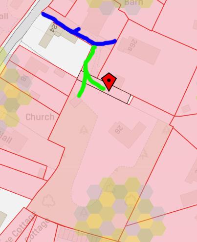

Mulberry View Posted November 10, 2020 Posted November 10, 2020 Our house is on a Private driveway currently used by 3 houses, we are the furthest of the 3 away from the road and our house has been on a Septic Tank since it was built in the 1950's. If we were to develop our plot, as is our intention, we had thought we'd put both the current house and the new build on modern treatment plants and we still might if its advantageous. However, the other 2 houses are connected to the sewer. The owner of the driveway suggested to me that he would be happy for us to connect to the sewer pipe that runs along his driveway. What stops us doing that and not even involving the local water board? Do these types of drainage connections have a capacity limit? Here's a diagram of what is there at the moment. The Blue shows the existing drain, serving 2 properties. The red arrow is the position of our Septic Tank (roughly), the green being the theoretical route for us to connect to the current drain, along with a further branch should we divide our plot. This question is not about the legal access rights that I know we'll need, just about the physical connection at this stage. .
Mulberry View Posted November 10, 2020 Author Posted November 10, 2020 Just now, tonyshouse said: Is it down hill? Yes.
Dave Jones Posted November 10, 2020 Posted November 10, 2020 snap his hand of now! Get a manhole connected to it on your land ASAP. A local builder could do it no problem. 1
Mulberry View Posted November 10, 2020 Author Posted November 10, 2020 Just now, Dave Jones said: snap his hand of now! Get a manhole connected to it on your land ASAP. A local builder could do it no problem. Could I just take advantage of his kind offer and run a pipe up to my driveway for now and potentially connect one or both properties to it at my leisure?
Dave Jones Posted November 10, 2020 Posted November 10, 2020 put a 300mm chamber on your land, the lowest in the ground possible to still give you fall then connect onto the pipe in the road. The materials will be less than £100+re-enstating the drive. A days work for a groundworker with a digger, done just that on our build. They dug down found the pipe in the lane, cut it and put a plastic 'T' with rubber boots to go from plastic to clay and filled it all back in. 25m run and they were done by lunchtime. https://www.wickes.co.uk/Wickes-Clay-to-Plastic-PVCu-Drain-Adaptor---Black-110mm/p/430042 As long as you dont have to go deep then a 300 chamber will suffice. https://www.screwfix.com/p/floplast-3-inlet-mini-access-chamber-base-black-300mm/18837 Dont call anyone just do it.
Mulberry View Posted November 10, 2020 Author Posted November 10, 2020 1 minute ago, Dave Jones said: put a 300mm chamber on your land, the lowest in the ground possible to still give you fall then connect onto the pipe in the road. The materials will be less than £100+re-enstating the drive. A days work for a groundworker with a digger, done just that on our build. They dug down found the pipe in the lane, cut it and put a plastic 'T' with rubber boots to go from plastic to clay and filled it all back in. 25m run and they were done by lunchtime. https://www.wickes.co.uk/Wickes-Clay-to-Plastic-PVCu-Drain-Adaptor---Black-110mm/p/430042 As long as you dont have to go deep then a 300 chamber will suffice. https://www.screwfix.com/p/floplast-3-inlet-mini-access-chamber-base-black-300mm/18837 Dont call anyone just do it. Excellent. The good thing here is that everything is downhill, even the theoretical pipe we'd need to serve the new build, so the chamber wouldn't have to be particularly deep. I can see a slight risk that we might need to use a 'backdrop' connection as it's a little steep as it approaches where it would connect to the 'Blue'. Thanks.
Dave Jones Posted November 10, 2020 Posted November 10, 2020 the point is, you want the chamber on your land to be as deep as possible while still giving fall, this way you have maximum flexibility for your plot. For example if you need a long run from the back of the house to the chamber, if its shallow you may run out of fall. Work on 13mm of fall per M as a minimum. 1
Mulberry View Posted November 10, 2020 Author Posted November 10, 2020 27 minutes ago, Dave Jones said: the point is, you want the chamber on your land to be as deep as possible while still giving fall, this way you have maximum flexibility for your plot. For example if you need a long run from the back of the house to the chamber, if its shallow you may run out of fall. Work on 13mm of fall per M as a minimum. There's no doubt about it, the distance from our desired build position to the place we'd put this initial manhole is significant. In fact, if you refer to the above diagram, we're hoping to build in the South-East corner. With the issue of fall aside (I'll need to investigate that), should I be concerned about a drainage run this long for any other reason? For proportion, the whole plot is about an acre, so I guess the run from the new build to the manhole might be 70m!
Dave Jones Posted November 10, 2020 Posted November 10, 2020 is where your planning to put the house higher or lower than where the chamber to the road will be ? If its lower by 13mm/M to the farthest point on your build then away you go. If its not then you have a pumped chamber, add a few more quid to the build. Either case infinitely better for you and the valuation than being on a stink tank.
