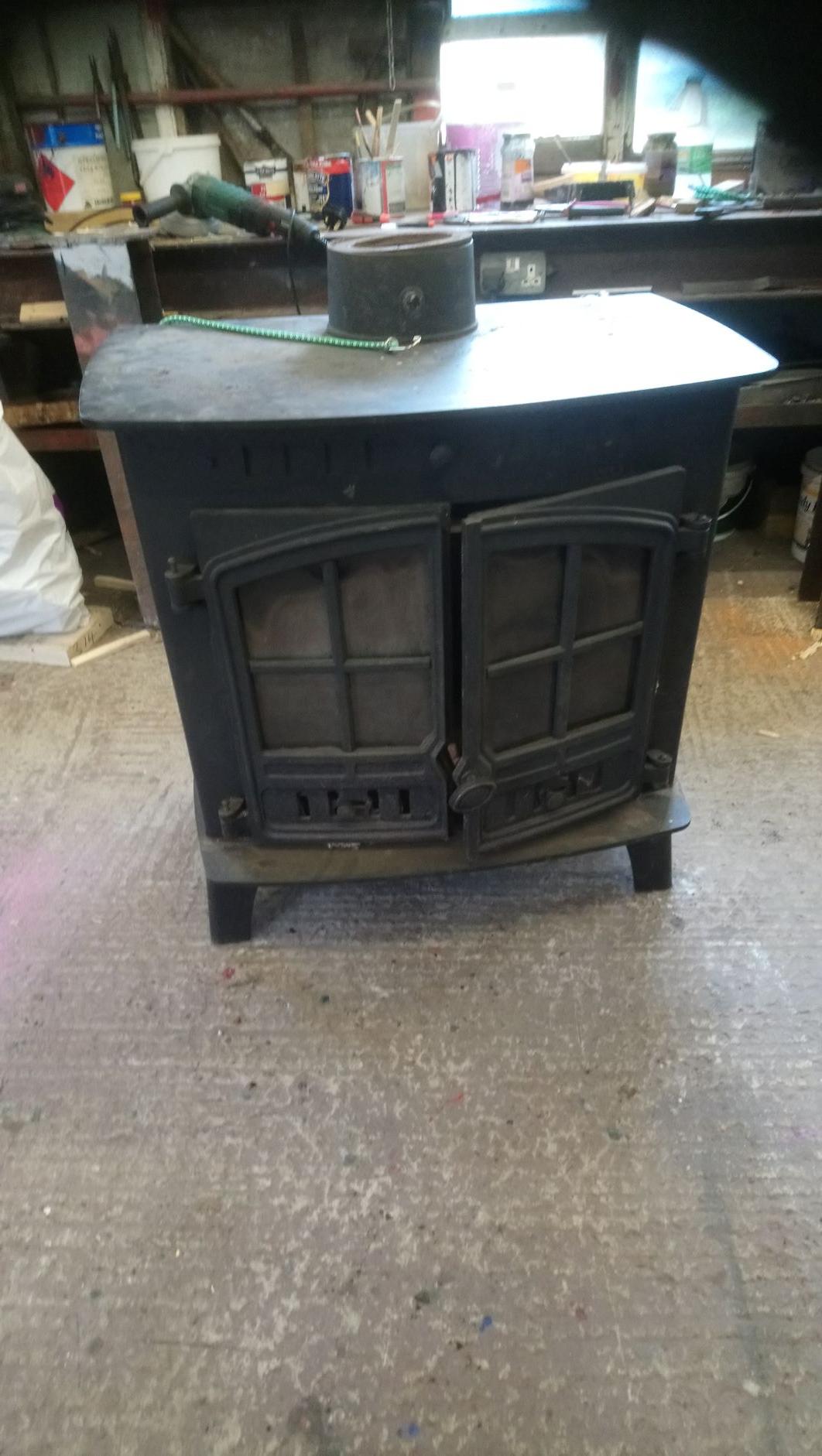

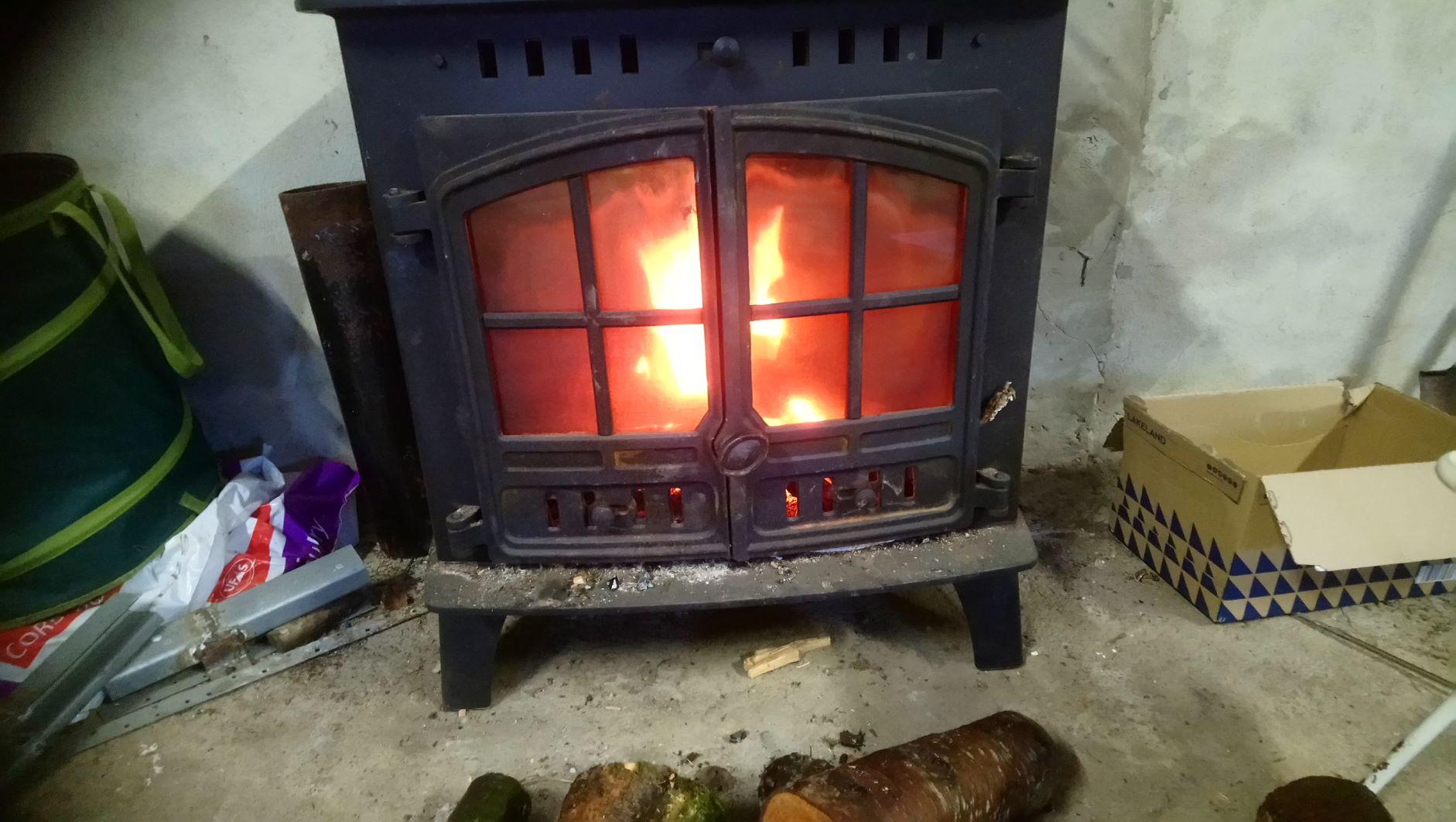

Shedstove Posted October 18, 2020 Share Posted October 18, 2020 Hi! I'm creating a Covid refuge in my shed, and would greatly appreciate advice on my wood burner. (See photo) I've installed thai big heavy wood stove but to my surprise this stove has no maker's name or plate attached. So I can't find out how to check if I need spares - esp. if it needs baffles or fire bricks (neither of which it has at the moment). With a straight up flue it's working OK would baffles and firebricks make it better? I would dearly like to know the make. Thanks. Link to comment Share on other sites More sharing options...
ProDave Posted October 18, 2020 Share Posted October 18, 2020 Where did you get it? There should be some form of baffles, not just a hole in the top going straight up to the flue. Even the ultra cheap Chinese stove we fitted into our static caravan had cast iron baffles and it worked well, though no doubt not the most efficient. Link to comment Share on other sites More sharing options...
Russell griffiths Posted October 18, 2020 Share Posted October 18, 2020 Any fire bricks will fit, just trim to size with a grinder, I did mine last year. Link to comment Share on other sites More sharing options...
Shedstove Posted October 25, 2020 Author Share Posted October 25, 2020 Thanks for the replies..However I am still no closer to finding the make of the stove! Link to comment Share on other sites More sharing options...
bassanclan Posted October 26, 2020 Share Posted October 26, 2020 It looks like a Herald Hunter https://www.stovesareus.co.uk/hunter-herald-8-woodburning-stove.html They do a number of sizes etc so a quick measure up may help Link to comment Share on other sites More sharing options...
