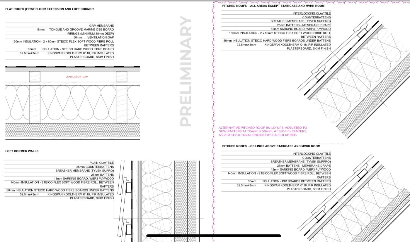

Just to update everyone on where I am with this:
we are installing 40mm Kooltherm K5 Phenolic Foam EWI on ALL the old external walls.
Internally, we are not insulating the ground floor walls because we are advised that this would increase our risk of interstitial condensation for our specific situation.
At first floor we are using insulated plasterboard though, which contains 35mm of PIR, on the walls.

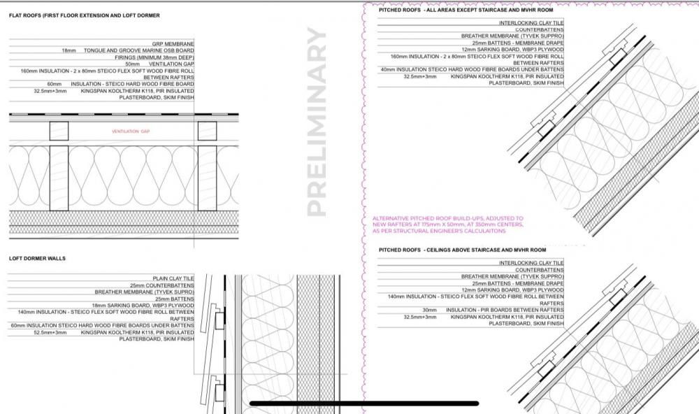

at second floor (loft) we are using wood fibre mainly, to bolster decrement delay. See attached build up which shows all second floor build ups:
 All windows are double glazed with no bridging between internal and external aluminium frames. They have an energy efficiency of A+, whatever that means.
 Still can’t decide whether I need heating in the loft and what type.
So any comments on my walls and roof build up and the conundrum as to what heating system to have up there, if at all...?
What is your plan for a vapour control layer in the above buildups?
I note the membrane is floating between the batten and counter batten in all cases. Why here and not below the counter-batten?
https://www.dupont.co.uk/products/tyvek-supro.html it is vapour permeable, breathable and water resistant
No idea I'm afraid. My architect designed it, I then asked him to run it by a RICS surveyor who designs these sorts of things and he made some tweaks and this is the end product. Couldn't tell you which way is the right or the wrong way to do these things. Why do you think having the membrane floating between the batten and counter batten is wrong?
That's your external moisture barrier.
 At the moment the moisture from the house can escape between the joints in the kooltherm into the roof and get trapped in there by the sarking which is cold and cause condensation.
Carefully taping the joints in the kooltherm should help,
No it's an approved detail for permeable roof coverings. In my opinion the membrane is more likely to rip and you'll need to make sure that the builders leave the correct droop under the battens. I'd put it under the counter-battens personally.
Thank for reminding me about this. It is a spec that the surveyor recommended, just the architect forgot to include it on his drawings.
