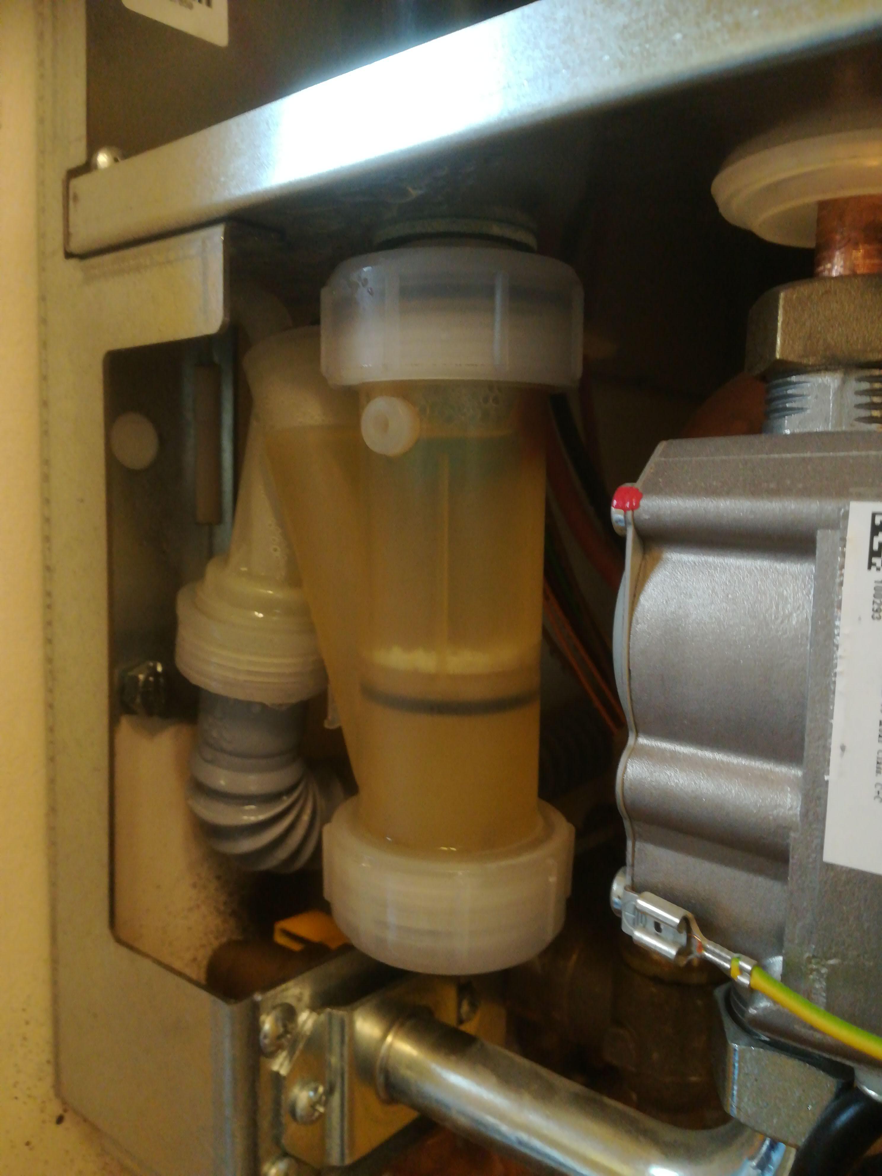

Big Jimbo Posted October 12, 2020 Posted October 12, 2020 Morning gang. Should the condensate on my daughters boiler look like this. I took it off a couple of weeks ago, and cleaned it out. The ball was very sticky. Is it right that the ball should be right at the top, and the condensate trap full of fluid?
Gav_P Posted October 12, 2020 Posted October 12, 2020 I assume it needs water to make sure nasty gasses don’t escape. .. No idea how ‘full’ it’s supposed to be tho. Have you checked that the pipe is free flowing? I.e. the condensate can go somewhere.
Big Jimbo Posted October 12, 2020 Author Posted October 12, 2020 Yep. Free flowing into the toilet cistern.
markc Posted October 12, 2020 Posted October 12, 2020 It should remain full, the excess is discharged via the vent pipe. They do getr gummed up with sediment and gunk that needs cleaning out occasionally 2
