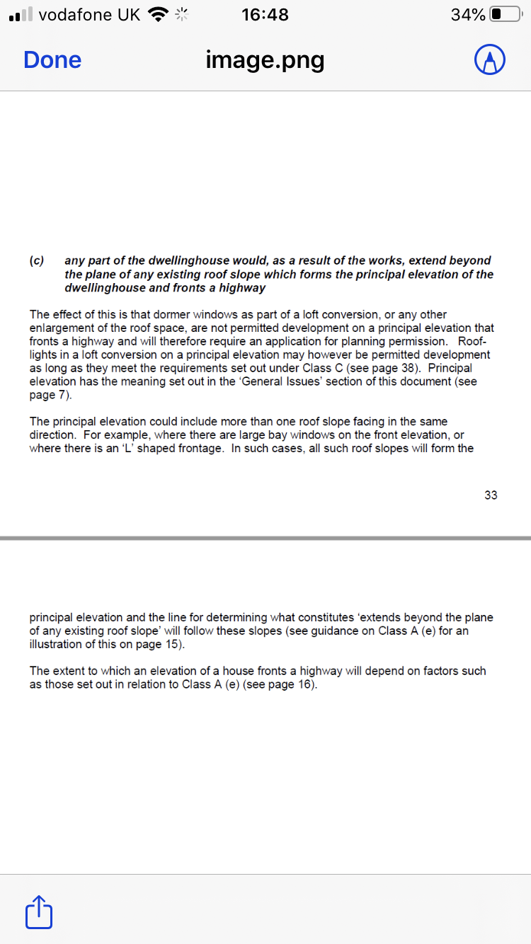

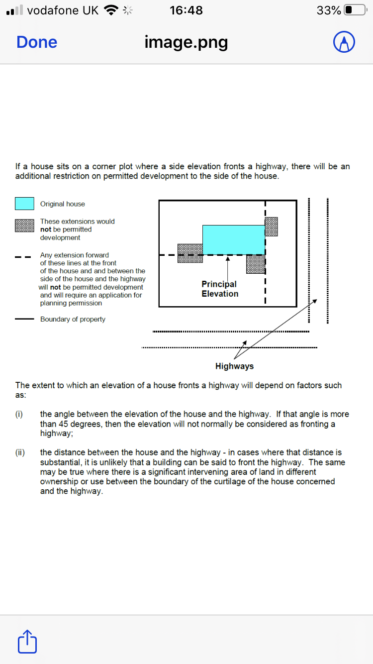

Cresswelle Posted October 6, 2020 Share Posted October 6, 2020 Hi all. Just after some advice pls and opinions. We are in the process of planning a hip to gable loft extension with dormer and am getting conflicting advice if planning permission is needed. We live on a corner plot and the architect we have gone with advised that we don’t need planning but has advised to get a certificate of lawful development anyway. His initial advice was that planning was needed but when checking the guidance changed his mind. “As per my voicemail this morning, I mis-advised you yesterday; having checked the technical guidance of the permitted development rules, the side dormer or hip to gable conversion does not need planning permission - only extensions beyond the plane of a roof on the principal elevation require planning. That's different for ground/first floor extensions however, hence my initial advice. I always encourage my clients to obtain a 'Certificate of Lawful Development' even where planning is not required as that gives you proof in future that the works were carried out lawfully” We had a different architect do drawings for our extension and had him also quote for the loft but he was very expensive so didn’t go with him for the loft. He’s doing some amendments to our current side extension but has just said that we need planning permission if we go ahead with the loft and sent me this. We’ve literally just submitted the app for the certificate and tbh I’ll be pretty fed up if we need planning but who is right? I don’t fancy getting 6 weeks down the line to be told we need planning after all. thanks Link to comment Share on other sites More sharing options...

DevilDamo Posted October 6, 2020 Share Posted October 6, 2020 Even though it is a corner plot in which two elevations front a highway, the main/principal elevation would be that to the front as per... “in most cases the principal elevation will be that part of the house which fronts (directly or at an angle) the main highway serving the house (the main highway will be the one that sets the postcode for the house concerned). It will usually contain the main architectural features such as main bay windows or a porch serving the main entrance to the house. Usually, but not exclusively, the principal elevation will be what is understood to be the front of the house. There will only be one principal elevation on a house. Where there are two elevations which may have the character of a principal elevation, for example on a corner plot, a view will need to be taken as to which of these forms the principal elevation.” 1 Link to comment Share on other sites More sharing options...
Cresswelle Posted October 6, 2020 Author Share Posted October 6, 2020 1 hour ago, DevilDamo said: Even though it is a corner plot in which two elevations front a highway, the main/principal elevation would be that to the front as per... “in most cases the principal elevation will be that part of the house which fronts (directly or at an angle) the main highway serving the house (the main highway will be the one that sets the postcode for the house concerned). It will usually contain the main architectural features such as main bay windows or a porch serving the main entrance to the house. Usually, but not exclusively, the principal elevation will be what is understood to be the front of the house. There will only be one principal elevation on a house. Where there are two elevations which may have the character of a principal elevation, for example on a corner plot, a view will need to be taken as to which of these forms the principal elevation.” Thanks. That’s how I interpret the rules. I’m keeping everything crossed Link to comment Share on other sites More sharing options...
Ferdinand Posted October 7, 2020 Share Posted October 7, 2020 14 hours ago, DevilDamo said: Even though it is a corner plot in which two elevations front a highway, the main/principal elevation would be that to the front as per... “in most cases the principal elevation will be that part of the house which fronts (directly or at an angle) the main highway serving the house (the main highway will be the one that sets the postcode for the house concerned). It will usually contain the main architectural features such as main bay windows or a porch serving the main entrance to the house. Usually, but not exclusively, the principal elevation will be what is understood to be the front of the house. There will only be one principal elevation on a house. Where there are two elevations which may have the character of a principal elevation, for example on a corner plot, a view will need to be taken as to which of these forms the principal elevation.” Can I have a reference for that .. I thought it was different to that and it is good to hear. F Link to comment Share on other sites More sharing options...
DevilDamo Posted October 7, 2020 Share Posted October 7, 2020 (edited) Bottom of Page 7... https://assets.publishing.service.gov.uk/government/uploads/system/uploads/attachment_data/file/830643/190910_Tech_Guide_for_publishing.pdf ? Edited October 7, 2020 by DevilDamo 1 Link to comment Share on other sites More sharing options...
