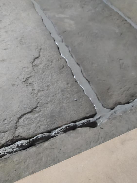

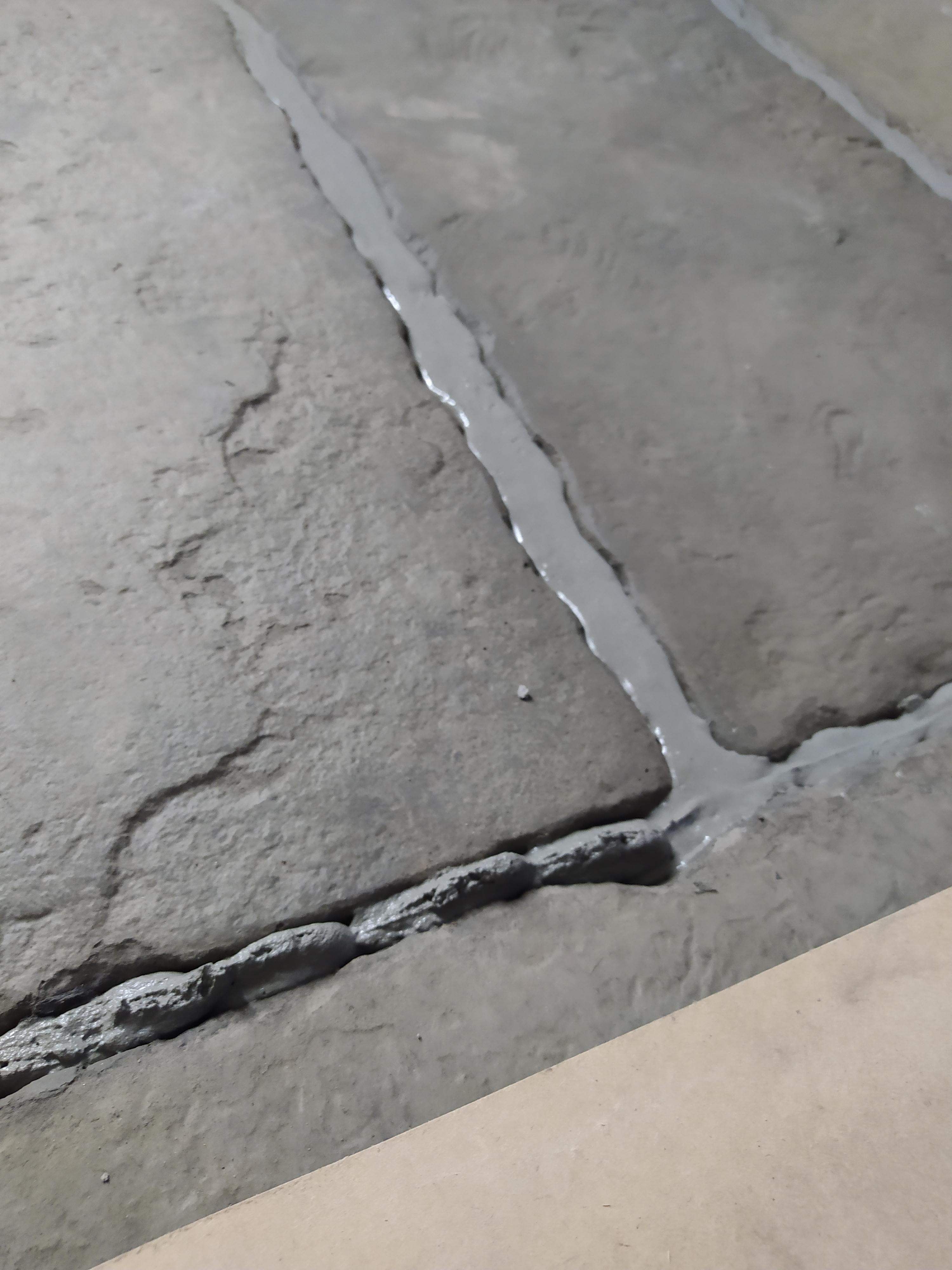

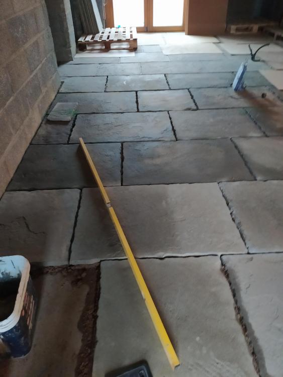

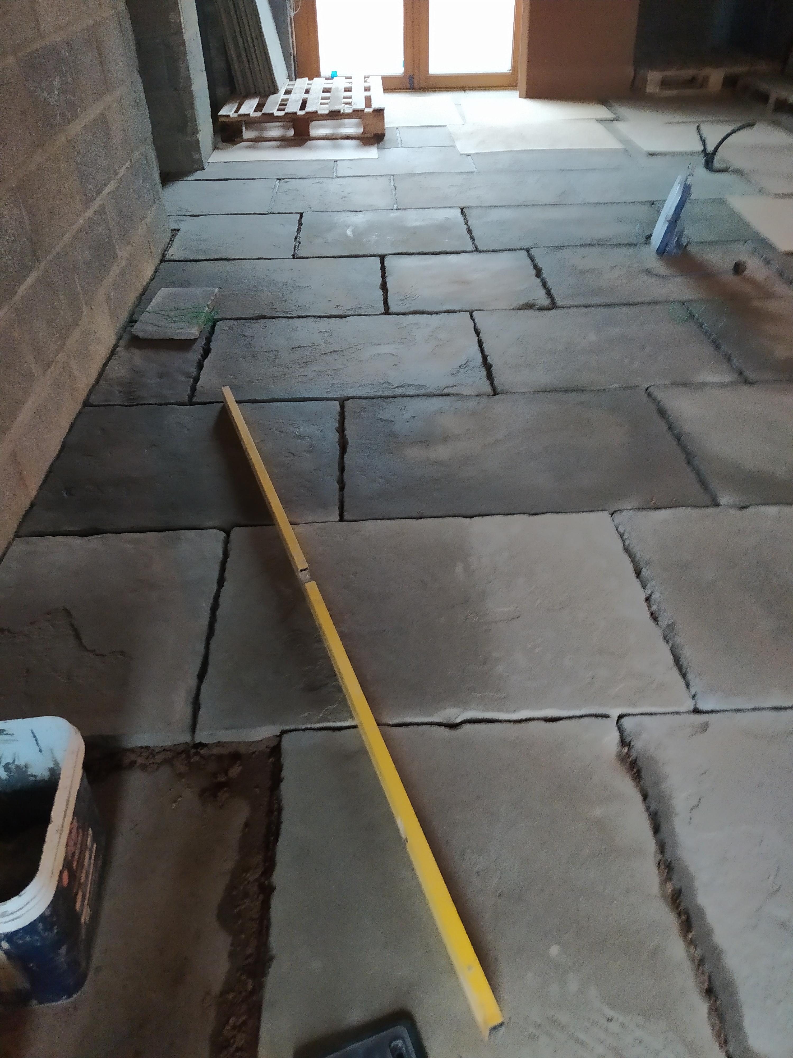

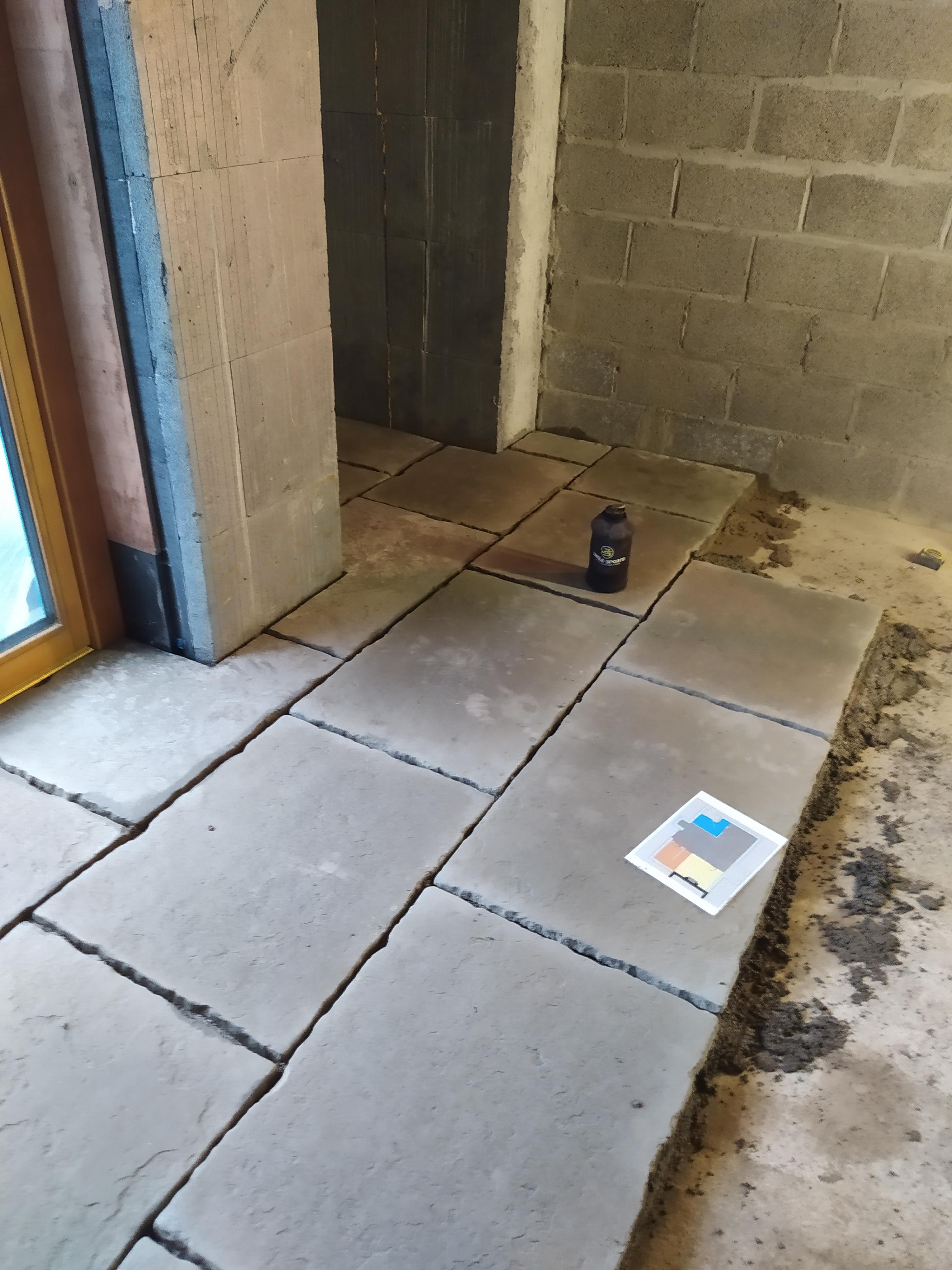

willbish Posted December 29, 2020 Author Share Posted December 29, 2020 On 04/10/2020 at 21:00, Nickfromwales said: Hope your back is in good condition, as that's a lot of mixing, hand-balling and levelling. Pics too please!! Finished.... Didn't make the Christmas deadline or do it without some help so I can't take all the credit. On 04/10/2020 at 23:24, Mr Punter said: Hopefully not too many cuts to do. It wasn't the cuts that got me but the grouting. I nearly walked off my own site vowing never to return during that job! 3 1 Link to comment Share on other sites More sharing options...
Mr Punter Posted December 29, 2020 Share Posted December 29, 2020 Great job. If you were to price this to do for someone else, how much would you charge per metre? Link to comment Share on other sites More sharing options...
willbish Posted December 29, 2020 Author Share Posted December 29, 2020 11 minutes ago, Mr Punter said: Great job. If you were to price this to do for someone else, how much would you charge per metre? Good question Just did a rough calculation which came out at £25/m, labour only. Seems too cheap! Link to comment Share on other sites More sharing options...
Nickfromwales Posted December 29, 2020 Share Posted December 29, 2020 1 hour ago, willbish said: Good question Just did a rough calculation which came out at £25/m, labour only. Seems too cheap! To lay and grout that, including logistics, would be in triple digits for me. Cracking job on the grouting btw, and yup, a labour of love that is. 1 Link to comment Share on other sites More sharing options...
