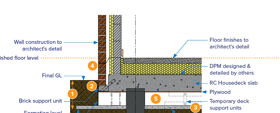

Reetster Posted September 23, 2020 Share Posted September 23, 2020 All ideas welcome I am progressing a barn conversion with the wall structure as follows. Timber framed house built on 300mm reinforced slab (450mm toe) within the footprint of a 28m x 9m existing timber barn, Posts of existing barn sits on existing separate pad foundation, so in effect we are building a house within the barn. Wall construction to be (from inside out) Plasterboard, 150mm insulated frame, 12mm ply, felt, secondary skin in between posts of barn - 100mm frame sitting on a brick plinth, which will have more insulation, ply, felt then batten ready for cladding. The problem we are having is what to sit the brick plinth on. To put in a small strip foundation we will need to underpin the existing barn pads, which are very deep. There has also been talk of using brick slips mounted to the existing new build frame, but Im now overly excited by this. Is there a way we can drill into the new reinforced slab, in between each bay (about 4.3m) to support some sort of steel or lintel on which we can build our plinth, and then 2nd skin wall above? Understandably, building regs don’t want to put any additional weight onto the existing original timber posts Any ideas welcome Link to comment Share on other sites More sharing options...
Mr Punter Posted September 23, 2020 Share Posted September 23, 2020 Firstly, a drawing would be useful. I have had a reinforced slab with a stainless steel angle cast into the edge to build brickwork off. Would that work for you? It was done by Abbey Pynford. I am not sure if they would supply the brick support separately. Link to comment Share on other sites More sharing options...
Reetster Posted September 23, 2020 Author Share Posted September 23, 2020 Thanks Don't have a drawing, but will get a sketch down. Slab is already cast so to use a system such as this we would need to drill into it. An piece of angle steel would work in theory though. Cheers Link to comment Share on other sites More sharing options...
Mr Punter Posted September 23, 2020 Share Posted September 23, 2020 There are a few masonry support system suppliers out there like https://acsstainless.co.uk/product/type-1-fixed-back-to-concrete/ I think they are expensive though! Link to comment Share on other sites More sharing options...
Reetster Posted September 23, 2020 Author Share Posted September 23, 2020 Thats what I need, thank you Now to investigate costs Thanks again Link to comment Share on other sites More sharing options...
