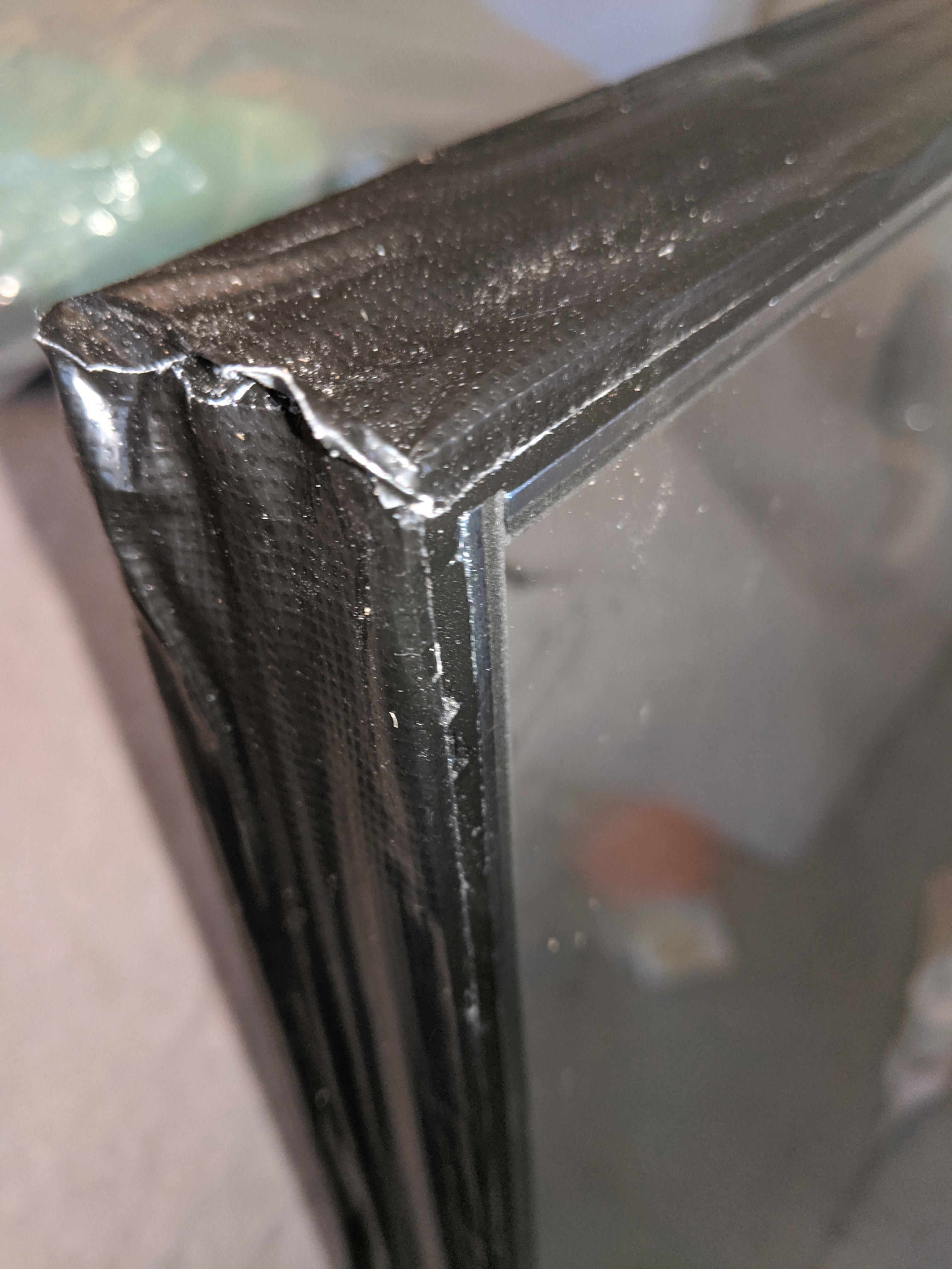

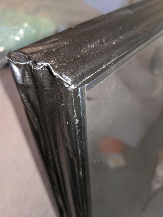

Crofter Posted September 15, 2020 Posted September 15, 2020 After seven years I have finally started replacing my ancient single glazed windows. The new uPVC units arrived and my measurements seem to be OK, so far, which was my biggest worry. The sealed units have what appears to be duct tape around the outside. I am 99.99% sure that this is just for protection in transit and it should come off. But it's stuck really, really well. To the point where I'm having a tiny bit of doubt about whether to remove it, since it seems to want to pull strong black gloop off the edge of the sealed unit itself. Can anybody reassure me that I should just crack on and rip the tape off? I should probably do the sensible thing, down tools and phone the supplier in the morning, but the old window is already out and SWMBO would rather not have a gaping hole in the wall overnight!
nod Posted September 15, 2020 Posted September 15, 2020 17 minutes ago, Crofter said: After seven years I have finally started replacing my ancient single glazed windows. The new uPVC units arrived and my measurements seem to be OK, so far, which was my biggest worry. The sealed units have what appears to be duct tape around the outside. I am 99.99% sure that this is just for protection in transit and it should come off. But it's stuck really, really well. To the point where I'm having a tiny bit of doubt about whether to remove it, since it seems to want to pull strong black gloop off the edge of the sealed unit itself. Can anybody reassure me that I should just crack on and rip the tape off? I should probably do the sensible thing, down tools and phone the supplier in the morning, but the old window is already out and SWMBO would rather not have a gaping hole in the wall overnight! They normally do have tape around the edge If it’s not visible when the bead go on it would be worth leaving it on Picture would help
PeterW Posted September 15, 2020 Posted September 15, 2020 27 minutes ago, Crofter said: After seven years I have finally started replacing my ancient single glazed windows. The new uPVC units arrived and my measurements seem to be OK, so far, which was my biggest worry. The sealed units have what appears to be duct tape around the outside. I am 99.99% sure that this is just for protection in transit and it should come off. But it's stuck really, really well. To the point where I'm having a tiny bit of doubt about whether to remove it, since it seems to want to pull strong black gloop off the edge of the sealed unit itself. Can anybody reassure me that I should just crack on and rip the tape off? I should probably do the sensible thing, down tools and phone the supplier in the morning, but the old window is already out and SWMBO would rather not have a gaping hole in the wall overnight! That is gas sealing tape - it needs to stay on !!
Crofter Posted September 15, 2020 Author Posted September 15, 2020 It will certainly not be visible after the beads go on, but it looks exactly like bog standard duct tape, and it's not especially neat. Hence my first impression that it was just there for packaging...
PeterW Posted September 15, 2020 Posted September 15, 2020 Stays on and also protects the glass edges too 1
Crofter Posted September 15, 2020 Author Posted September 15, 2020 13 minutes ago, PeterW said: Stays on and also protects the glass edges too Thanks. There goes my night off... ?
nod Posted September 15, 2020 Posted September 15, 2020 22 minutes ago, Crofter said: It will certainly not be visible after the beads go on, but it looks exactly like bog standard duct tape, and it's not especially neat. Hence my first impression that it was just there for packaging... Leave it on and fit
Nick Posted September 15, 2020 Posted September 15, 2020 It is just normal cloth/gaffer/duct tape. It's there for handling reasons / edge protection and isn't part of the primary or secondary seal. Technically you are advised to remove it before installing the sealed unit. In reality everyone always leaves it on as removing it is a pain and it does no observable harm.
PeterW Posted September 15, 2020 Posted September 15, 2020 2 minutes ago, Nick said: Technically you are advised to remove it before installing the sealed unit. Really..? Never seen that on any install guidance and know a lot of Fensa fitters who have never removed it ..? I was advised it was there to protect the gas seals from damage.
Nick Posted September 15, 2020 Posted September 15, 2020 11 minutes ago, PeterW said: Really..? Never seen that on any install guidance and know a lot of Fensa fitters who have never removed it ..? I was advised it was there to protect the gas seals from damage. Wouldn't bother Fensa as it's not really a building regs issue. Would be GGF guidance or locked away in a British Standard somewhere. Will see if I can locate it.
craig Posted September 15, 2020 Posted September 15, 2020 (edited) The tape is purely for handling purposes, it does nothing other than protect during handling. It is not an air seal or anything like that. It’s a pain to remove but it’s not needed and can be the cause of unit failure if left on. I should add that some types of glazing silicon can react with the hotmelt which is why people leave it on as well. Edited September 15, 2020 by craig
Nick Posted September 15, 2020 Posted September 15, 2020 18 minutes ago, PeterW said: Really..? Never seen that on any install guidance and know a lot of Fensa fitters who have never removed it ..? I was advised it was there to protect the gas seals from damage. https://www.billbutterswindows.co.uk/images/downloads/Members_Glazing_Manual_March_2015.pdf GGF Glazing Manual - 1.1.3 In case you / anyone is interested. 1
