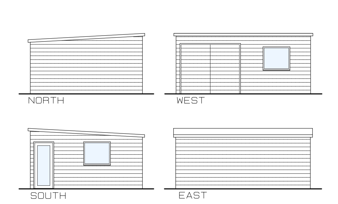

I am looking at the option of a new build detached garage / garden room, as below;
When this is a garden room the garage door would be a proxy door, though may be converted to a garage at a later date.
As a garden room it will need power, heating and insulation. I am looking to build as circa 100mm timber stud, with timber cladding insulation in the cavity, plaster on the inside.

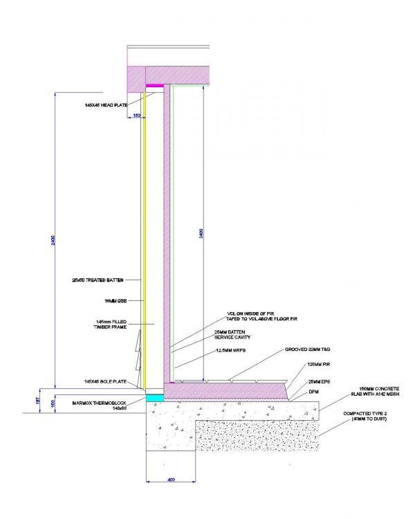

I was randomly doodling and came up with this work in progress for a future, super warm, garden room section. The only thing stopping me going ahead is time, money (£££££ I'd guess) and the probably need for pp that would likely be rejected anyway (AONB)! I've got loads of drawings like this, for numerous  projects that'll never happen..... ?
I was trying to see if a section was possible using stock heights of timber, pir, plaster board etc without cutting.
GarRm_007.thumb.jpg.1adf9129eee2d1384285961b51e9db91.jpg.9eacabfb90db82be5b41949cd02e0564.jpg
That is probably pretty close to what I am thinking, minus the insulated plaster board.
The question I have is if the pit and ufh would take the weight of a car in future?
I'd go for a concrete raft.100mm EPS100 (or more) with DPM, 100mm concrete + mesh above. Can be power floated for a smooth finish. Very simple solution and will easily take the weight of a car.
6 hours ago, Onoff said:
So in this build up you've a 2 course high void under the wood frame? PIR goes between the floor joists?
No. There is no floor frame.Just PIR and OSB resting on the slab as the floor.
If worried the PIR might compress you can lay joists same depth as the PIR but these would be between the brick not on top.
