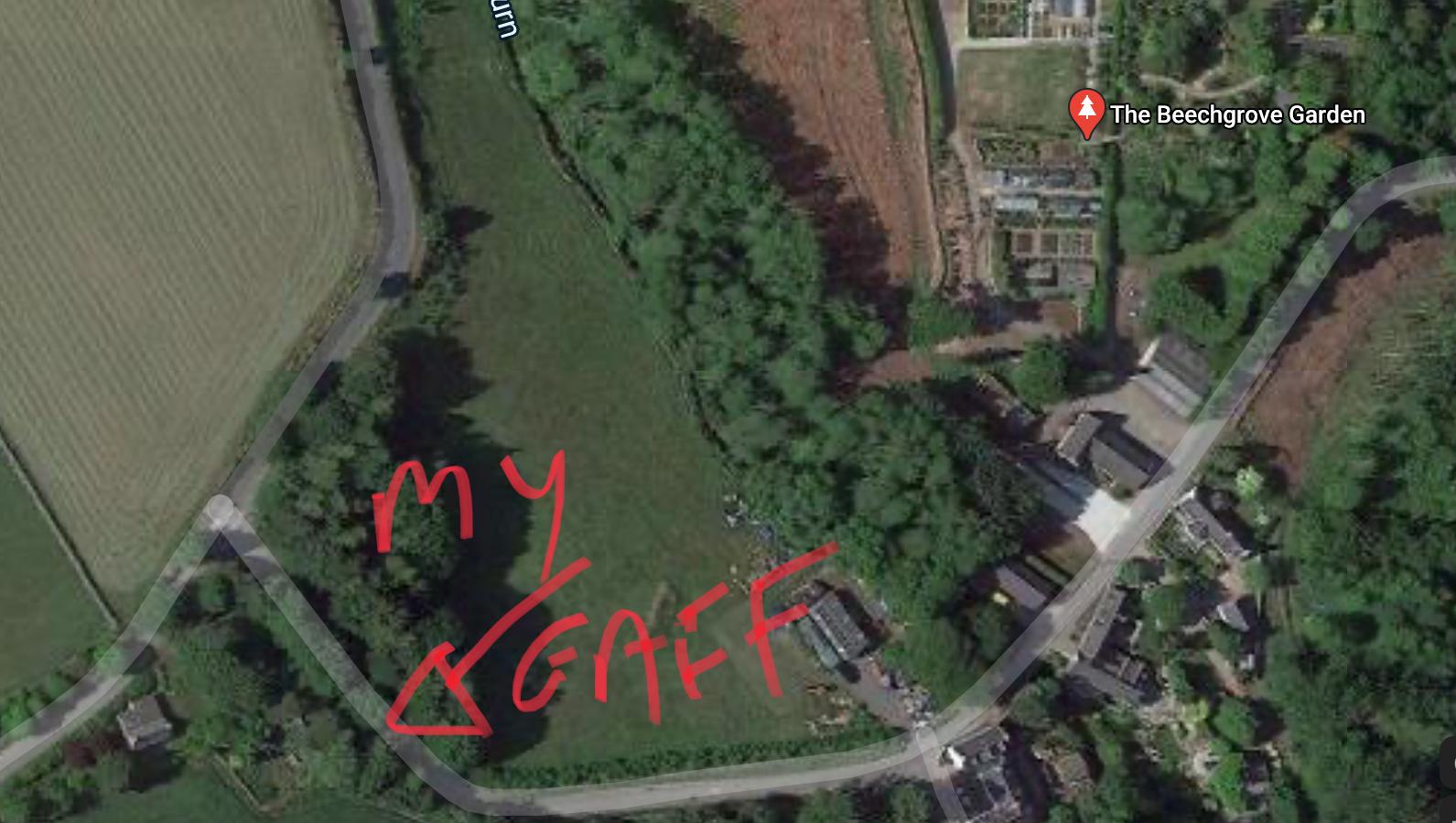

Assuming it’s the Beechgrove Garden that’s filmed literally 60/70 metres from my plot / self build.  They film on Tuesdays and they’ve put me in touch with one of their garden designers whose going to do a design for me because I’m a terrible gardener.
I see you’re from Notts.  I grew up in Cotgrave where there’s a street named after my after my Grandma.
Small world.
Edited by Bozza
@Gus Potter. I've had a look at that link and the superficial deposits are Till, Devensian and Diamicton. The bedrock is Tonalite. Does this mean anything to you?  It means absolutely nothing to me!  The field is on a gentle slope with a field behind it uphill.  There is a road at the bottom of my field and then another field beyond with a burn at the bottom.  My field is actually my mother's field and she is keen for me to move up to Scotland as she enters her twilight years.  We know that there is plenty of water that comes off the hill as it passes through my mother's garage ?.  I would also have a septic tank as there is no mains sewerage in the area.  There is also no mains gas, but I'm wanting to avoid gas and would like to have either a biomas boiler or a Klover Smart 120 (for cooking, heating, hot water).

Looking at water supply and septic tank/ perhaps something that treates the sewage to a higher level such as a some form of treatment plant, more costly but can offset the cost of a soak away type drainage field.
Broadly speaking, to get you a feel for things, you often see information presented in tems of bedrock and superficial deposits, in some ways it's much easier in Scotland as you don't have to deal with sink holes that can occur in limestone, deep clay, complex ground conditions and soil layers that you get down South. There is some tricky ground in the Forth valley / Glasgow and so on for example. Also, you don't have to deal with mining that occurs in the Central belt.
I think you Mum talks sense.
A superficial deposit is the soil that generally sits on top of the bedrock. The term soil is used by Engineers to often describe the stuff you build on rather than the "top soil" on which the grass grows.
Roughly, Tonalite is a form of granite.
The UK was not always one land mass. Essentially it was originally part of two ancient land masses that came together.
Once they came together there have been a number of different ice ages, which have eroded the land, melted and dumped stuff where the ice melts, this is often called "till". It can be fine minerals, small pebbles, boulders the size of houses, more and anything else that the glacier picked up on it's way.
The Late Devension age is split up a bit but roughly the last period (say 22 -33 thousand years ago) relates much to the last major ice age although there was a more recent one on the west cost, around Loch Lomand. So this descibes when the till was laid down.
Diamiction often describes how this stuff (till) was then moved about, further mixed up and redeposited.
In other words you could have a good mix of material, some more suited to water extraction / sewage soak away.
You mention that you are on a slope and that water comes into your mum's garage. But you have a field above so that surface water may not be suitable as a potable water supply. The key here may be to tap in above the house to the ground water that lies deeper and this could give you a good reliable supply.
If you are interested then to do this you want to look for the fractured / weathered rock and there could be a decent layer of this not too far down. The best way is to dig a few good sized holes with a jcb first.
Dig through the top layer of soil until you hit the rock, clean it off and have a look at it. If it looks like it has fractures of a good width or lots of small fractures (you probably won't see gaps just bands of the till that have washed into the gaps in the rock)  in it then it's worth exploring more. If you don't fancy that then call a few of the bore hole companies and they will give you some good pointers.
As the surface ground water is high and you have a sloping site you will probably struggle to get a soak away to work at a sensible cost if at all. From what you describe it seems like the top layers of soil that could be used for a soak way are thin and not very permeable.
For the sewage you may be able to use a treatment plant and run a small discharge pipe to the burn?
Lastly before you spend any money give SEPA a call or drop them an email to check if there are any restrictions on a private water supply with regards to radon.
