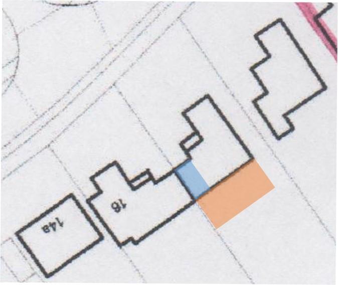

GBuild Posted August 24, 2020 Share Posted August 24, 2020 Hi Total newbie here, but confused by permitted development rules. House is detached with garage at the rear (blue on image) at the boundary. We are looking to do a single storey rear extension 6m back for the full length of the house. Trying to find out if we do it for the full width of the house including the garage (orange on image). Can’t seem to find anything on if it can be done behind an adjoining garage without planning permission. would be great full for any advice on this many thanks Link to comment Share on other sites More sharing options...
PeterW Posted August 24, 2020 Share Posted August 24, 2020 Are you saying the garage is detached ..? Or it’s attached to the house..? It looks to bridge between properties 16 & 18..?? Link to comment Share on other sites More sharing options...
GBuild Posted August 24, 2020 Author Share Posted August 24, 2020 The house is detached. The garage is attached to the house and at the boundary very close to the neighbour’s house/garage but not touching. Link to comment Share on other sites More sharing options...
PeterW Posted August 24, 2020 Share Posted August 24, 2020 Ok so if the garage is attached to the house you can go straight across the lot assuming it is part of the same dwelling. Link to comment Share on other sites More sharing options...
Temp Posted August 24, 2020 Share Posted August 24, 2020 (edited) This document may help but takes some reading.. https://assets.publishing.service.gov.uk/government/uploads/system/uploads/attachment_data/file/830643/190910_Tech_Guide_for_publishing.pdf As its more than 4 meters deep it will (at least) need to go through the neighbour consultation scheme. See "g)" on page 17. Edited August 24, 2020 by Temp Link to comment Share on other sites More sharing options...
DevilDamo Posted August 24, 2020 Share Posted August 24, 2020 As @PeterW and @Temp have mentioned and providing the garage is ‘original’ and not ‘existing’, then yes... you can put on a 6m deep rear extension across the complete width via the Prior Approval (with NCS) route. Link to comment Share on other sites More sharing options...
GBuild Posted August 24, 2020 Author Share Posted August 24, 2020 13 minutes ago, DevilDamo said: As @PeterW and @Temp have mentioned and providing the garage is ‘original’ and not ‘existing’, then yes... you can put on a 6m deep rear extension across the complete width via the Prior Approval (with NCS) route. Thanks everyone - really helpful is there an easy way to confirm if the garage was original? There is nothing on this house in the local authority planning website. Link to comment Share on other sites More sharing options...
DevilDamo Posted August 24, 2020 Share Posted August 24, 2020 Although there may be no Planning history on the website, the LPA should have some on file but there may be a charge for it. Depending on the age of the property and if any of your neighbours have submitted Planning applications in the past, the Planning Officers’ report that accompanies those applications may make reference to an original Planning approval. That original Planning application may have been uploaded to the website somewhere or failing that, you can ask the LPA to provide you with copies of the approved drawings, etc... Btw, anything built prior to and up to 1st July 1948 is under PD considered to be ‘original’. Link to comment Share on other sites More sharing options...
Ferdinand Posted August 24, 2020 Share Posted August 24, 2020 You can go in and inspect the file in person - I think without charge. Obvs depends on Corona, but if the inspection is free and they try and charge you for online docs could argue that it should be free as normally inspection would be. Or try an FOI. Link to comment Share on other sites More sharing options...
