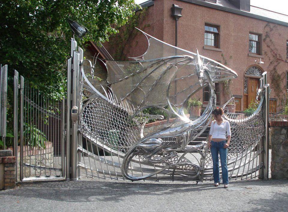

Onoff Posted August 22, 2020 Posted August 22, 2020 I'm particularly pleased with the way my gates coming along. Keeps the super car stable safe at least. SWMBO, pictured, is one reason all my jobs take so long... (Mods, any chance of a tongue in cheek emoji? ?) 1 3

Ferdinand Posted August 22, 2020 Author Posted August 22, 2020 1 hour ago, Onoff said: I'm particularly pleased with the way my gates coming along. Keeps the super car stable safe at least. SWMBO, pictured, is one reason all my jobs take so long... (Mods, any chance of a tongue in cheek emoji? ?) https://www.harlechhouse.com
Onoff Posted August 22, 2020 Posted August 22, 2020 8 minutes ago, Ferdinand said: https://www.harlechhouse.com Damn you, I'm sussed! ? Indeed, in Dublin.

Ferdinand Posted August 22, 2020 Author Posted August 22, 2020 (edited) 3 minutes ago, Onoff said: Damn you, I'm sussed! ? Indeed, in Dublin. At least I didn’t point out that there are 7896 photos of those gates. And one of those gates and a girl. Edited August 22, 2020 by Ferdinand
Onoff Posted August 22, 2020 Posted August 22, 2020 Just now, Ferdinand said: And one of those gates and a girl. What gates? 1
Onoff Posted August 22, 2020 Posted August 22, 2020 I believe that's where the phrase "I'd stick my arm in a sliding gate for a go on that!" comes from. 1
