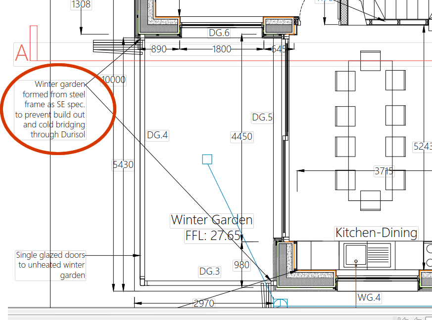

ToughButterCup Posted January 1, 2017 Share Posted January 1, 2017 @MrsRA loves gardening. And that's why we chose a design which incorporated a Winter Garden inside the house. It is an unheated area on south west corner. The Winter Garden extends from floor level to the roof and so it needs steels to hold it in place. Those steels need to be insulated. A quick look at how we could get that insulation done threw up many types of insulation, and many methods of incorporating the insulation on the steel I bet someone here has done this before, and can offer advice. Please! Ian Link to comment Share on other sites More sharing options...

TerryE Posted January 2, 2017 Share Posted January 2, 2017 Ian, isn't your Wintergarden unheated and entirely outside your temperature controlled living environment? Looking at the drawings it looks like you've got steel verticals carrying the horizontal steel members, and these are effectively external structural members. So why do they need insulated? Even if these are close coupled to the blockwork, then this is on a corner and the extra Psi factor here will be small. Even you are worried about this, then a small airgap (say 5-10mm with spacers between the fasteners to the steel and the blockwork) would drop this 10× to negligible. Link to comment Share on other sites More sharing options...

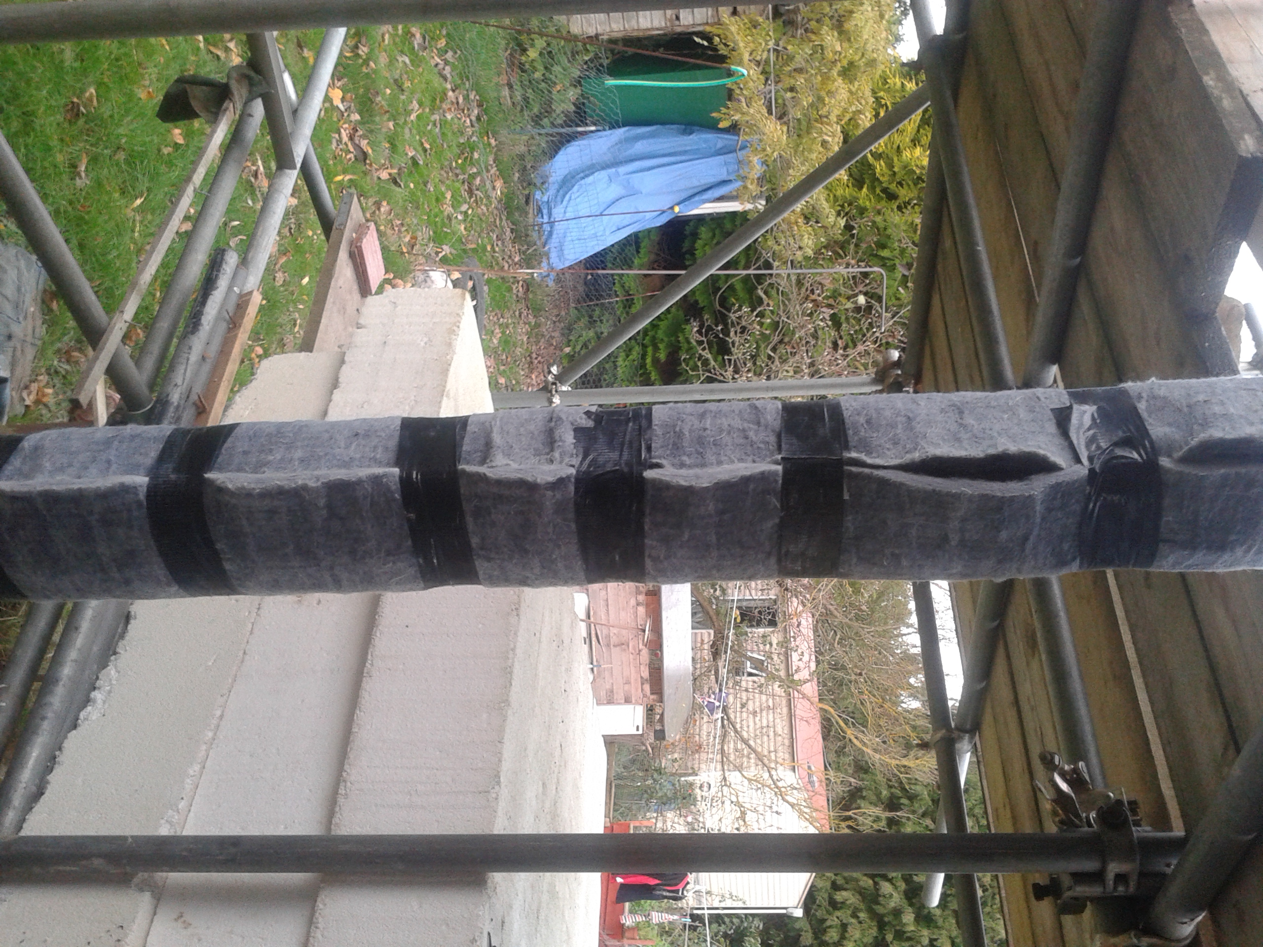

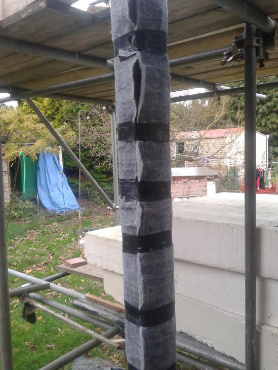

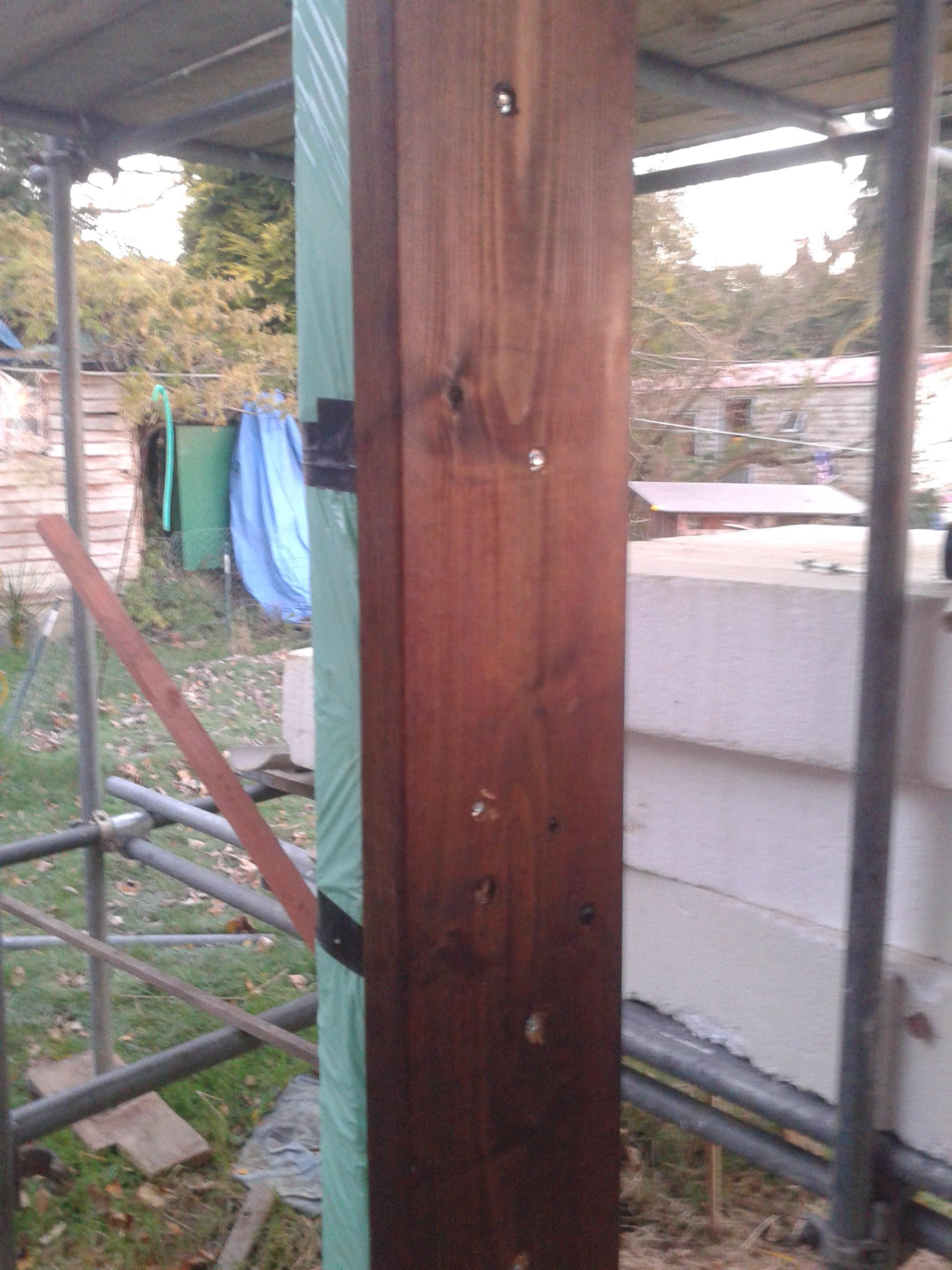

oranjeboom Posted January 2, 2017 Share Posted January 2, 2017 In my extension I had two corner posts (SHS) that will be glazed on either side. I simply applied 10mm aerogel (taped), wrapped with plastic and then drilled timber to all sides. Once windows and doors are attached, I'll use further insulation on the interior where possible. But this is for the heated living room. From the looks of your drawing, you have bi-folds that will close off your 'garden' and will therefore retain some heat and therefore have the potential to cause condensation on the steels - hence the desire to insulate them? Link to comment Share on other sites More sharing options...
ToughButterCup Posted January 2, 2017 Author Share Posted January 2, 2017 2 hours ago, TerryE said: [...] and these are effectively external structural members. So why do they need insulated? Even if these are close coupled to the blockwork, then this is on a corner and the extra Psi factor here will be small. Even you are worried about this, then a small airgap (say 5-10mm with spacers between the fasteners to the steel and the blockwork) would drop this 10× to negligible. The reason behind the question was my thoughtless following of our architects notes to the BREGs drawings. There's no substitute for a sharp mind. You've knocked a few scales off my eyes. (More scales to go, I fear) Cheque's in the post. Link to comment Share on other sites More sharing options...

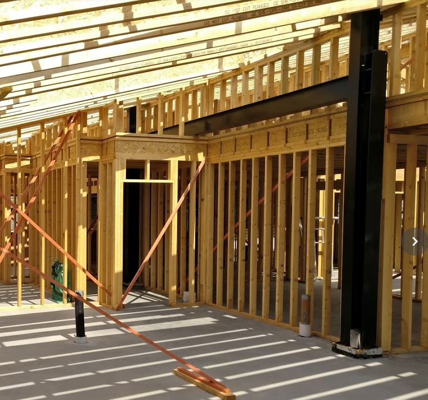

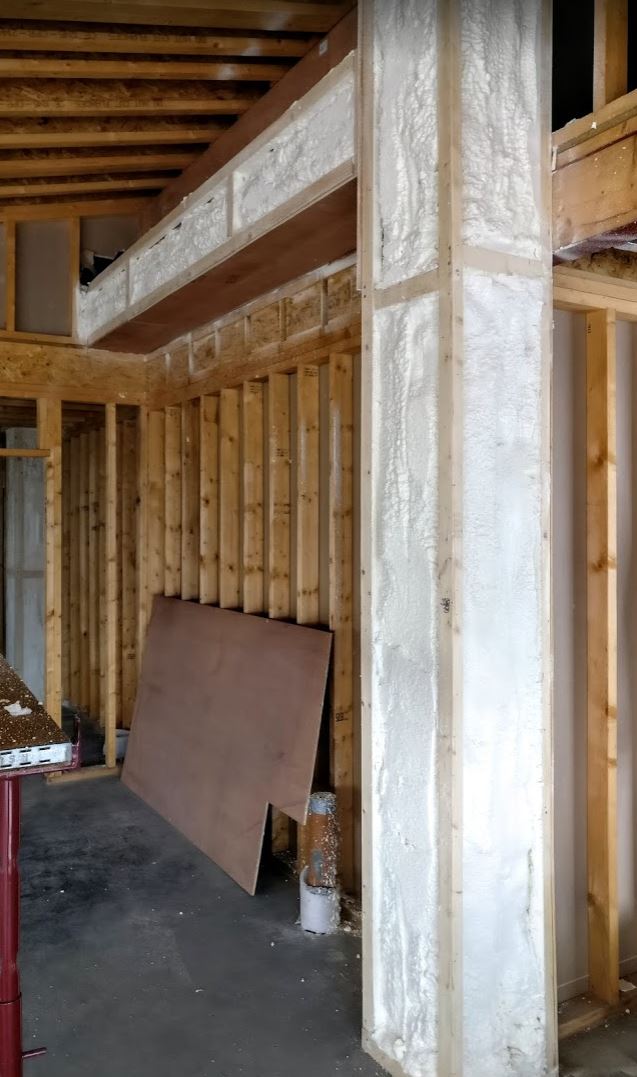

IanR Posted January 3, 2017 Share Posted January 3, 2017 I appreciate this is resolved for RA, but another option for anyone searching for similar in the future: We have 4 Columns of the original cow-shed structure (holding up the roof) that drop into our thermal envelope, and I had to add additional goal-post bracing between each pair as I wanted to move the original racking braces to allow other areas to be opened up: We boxed these in with ply and then used a closed-cell spray-on PU foam, (Elastospray 1629/1 from BASF) to insulate, make airtight and stop and moisture getting to them: The foam needs to be 60mm thick to guarantee no moisture getting through, but we went thicker anyway to maintain the integrity of the thermal envelope. Link to comment Share on other sites More sharing options...
ToughButterCup Posted January 3, 2017 Author Share Posted January 3, 2017 Thanks very much @IanR. It's little gems like the foam needing to be 60mm thick that we need, and indeed which product you used. There are so many out there. Ian Link to comment Share on other sites More sharing options...
