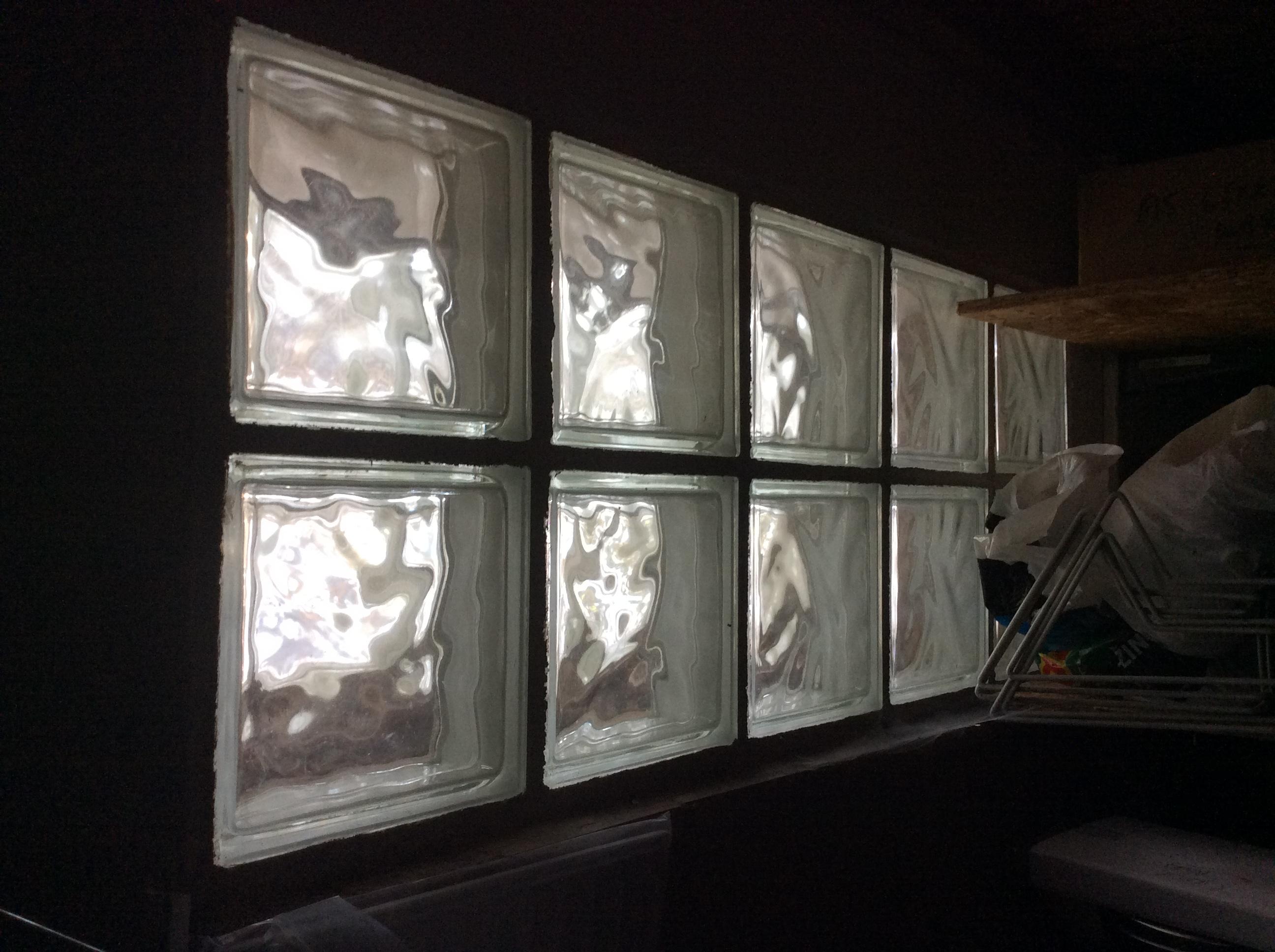

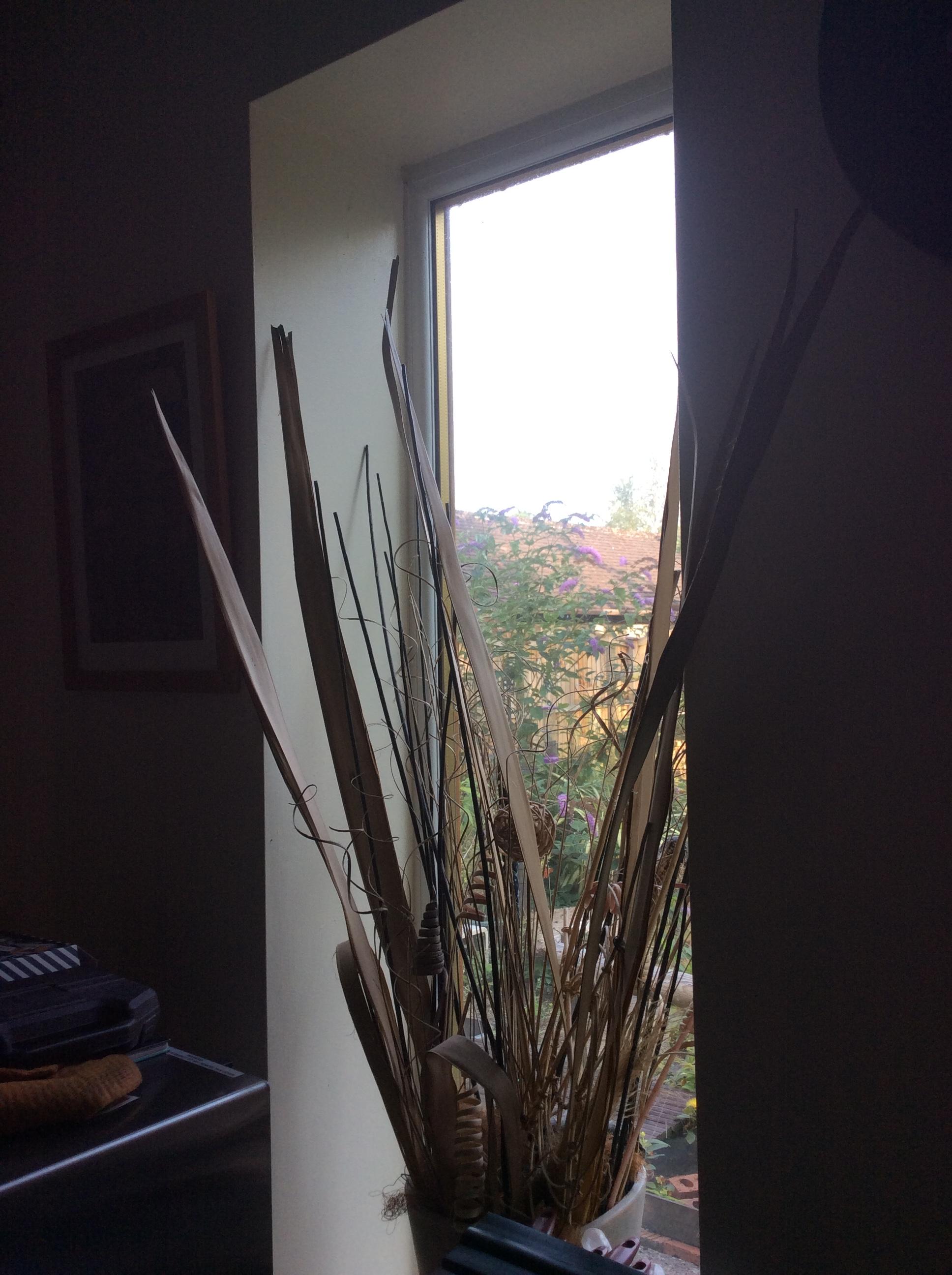

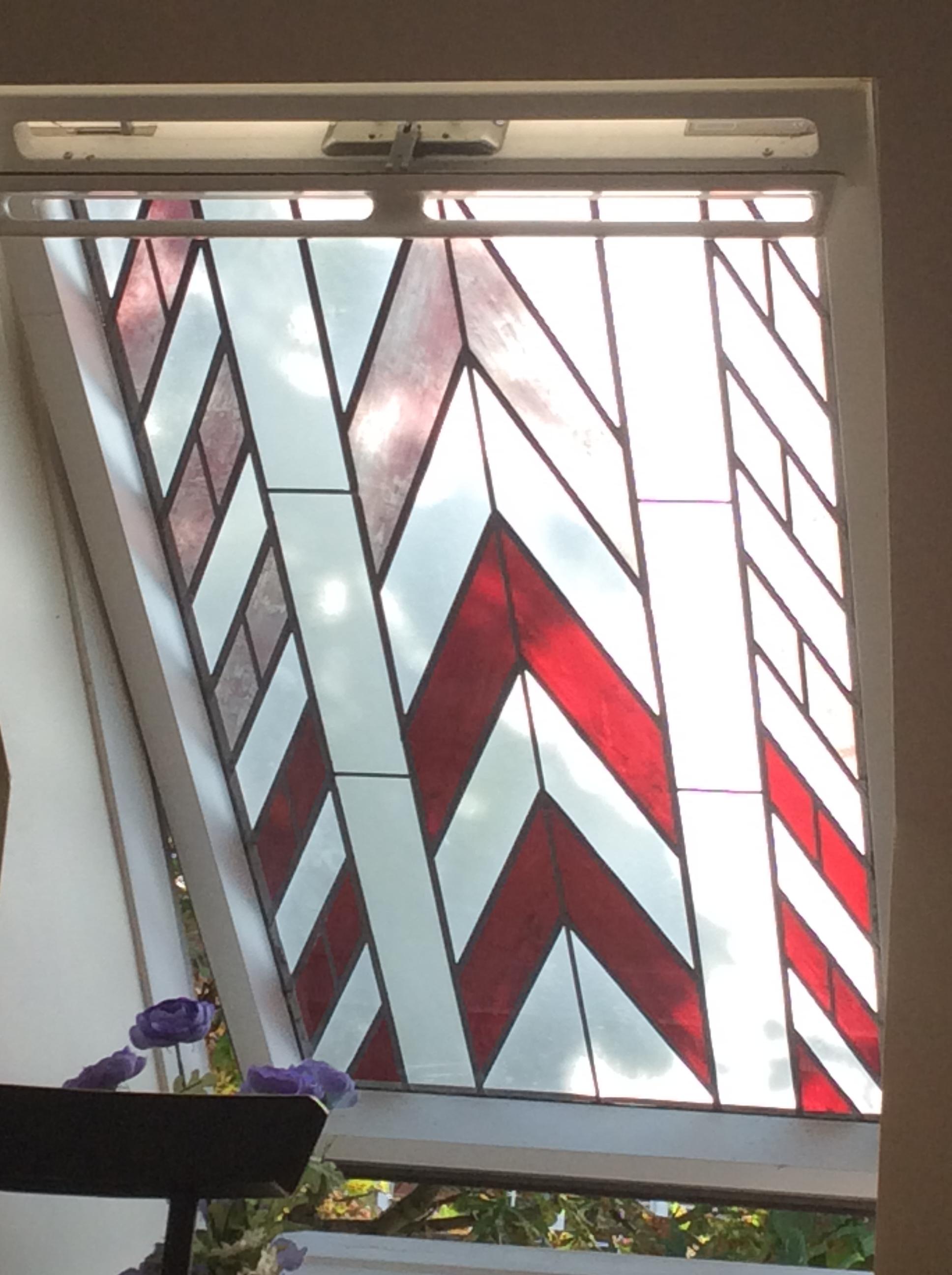

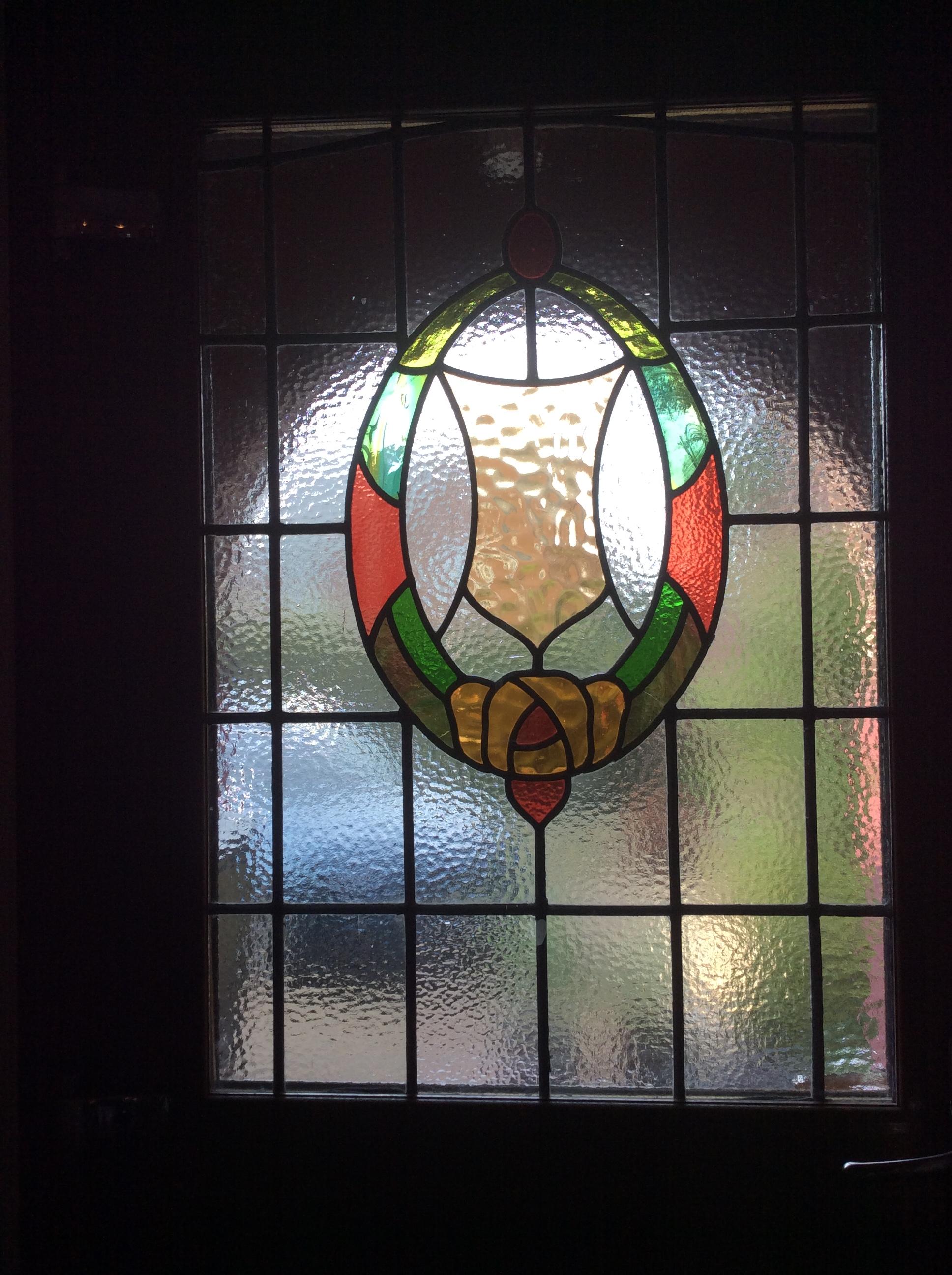

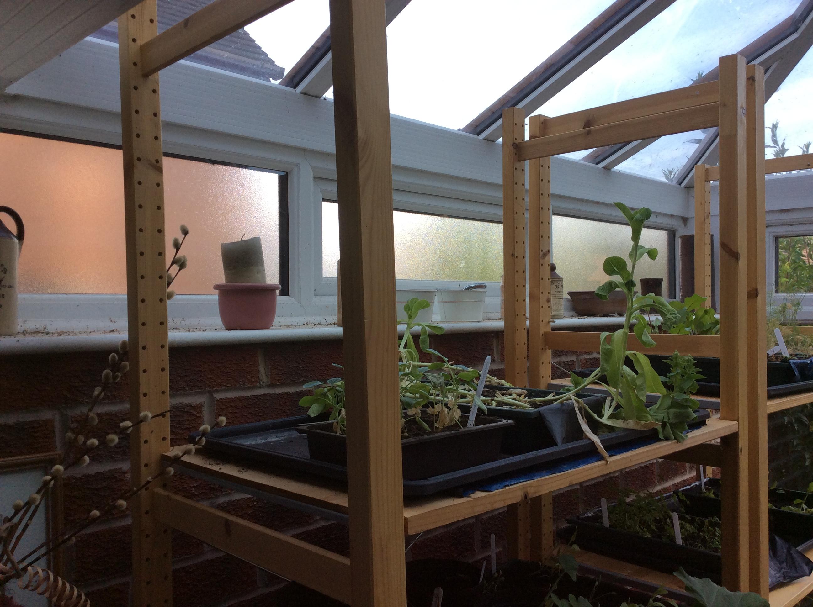

Five photos just taken in my house. Mine is built right on the boundary both sides.
I was responsible for the conservatory .. the PP would have gone right up to the boundary but I did not want to get complicated with neighbours so left a gap which also means my middle lounge has a small strip of wall accessible for wiring, ducts etc on outside wall on my property.
The test was done bŷ the previous owners who extended the bungalow in approx 2008.
Personally I would not have the nerve to put those glass blocks in the garage wall.
Translucent high window in conservatory. 2m garden wall 18” behind it. Next door house 3m beyond that.
Panel in front door .. Edwardian style. For privacy bu5 that green bit is a peephole.
Glass block window in garage. This is on the boundary.
Roof window. Has stick on design as it would look onto next door.
Tall window with permanent arrangement to provide a near field point of interest.
