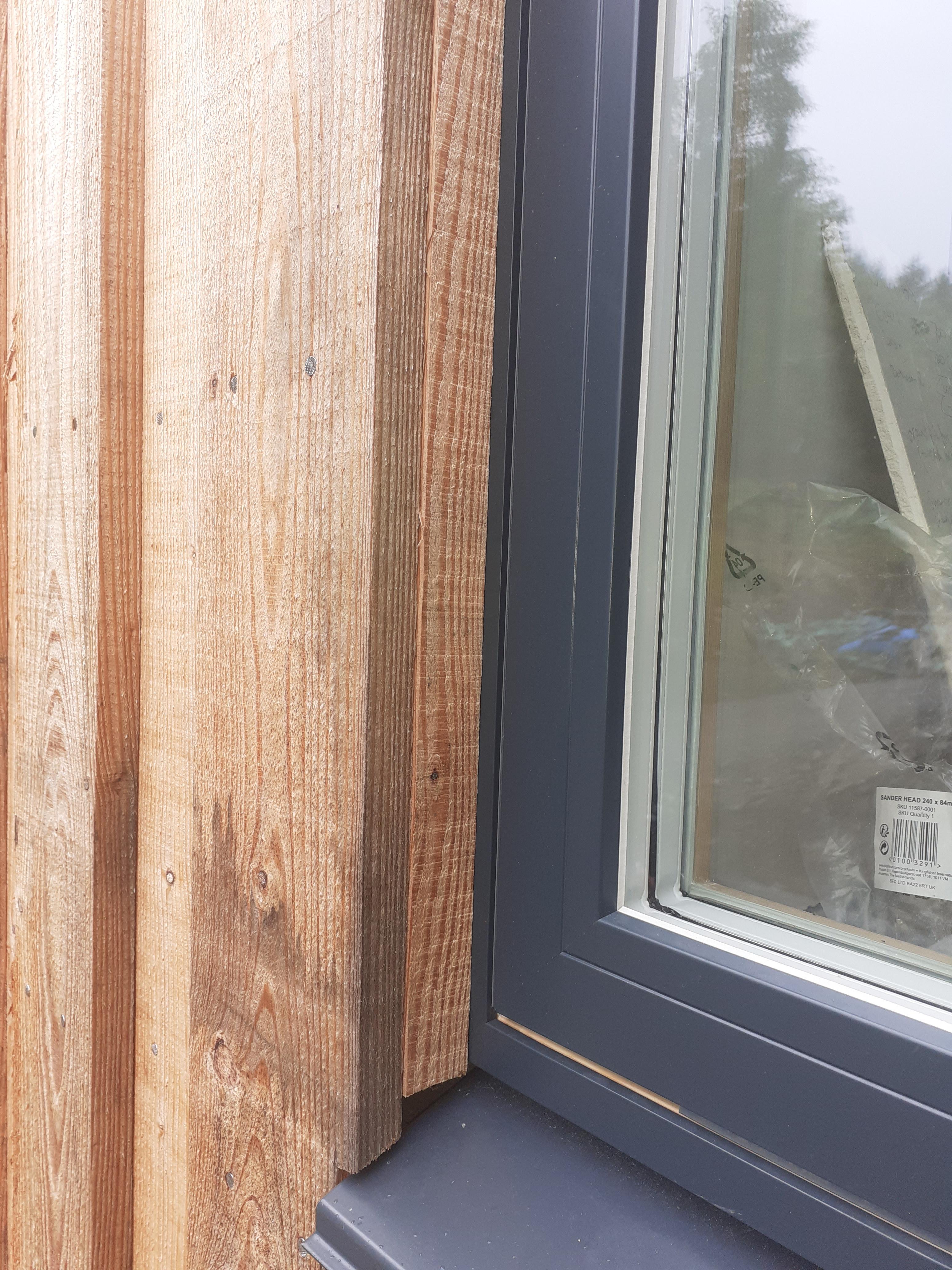

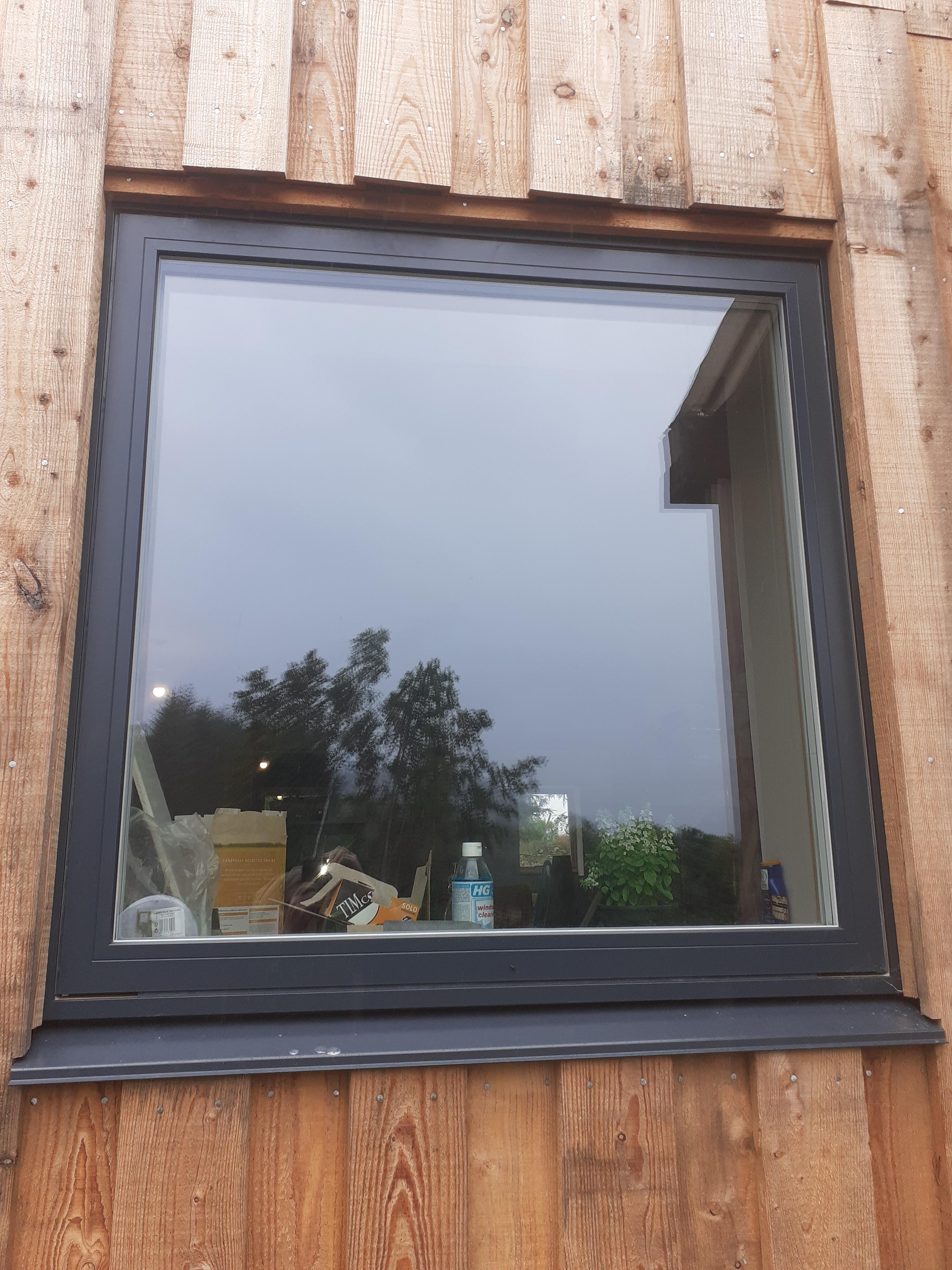

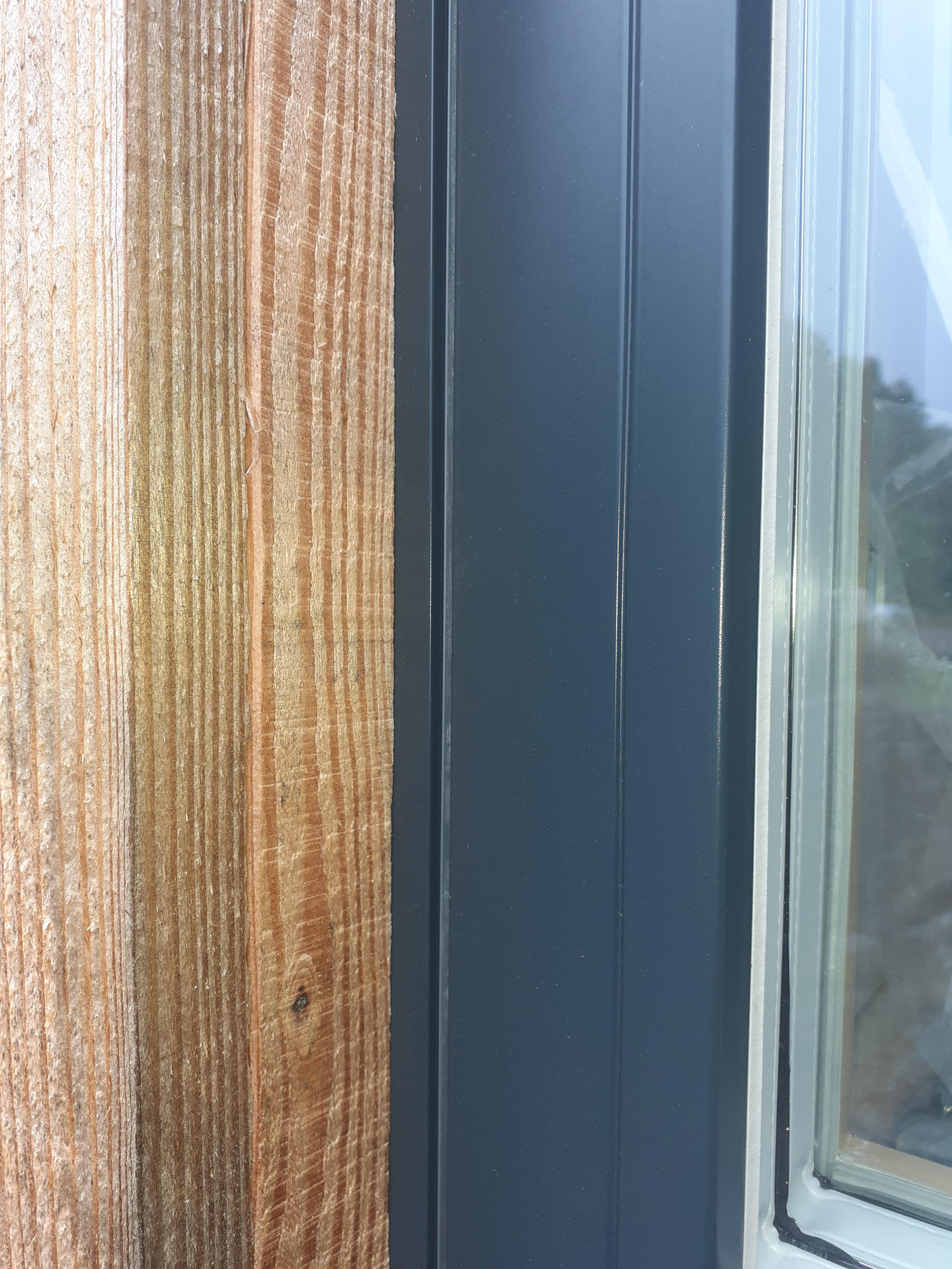

I’m looking at the area of cladding that will sit in the window rebate and not sure what to do. Windows are alu clad Rationel and they show on their fitting instructions to leave the Compriband exposed when fitting the cladding rather than hard up against the edge of the frame.
My my issue with this, is it leaves about 8mm if a gap between the board and the end of the cill.
I like the the idea of running it up against, or even overlapping the frame but am also then concerned with the wooden frame over time being affected by little air flow (if you see what I mean).
Ive attached pics showing the area with and without the choices.
Any my ideas or examples of what others have done?
The wood shown is only a mock up and not the stuff that will be used.

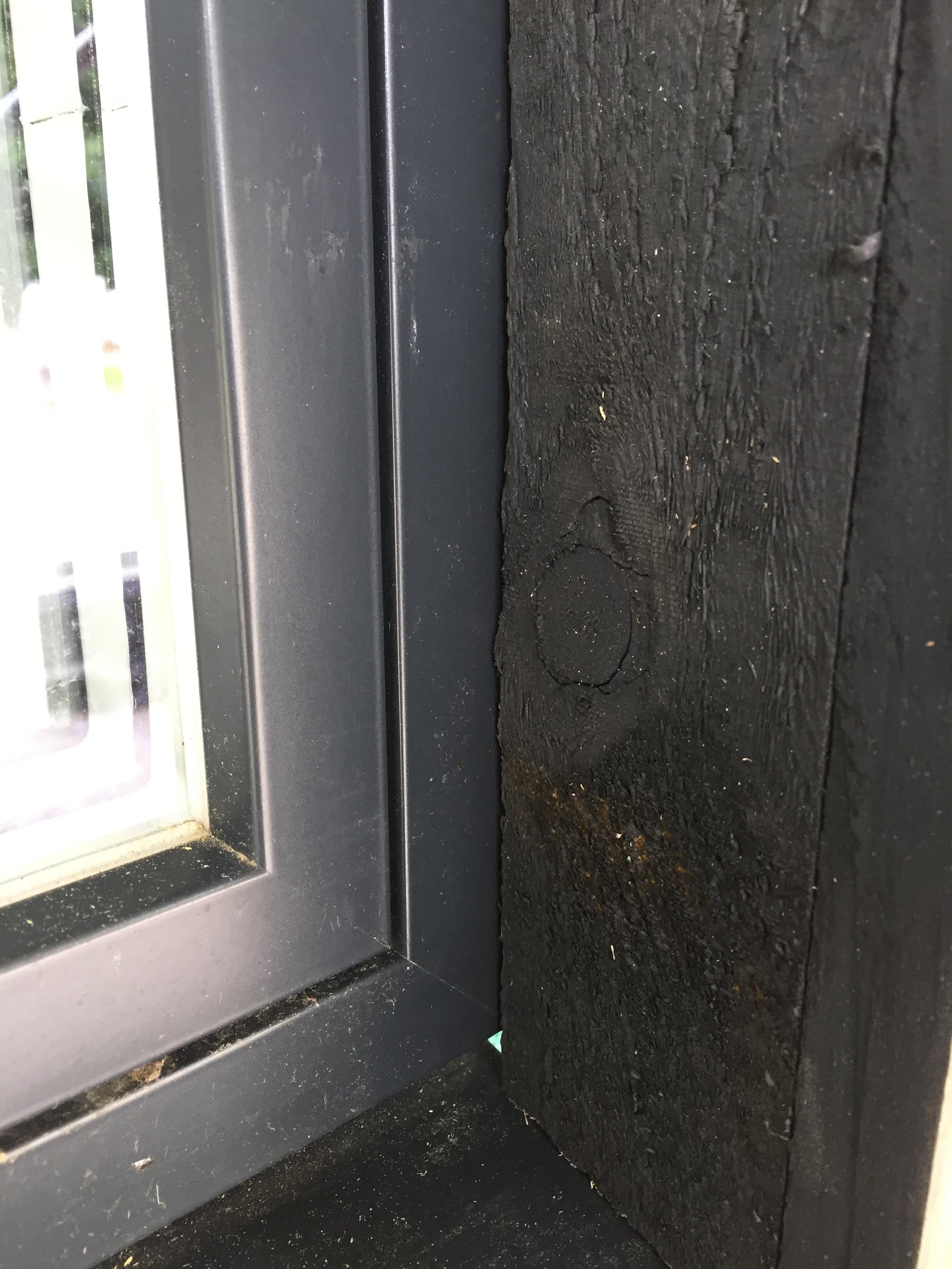

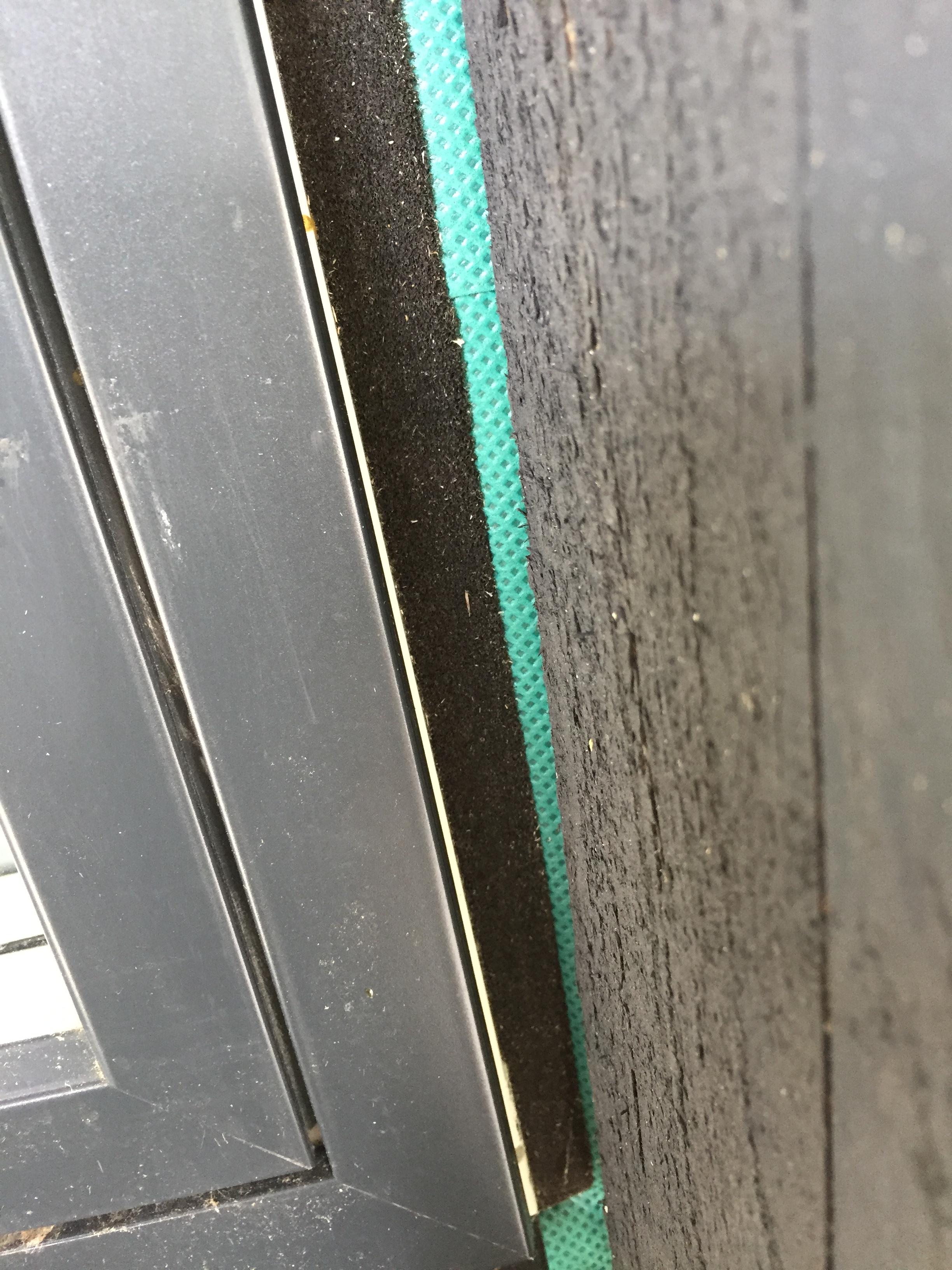

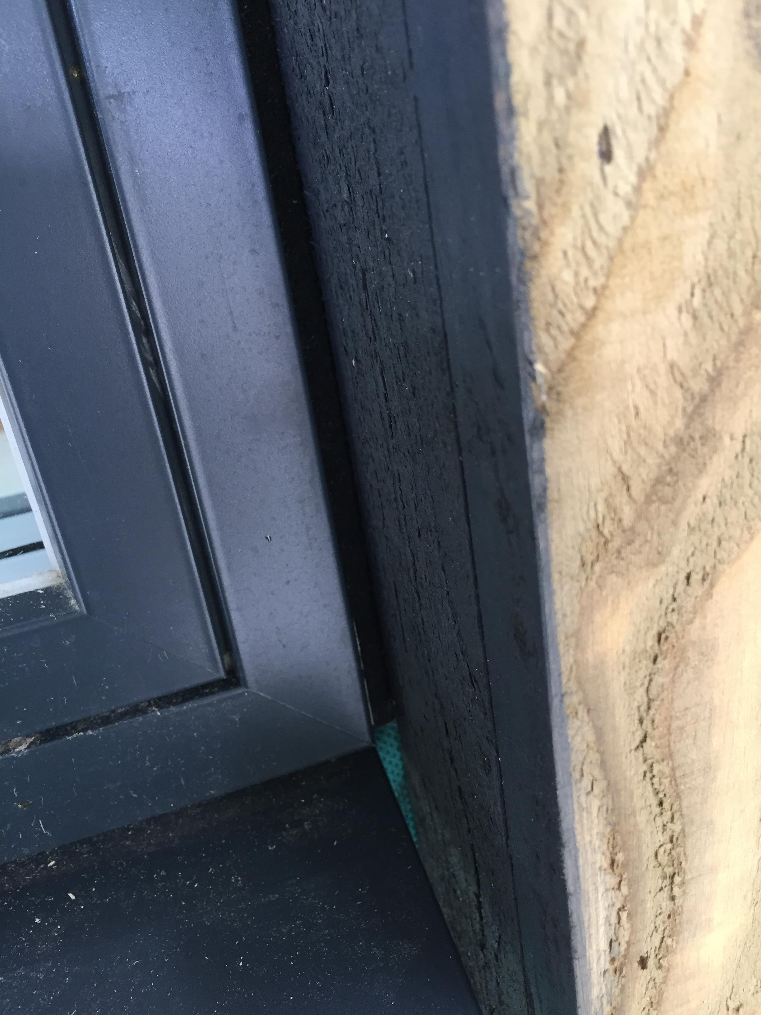

The reason to leave a gap around the window is normally to ensure correct ventilation (of the alu cladding) so I'd imagine if you go with the bottom option with a cladding return, it won't really matter as you'll still have air movement around the cladding (and it definitely looks better!)
Here's ours, though you can't see the compriband. I ripped the cladding for the external reveal.
That is what we’re looking to do. Exactly what I needed to know. Thanks guys.

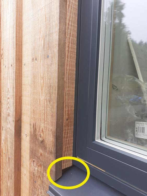

@jamieled - Thanks for posting. I'm curious, on your reveals is there anything behind the gap I've circled in this photo? I'm wondering what level of weather protection is required for the cladding reveals. Thanks.
20200730_154021.thumb.jpg.93a9d4bcb8f0c85bec9fd28b5595f7f7.jpg.5ed514ac7447163a0052322350306150.jpg
@Andrew, no there isn't anything, only some insect mesh. I'd say if I were doing it again I might try and make those bits circled a bit neater. We have reasonable overhangs above the window so the cills don't see a lot of water running down them. So far I haven't seen a lot of water getting in behind the cladding through that hole.
Cheers for the info @jamieled, that's good to know actually.
