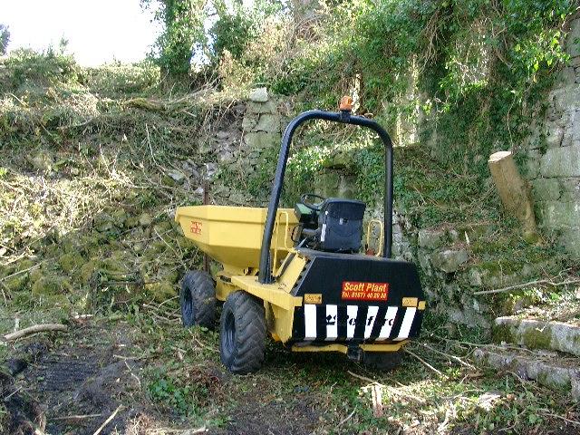

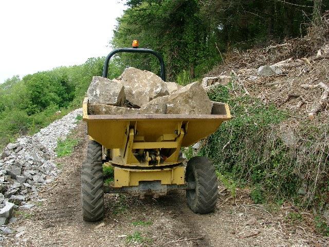

scottishjohn Posted July 28, 2020 Share Posted July 28, 2020 (edited) having bought one benford dsr3000 swivel tip -which was probably not the cheapest --but first class condition and also air cooled engine --no freeze problems things to check --does the hand brake and indeed the brakes work --expensive to fix as they are inside the axle units and not working on most old s/h ones and on flat sites they never bother to fix them 4wd -wouldn,t consider any thing else swivel tip is very handy but depending on site not essential i needed swivel tip to make up sides of my road iwth rock do you need one to fill a skip --thats a different thing again . I see you have several acres --did you get a felling license ? you can only remove trees less than 4" in diameter without one measured at 1.3m for gorund and the fine is £1500 and then they can make you replant - there is also a thinning licnese which allows up to 40% removal of trees without replanting worth a talk with forestry man to see if you need one maybe the bottom line is they do ont want to loose any forest cover at all -and a few acres will not be classed as a garden you can remove up to 5 cum of wood per 4months without a license and iwhtout replanting requirement Edited July 28, 2020 by scottishjohn Link to comment Share on other sites More sharing options...

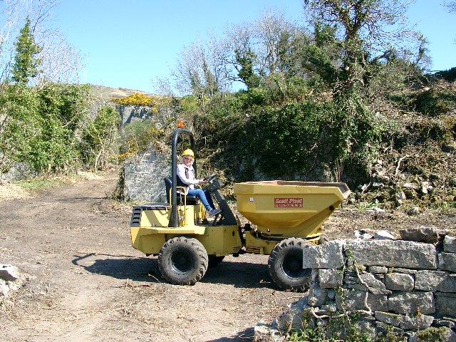

scottishjohn Posted July 28, 2020 Share Posted July 28, 2020 (edited) even the wife can drive it --if pushed first problem with it last week --a puncture hardly a surprise when you see where i been with it Edited July 28, 2020 by scottishjohn Link to comment Share on other sites More sharing options...

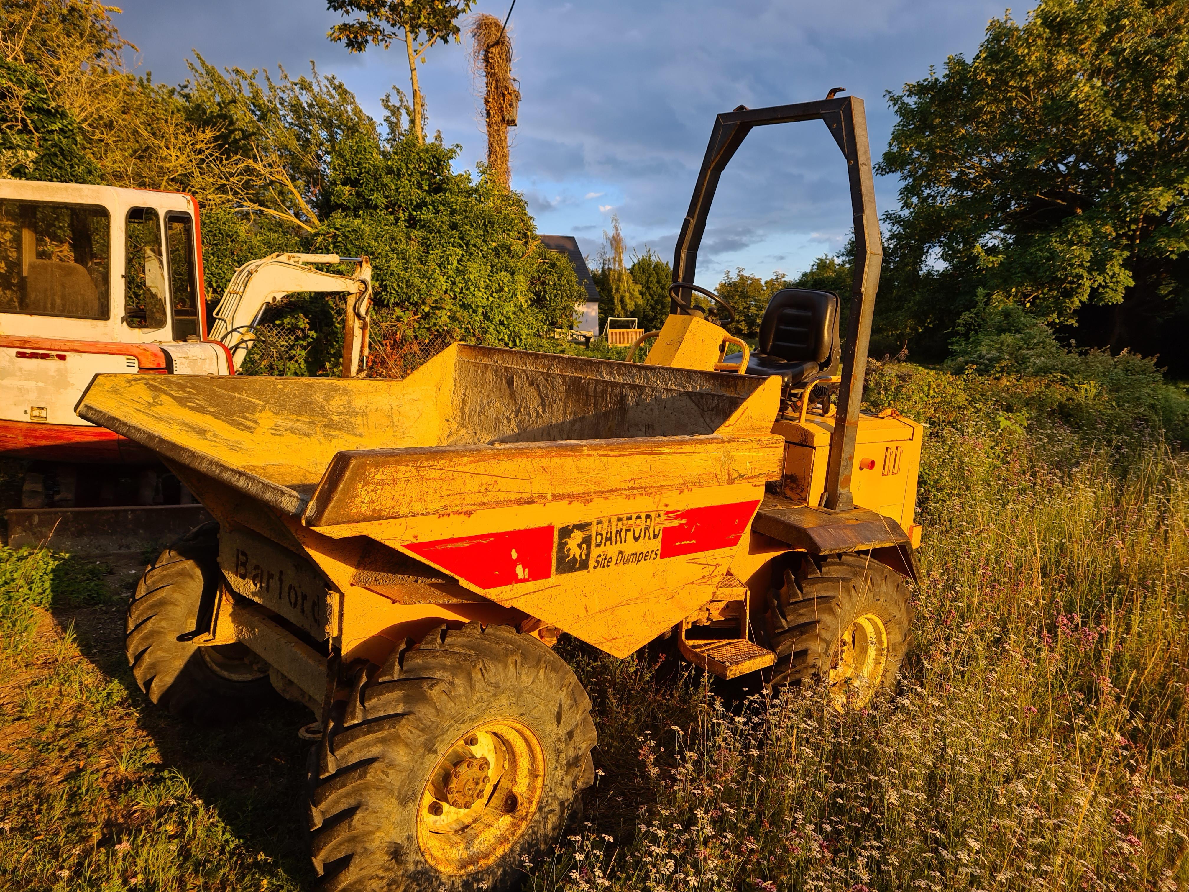

MarkyP Posted August 2, 2020 Author Share Posted August 2, 2020 I found a very tidy 3t Barford SX3000 last week, picked it up yesterday. Very pleased, it's in really good shape and has been well looked after by previous one owner. I was getting a bit fed up with looking at rust buckets and battered old machines so nice to find a good one at a sensible price. I'll add a pic later. Link to comment Share on other sites More sharing options...
MarkyP Posted August 3, 2020 Author Share Posted August 3, 2020 And here it is. Runs really well and can't find a fault with it at all. Glad I went for a 3t, it's a handy size. 2 Link to comment Share on other sites More sharing options...
