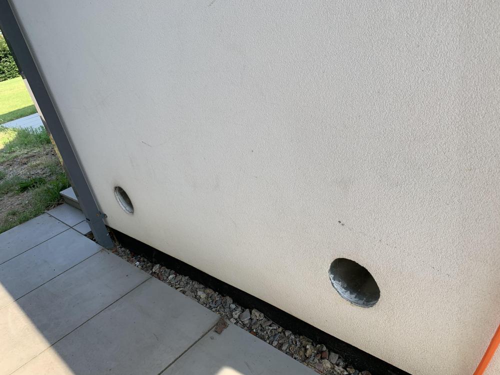

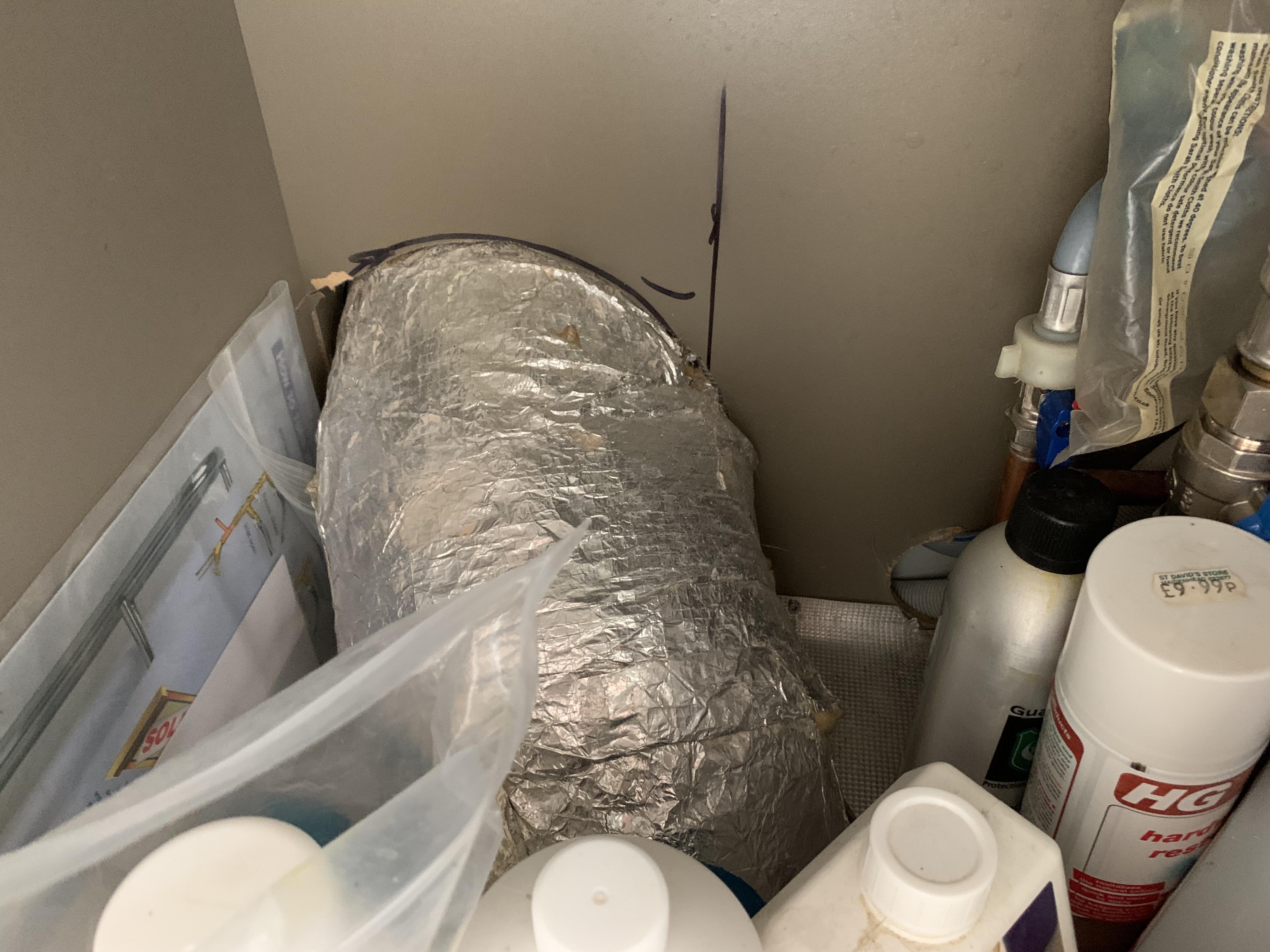

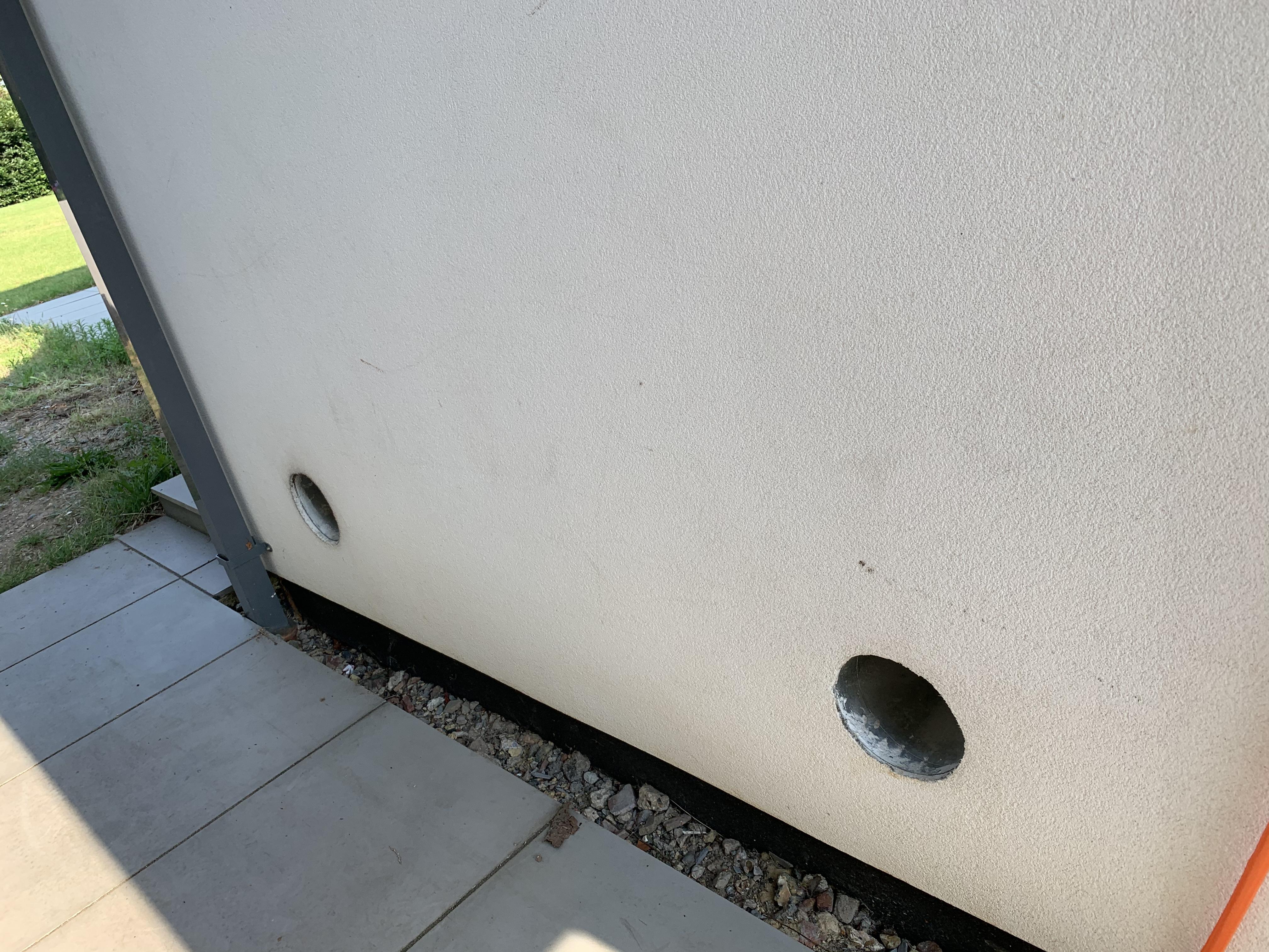

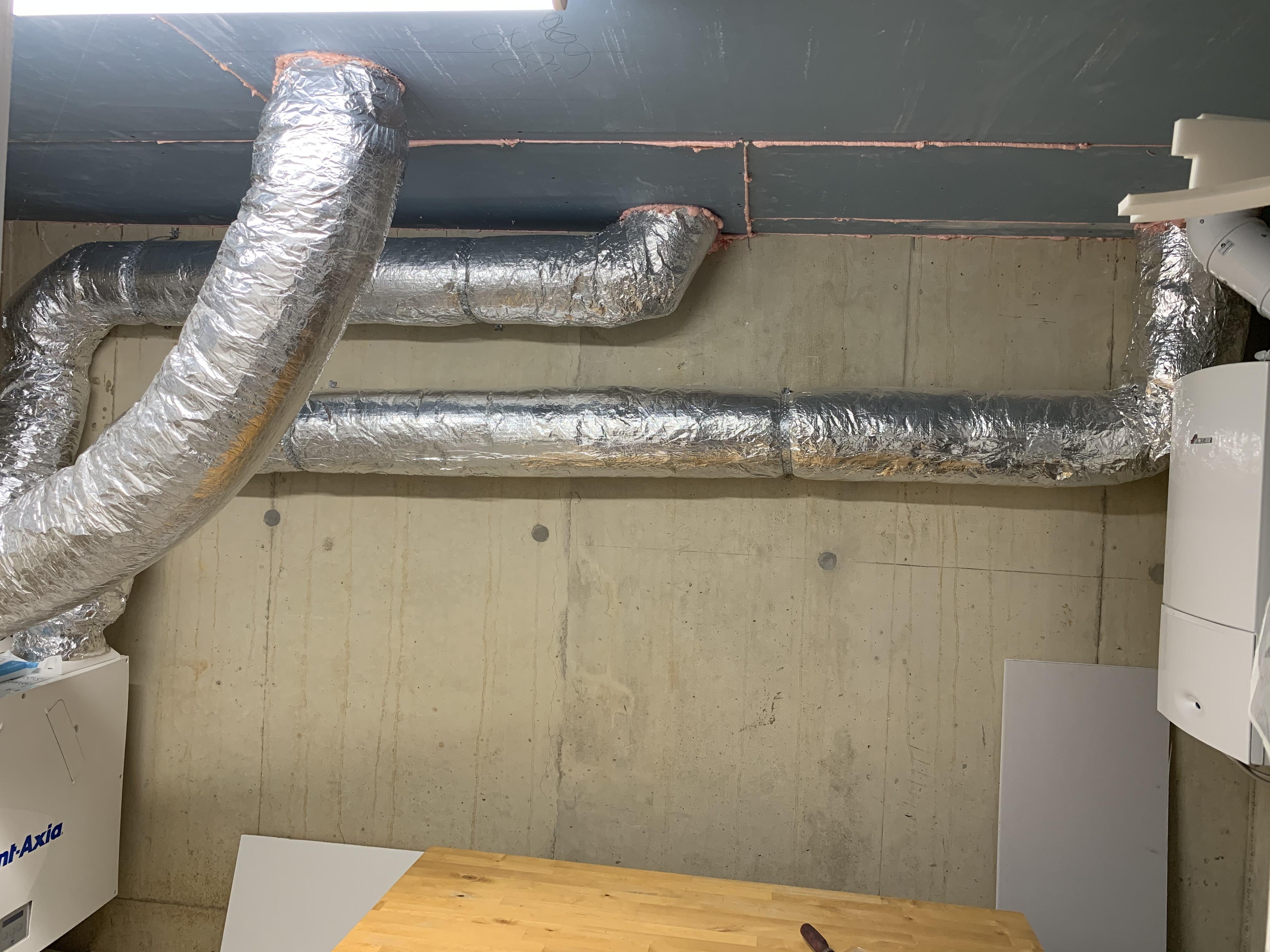

Bitpipe Posted August 12, 2020 Share Posted August 12, 2020 Our ducts go up into the utility room above the plant room and then exit the house about 500mm above ground level. They are obscured by the cupboards in the utility. Will get a few pictures. 1 Link to comment Share on other sites More sharing options...
Bitpipe Posted August 12, 2020 Share Posted August 12, 2020 I have some nice external cowls to fit once the render gets replaced. Despite being near ground level, the internal intake filter does not get that dirty. 1 Link to comment Share on other sites More sharing options...

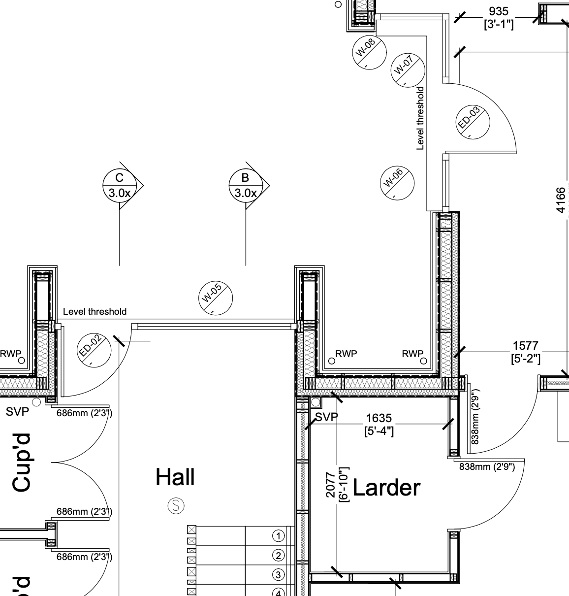

Thorfun Posted August 12, 2020 Share Posted August 12, 2020 6 minutes ago, Bitpipe said: Our ducts go up into the utility room above the plant room and then exit the house about 500mm above ground level. They are obscured by the cupboards in the utility. Will get a few pictures. this is the direction I'm now thinking of going. our larder is above the plant room so I can create a 300mm service void between the larder and exterior wall and run the vents up there and out the wall. the only potential issue is that the area external is not very wide (maybe 1200mm) so I wonder if the distance between the vents will be ok and also it's very sheltered so will it get the fresh air. here's a picture of it. what do you think? a suitable exit? would be around about where the RWPs are so they'd need to be moved. Link to comment Share on other sites More sharing options...
Bitpipe Posted August 12, 2020 Share Posted August 12, 2020 1m separation is fine, sheltered means you won't get unbalancing due to gusts of wind either. My garage wall is directly opposite the vents (about 1m) away and it's fine, fresh air is fresh air Good thing about having unit in basement is that its very easy to access and service - check filters monthly, take out condensing unit for a clean every 6 months etc. Also you never hear it, no vibration hum etc. Link to comment Share on other sites More sharing options...
Thorfun Posted August 12, 2020 Share Posted August 12, 2020 58 minutes ago, Bitpipe said: 1m separation is fine, sheltered means you won't get unbalancing due to gusts of wind either. My garage wall is directly opposite the vents (about 1m) away and it's fine, fresh air is fresh air Good thing about having unit in basement is that its very easy to access and service - check filters monthly, take out condensing unit for a clean every 6 months etc. Also you never hear it, no vibration hum etc. perfect! sounds like the best solution all around as the vents will be pretty much hidden from normal view. I'll speak to the architect about moving increasing the larder size to accommodate a service void which I can use to run the radial ducting down through to the plant room as well as lots of other stuff! Link to comment Share on other sites More sharing options...
Thorfun Posted August 12, 2020 Share Posted August 12, 2020 @Bitpipe do you think a 300mm service void would be enough to get the ducts up and turned at 90o out through the external wall? from the photos it looks about what you have in that cupboard. Link to comment Share on other sites More sharing options...
Bitpipe Posted August 13, 2020 Share Posted August 13, 2020 Depends on your external duct size - mine were 180mm but it was slightly complicated by the way the basement wall sits in relation to the timber frame above - meant that even when the ducts were tight against the basement wall there was a 100mm gap between the duct and the internal utility wall that increased the space required. Also keep in mind that the duct diameter increases by another 50-60mm due to the duct insulation. I was not able to get a sharp 90 either as the floor joists dictated where the ducts could rise so I used a combination of 45 bends and eventually got there - was quite fiddly and I remember there was lots of swearing I did get the TF team to fit two sections of 180 duct into the wall ahead of time to ensure these could be made airtight against the frame and be rendered up against, but it did mean I had zero flexibility in making the connections. However I think 300mm should be more than enough for you. 1 Link to comment Share on other sites More sharing options...
