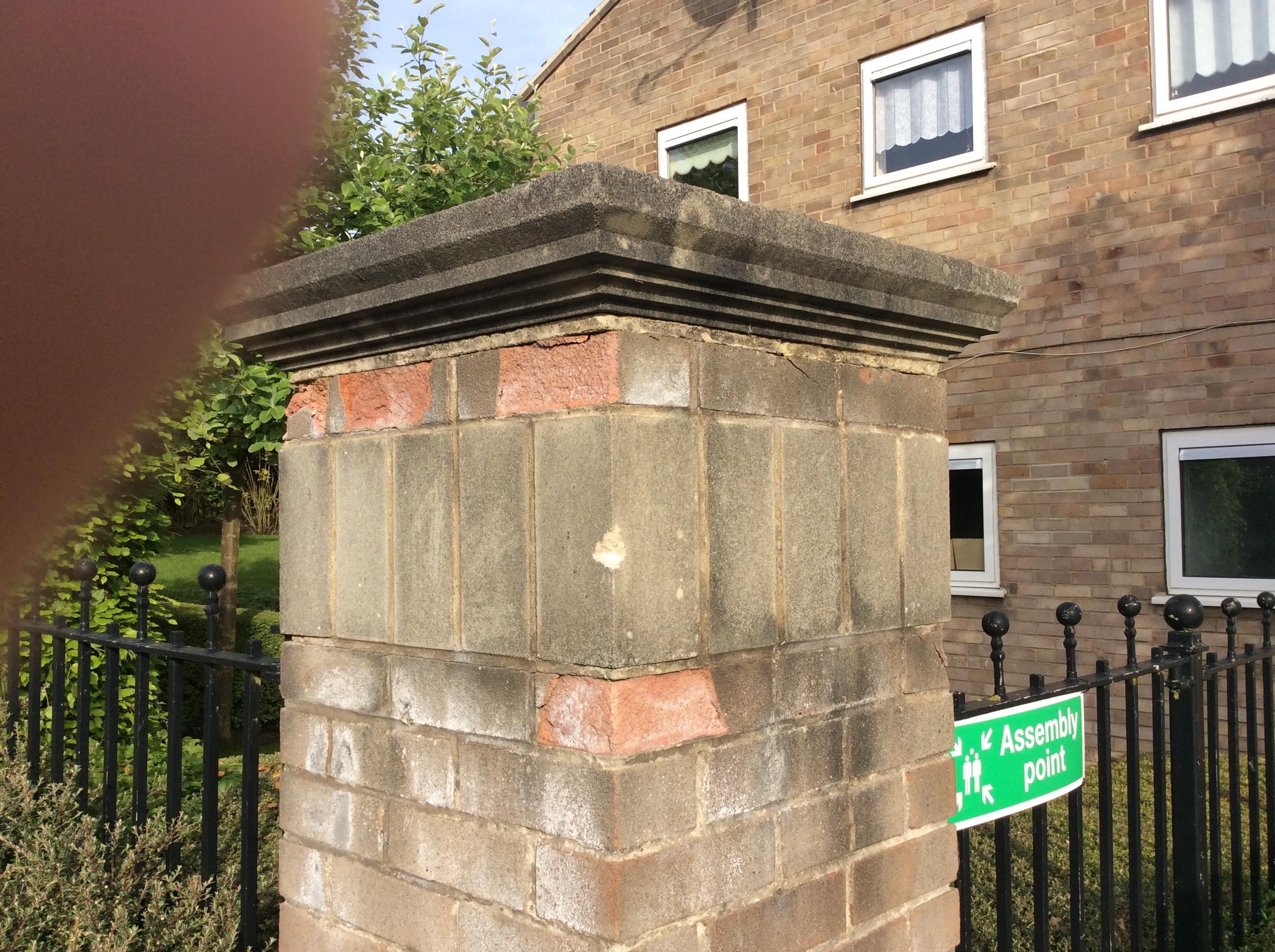

Ferdinand Posted July 26, 2020 Share Posted July 26, 2020 My point would be to check that your chosen blocks will be frost tolerant in the way you plan to use them. I think blocks are more resilient than bricks (where you need engineering not facing bricks for a wall to prevent spalling over time), but worth a check. This is what happens to brick walls not done properly with the correct bricks. Link to comment Share on other sites More sharing options...
