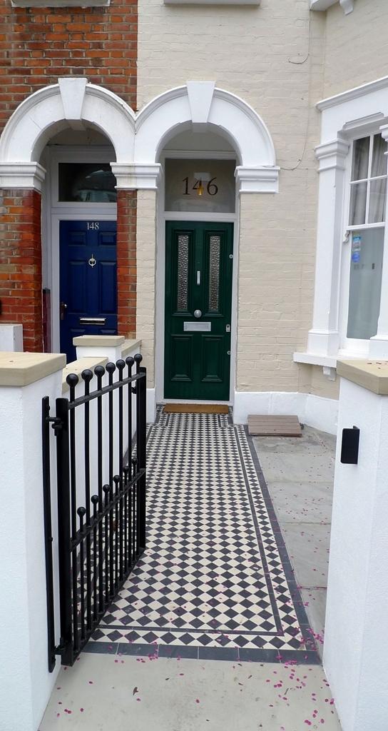

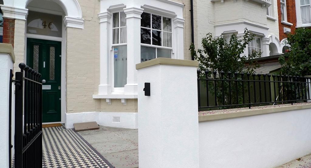

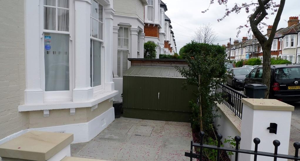

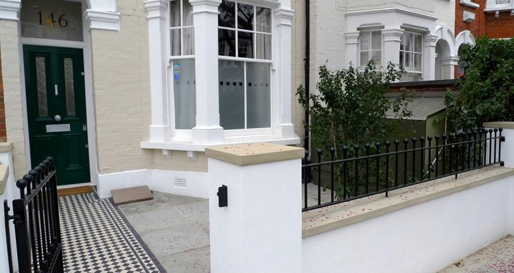

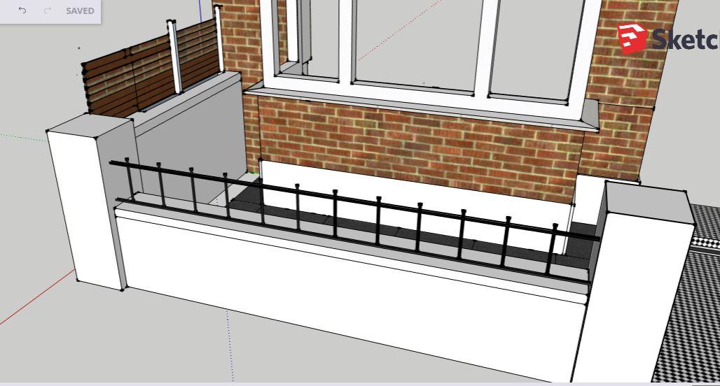

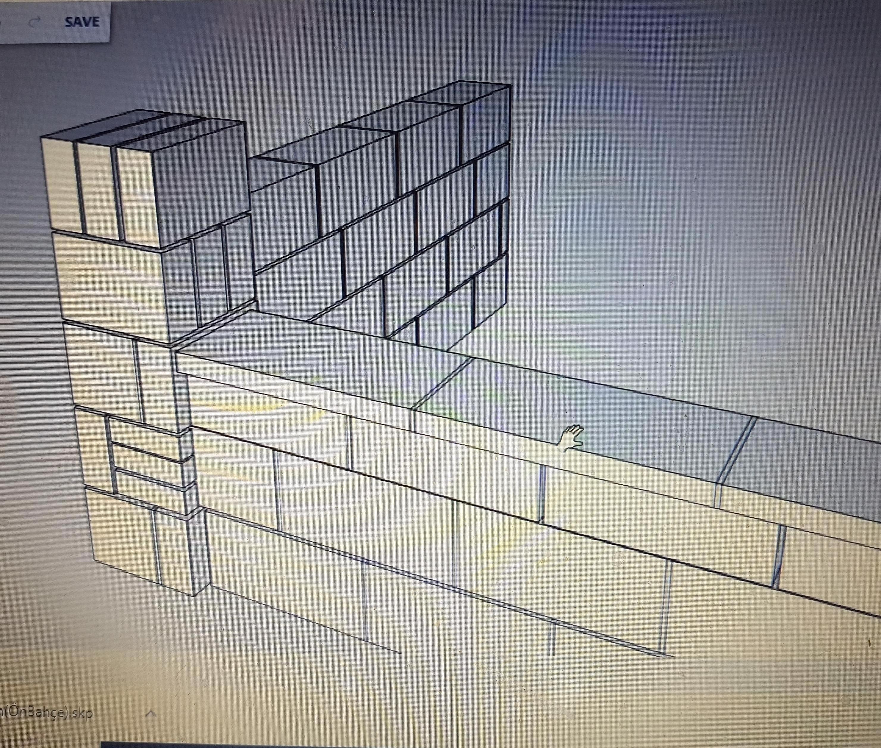

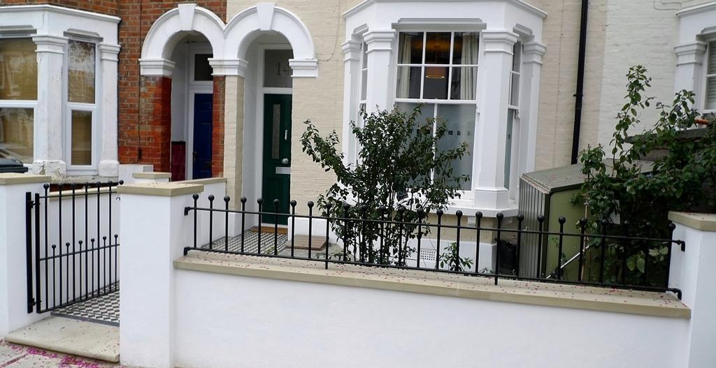

  4. Hello, I am going to have a go at re-building my front garden wall. It's about 3.6m wide and about 2m on the return to the house. As I have no bricklaying experience I wanted to try it in block as this seems quicker and easier, however the design I want is proving to be tricky. I've attached pics of the looks I am after, which is basically two piers, 5cm or so proud of the 215mm block work and then rendered, please see attached pics and my designs. I've designed the block work to lock in together for extra strength rather then using ties to join piers to wall, you can't see it in the sketchup pic, but the block work bonds into the pier on course 1 and bonds from the other side. Anyone got any suggestions to improve this, how's it normally done and is there an easier way, because i want the 5cm recess at the front it's proving the hardest part and there will be some tricky(ish) concrete brick cuts to form the pier. Thanks.
