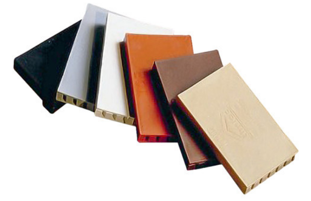

MortarThePoint Posted July 25, 2020 Posted July 25, 2020 What do people think of different weep types? Any recommendations? I like the look of the Invisiweep vent as it makes the hole on the outside smaller than for the standard ones (shown below above the standard ones)

Thedreamer Posted July 25, 2020 Posted July 25, 2020 We have the standard ones after while they just blend in and you forget about them.

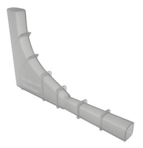

PeterW Posted July 25, 2020 Posted July 25, 2020 Is it brick or render finish..? We use these Timloc TW1

MortarThePoint Posted July 25, 2020 Author Posted July 25, 2020 (edited) 2 hours ago, PeterW said: Is it brick or render finish..? We use these Timloc TW1 It's a mixture of brick and rendered block work with block work inner leaf. Gosh, they're even smaller. They won't have the "Venturi effect outlet tube that reduces water pressure, allowing for optimal drainage" if you believe that. It's quite a small opening for venting through. Do the TW1 work well? Edited July 25, 2020 by MortarThePoint
PeterW Posted July 25, 2020 Posted July 25, 2020 Never had enough water in a cavity to worry once the cavity was closed off. When we had open cavities when building they seemed to work fine when it was raining.
