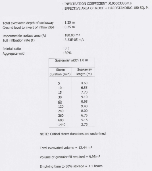

iSelfBuild Posted July 23, 2020 Posted July 23, 2020 I'm a little confused on this one. I have done a fair few percolation tests in the past in order to design drainage fields for treatment plants. Area = Population x Percolation Value (Time from 75% down to 25%) X 0.2 (secondary treatment) / A = P x Vp x 0.2 Calculating the VP is a dead easy process. I have attached the results of one of my rainwater soakaways on a site, I never did the calculations for this or the soil infiltration test for them. How is the soil infiltration (f) derived/performed? Once I have the figure how do I replicate this sheet I have too?
the_r_sole Posted July 23, 2020 Posted July 23, 2020 There's a BRE guide for rainwater soakaways it's all slightly different inputs and the output is in m3 too rather than m2 for a drainage field... Scottish building regs have a simplified calc too that you can use on a single dwelling... 1
iSelfBuild Posted July 23, 2020 Author Posted July 23, 2020 Thanks is this the simplified formula? I'm assuming I calculate VP the same way as in drainage fields? The soakaways may be sized using the following simplified formulae derived from BRE Digest 365: (A x 0.0145) – (a x f x 900) = S Where - A is the area to be drained in m2. a - is the internal surface area of the soakaway to 50% effective depth, excluding the base in m2. This has to be assumed for initial calculation purposes. f - is the soil infiltration rate, in m/s, determined in accordance with clause 3.9.1. This calculation produces Vp in secs/mm [conversion = (1/Vp) /1000]. S - is the required storage in m3. I know the VP was 29.7 for the drainage field, so I do a test like that and convert it into a f value? = (1/Vp) /1000]. a is the internal surface area of the soak away? I'm a bit confused by it being assumed?

iSelfBuild Posted July 30, 2020 Author Posted July 30, 2020 On 24/07/2020 at 13:54, iSelfBuild said: Thanks. So a - is the internal surface area of the soakaway to 50% effective depth, excluding the base in m2. So say 1m x 3m is... 0.5 x 1+1+3+3. So 4m2? Assuming the top isn't considered as well as the base of the pit. Expand Can anyone confirm I am working out the area correctly? 1m x 3m - 50% depth would be 0.5m, the base is excluded so it is 0.5 x 1+1+3+3 = 4m2 f = (1/VP) / 1000 or 0.00003367 = (1/29.7) / 1000 For 100m2 area to be drained: The soakaways may be sized using the following simplified formulae derived from BRE Digest 365: (A x 0.0145) – (a x f x 900) = S (100m2 x 0.0145) - (4 x 0.00003367 x 900) = 1.328m3 So how do I then take this 1.328m3 area and size the soak away considering it will be filled with clean rock.

iSelfBuild Posted July 30, 2020 Author Posted July 30, 2020 On 30/07/2020 at 17:22, Temp said: Correct Expand Any ideas how I take the m3 area and convert that into a real life sized drainage pit? I can't get my head round why the one I posted initially was specified at 1m x 10m

iSelfBuild Posted August 2, 2020 Author Posted August 2, 2020 On 02/08/2020 at 18:42, Ferdinand said: I haven't really followed this thread. However I would expect the number to be the volume of space for water, which would be minus the volume of solid gravel. Unless it has voids in the gravel, in which case the thread needs to continue ?. Expand That makes 100% logic ? But how do you calculate the volume or should I say displacement of gravel? The chap at the top (screen print) had Aggregate void at 30%... So 1.32 m3 x 3.33333* = 4.39 m3 I would say that is a very suitable sized soakaway???
