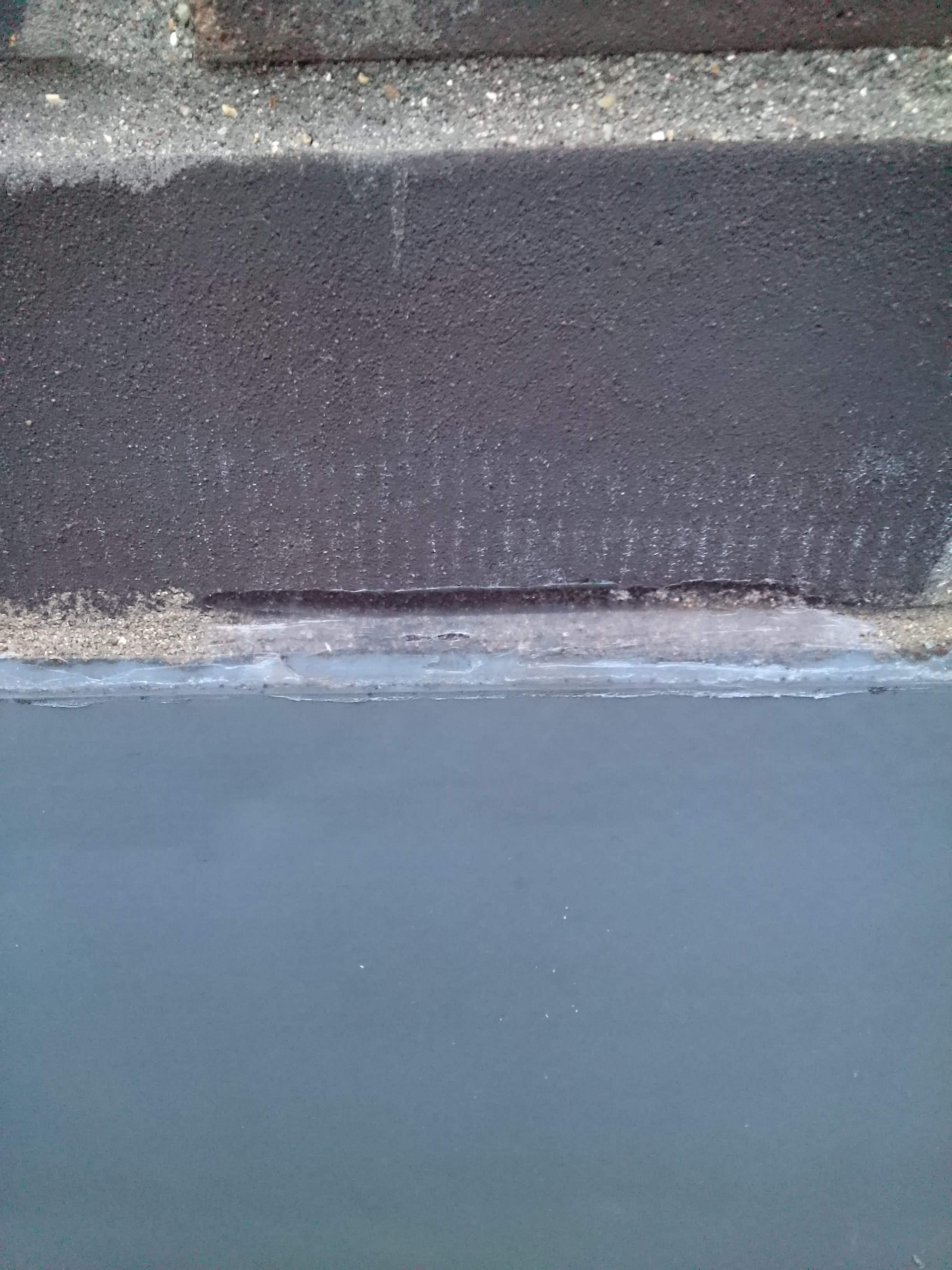

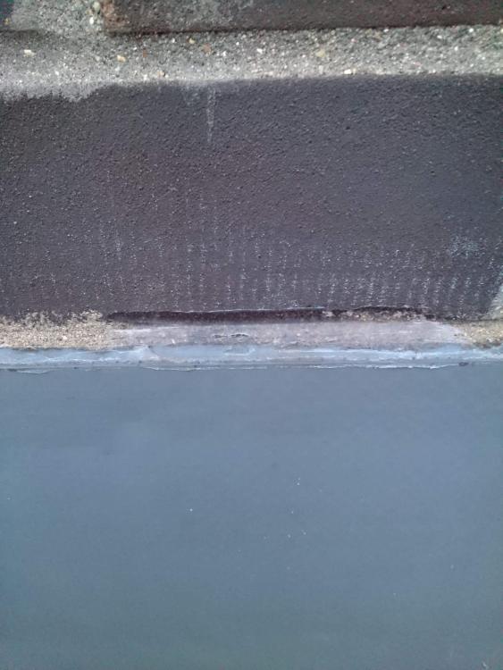

Posted (edited)
So i have done a little test on a section and my idea was to apply sealant to the entire bead of mortar and onto the brick for a couple of months and when the work is ready to be done just peel off the sealant. I've attached a photo.
Dont judge the terrible sealing...i've literally done it on a 10 cm section just to see if it holds ? The other option was to get a tube of stormdry cement sealer and apply to cover the gap.
Will the sealant idea likely cause any issues?
Many thanks

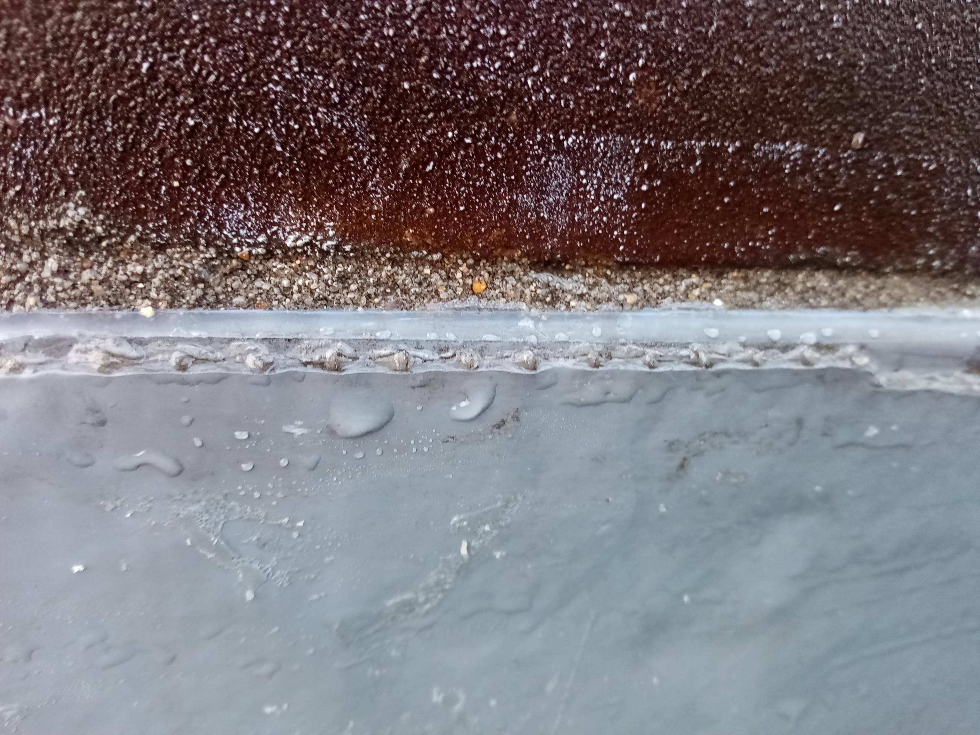

Posted
Hey,
So an update after the first storm here since the last leak.
After 7 constant hours of 50mph winds and rain there is no new water staining on the ceiling so I thought that it was all good until I used an inspection camera  to look in the roof space and noticed a small about of water (probably 10 drips worth)
The sealant seems to have drastically reduced the leak but not eliminated it totally. Summer is going to be very busy with alterations!

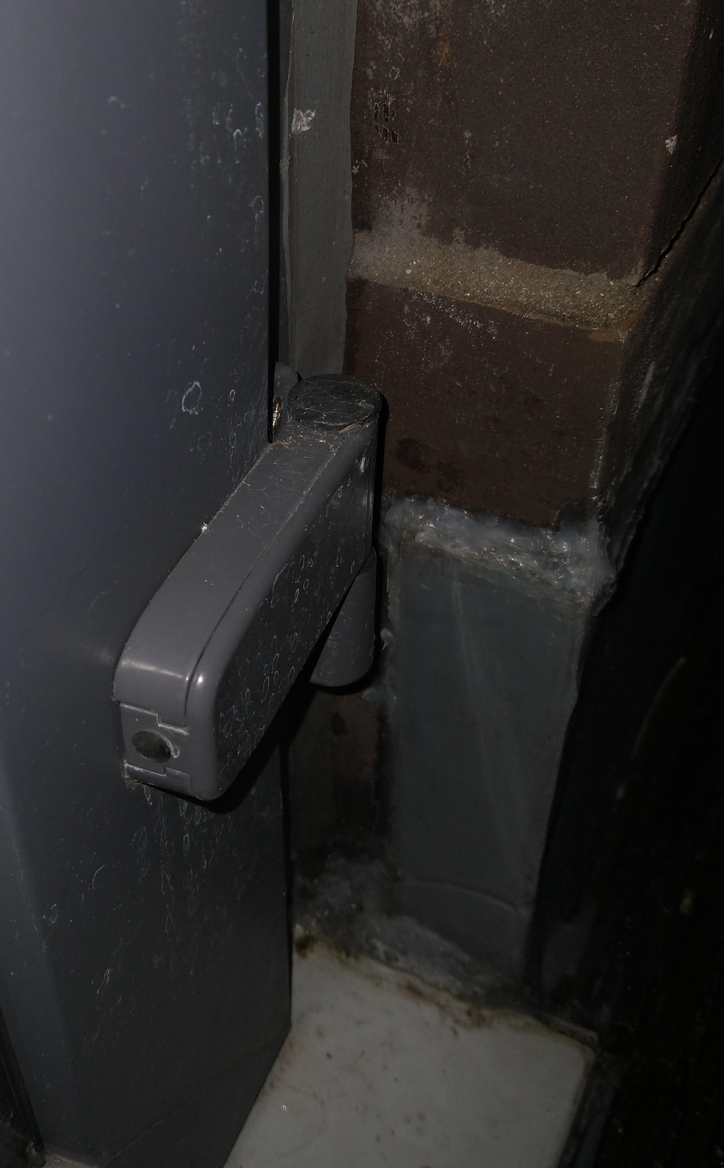

Posted
So I've been trying to investigate possible sources of this little leak from storm Bella.
The only area that looks suspicious is in the attached picture. Do you guys think this could be a big problem area?
