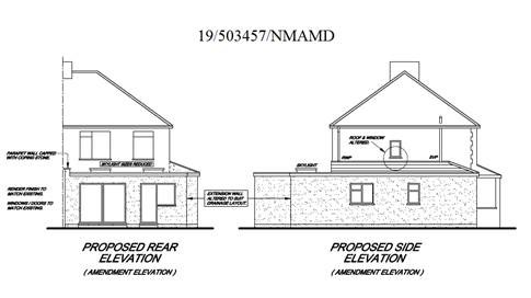

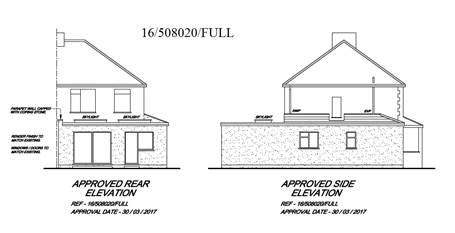

bill 54 Posted July 9, 2020 Share Posted July 9, 2020 hello ive an issue after more than a year with planning, i made a non material amendment to my permission granted single story & side ext, so have two drawings both with permission. the landing side window on amendment was changed from opener to closed, so spoke to my planning officer and was told both plans have been passed i can use the existing roofline side window detail. yesterday i received the email below from an enforcement officer. so do i have to implement an amendment Am I right in assuming you have carried out the planning permission as approved under 16/508020/FULL? If so has it been carried out strictly in accordance with the 2016 permission or only partly? I must remind you of the informative in the no material amendment which states: “Informative(s): (1) The applicant is reminded that this decision runs in parallel to planning permission 16/503457/FULL and therefore all conditions attached to the existing decision remain in place and must be observed” once this has been established, I will be able to advise accordingly. Link to comment Share on other sites More sharing options...

DevilDamo Posted July 9, 2020 Share Posted July 9, 2020 Your original Planning approval has the reference number 16/508020/FUL. The reference number referred to in the Informative is 16/503457/FUL. Your NMA reference number is 19/503457/FUL. Where has the Informative reference number come from? Was the NMA application submitted after the works had been completed/signed off? Am I right in saying the changes you were seeking as part of the NMA application was stepping in a part of the ground floor side wall along with raising the cill of the first floor side window (enabling the lean-to roof element to continue below)? Link to comment Share on other sites More sharing options...
bill 54 Posted July 11, 2020 Author Share Posted July 11, 2020 Thanks for the replies, spoke to planning today they had a complaint about a side window not being obscured and assumed it was the circled window, which it was not it was ground floor kitchen windows, apparently if he opens his landing window he can see my kitchen worktop and if i stick my chin on the worktop i can see his window. Theres a 6ft 8" wall within a 1m of the windows, and you don't have to obscure ground floor windows anyway. no work was carried out on side roofline before permission was granted on both plans there was nothing else they were concerned about it has creeped the misses out though so he may well of won 1 Link to comment Share on other sites More sharing options...
