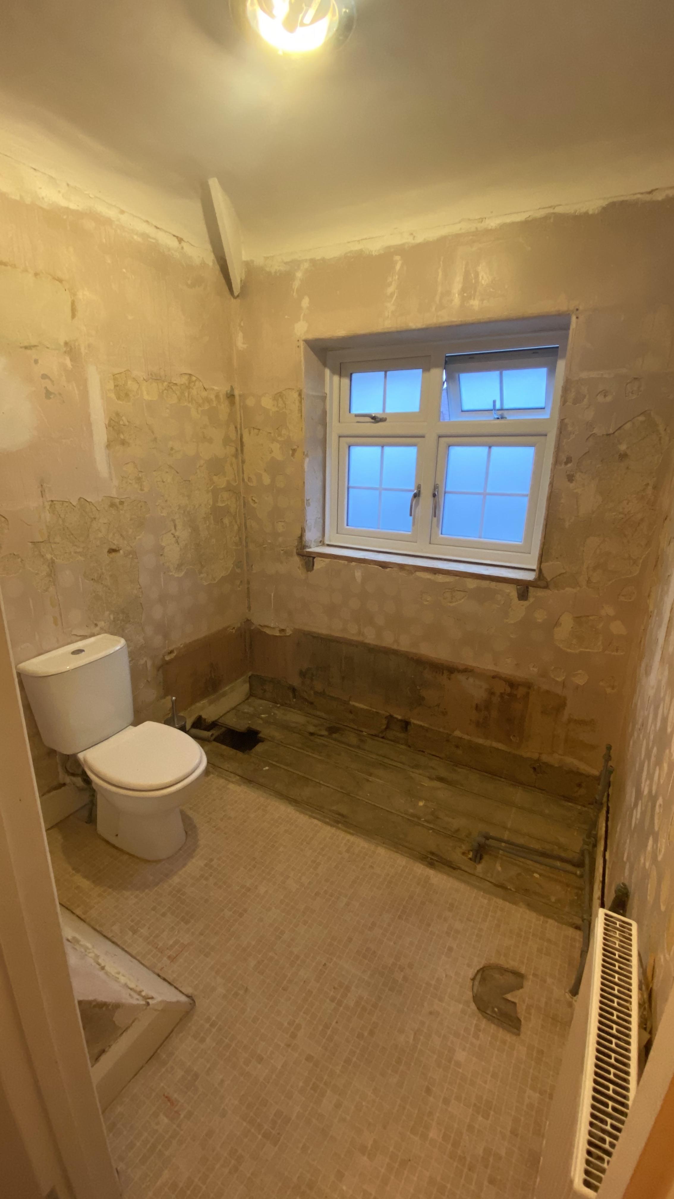

RDarko Posted July 7, 2020 Share Posted July 7, 2020 Hi everyone, We’re going to have our bathroom refitted in the very near future and we’ve decided we’d like a spa bath and a digital shower (not pumped but digitally controlled) Bath: https://www.thewhirlpoolbathshop.com/single-ended-baths/aquaestil-plane-solo-14-jet-whirlpool-bath shower: https://www.plumbworld.co.uk/mira-platinum-digital-shower-dual-concealed-101375-27988 I’ll have an electrician out to install the power but I wondered if anyone had any experience with this type of electrical install? The sort of cost to expect would be great too, we’re in south east London so a rough figure would be good as I’d rather not be overcharged! I’m assuming that the electric will be taken from the plug socket in the bedroom next door, drilled through into the bathroom and then run through an RCD and isolator? Is it possible to have an isolator in the bathroom on a pull cord above the door? (Please remember I’ve no experience of this and am not doing it myself, the bathroom is going to need to be replastered too and I want to make sure I have some knowledge for when an electrician visits for hiding of cables etc). Can the digital shower unit be installed under the bath? The Mira documentation says it can but it doesn’t seem right to me? Will there need to be more than one isolator with the electrics with different power going to two different pieces of electronics? It’s only a small bathroom and we’re going to have a small stud wall fitted to conceal the pipes for the wall mounted shower. Thanks in advance, any insight you can give me would be very much appreciated. Robbie. Link to comment Share on other sites More sharing options...
