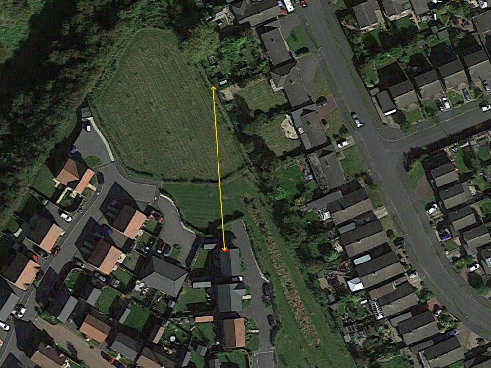

Laurence737 Posted July 5, 2020 Share Posted July 5, 2020 (edited) Hi Everyone, I was wondering if anyone had any advice on new side windows. We are planning a 4th bedroom conversion to the rear of our property that requires us to move the window from the existing bedroom onto the side elevation of our property. Are there any general rules of thumb that planners use to determine if the new window would need to be obscured? The side window overlooks our drive and garage and then an open expanse of green land, the next property is a good 30-40m away from the window. Ideally we would like to avoid having to have a frosted window in the bedroom, and was hoping someone might be able to shed some light on what our chances might be getting this through planning? Thanks Edited July 5, 2020 by Laurence737 Link to comment Share on other sites More sharing options...
DevilDamo Posted July 5, 2020 Share Posted July 5, 2020 In ‘normal’ Planning situations, first floor side facing windows would need to be obscured glazed and contain no openings below 1.7m above finished floor level. This is also the PD requirement and guidance. However, each application is determined on its own merits so the LPA should be a lot more relaxed in your case as the new first floor side window would not appear to pose any overlooking issues. Just make sure you deal with it via a formal Planning application (and I assume part of the main extension works) as LDC application for PD would automatically restrict its design and appearance. Not to mention a PD window would not meet the BR escape window requirements resulting in you having to provide a protected staircase. Link to comment Share on other sites More sharing options...
Temp Posted July 5, 2020 Share Posted July 5, 2020 (edited) Given the new window would not overlook anyone I would put in a planning application or make it part of the planning application for your extension if one is needed. I think there is every chance it would be approved. If they put in a condition requiring obscure glass I would appeal the condition on the grounds its not necessary to prevent overlooking. It might be worth taking a photo from the height of the proposed window to show the view in that direction to prove no overlooking would occur. Edited July 5, 2020 by Temp Link to comment Share on other sites More sharing options...

Mr Punter Posted July 6, 2020 Share Posted July 6, 2020 12 hours ago, DevilDamo said: Some LPA’s insist on fully obscured glazed windows irrespective of their height while others state the part up to 1.7m is to be obscured while the part above 1.7m can be clear glazed. That would be a conversation you’d need with your LPA but as mentioned above, you shouldn’t even have to get to that stage of compromise. 16 hours ago, DevilDamo said: PD window would not meet the BR escape window requirements I often see conditions to prevent overlooking requiring windows to be obscure glazed and fixed shut. I cannot see why it would apply to this case other than to protect the gardens of the houses at 2 o'clock, but they appear to be protected by trees. Link to comment Share on other sites More sharing options...
Ferdinand Posted July 6, 2020 Share Posted July 6, 2020 50 minutes ago, Mr Punter said: I often see conditions to prevent overlooking requiring windows to be obscure glazed and fixed shut. I cannot see why it would apply to this case other than to protect the gardens of the houses at 2 o'clock, but they appear to be protected by trees. In this case you the OP could propose for example a window to permit venilation but prevent full opening by a stop, which would meet the overlooking condition. Suspect one may get away with a disengageable stop so that it could also be an escape window, provided that the stop could not be practically disengaged to allow overlooking. Link to comment Share on other sites More sharing options...

DevilDamo Posted July 6, 2020 Share Posted July 6, 2020 5 hours ago, Mr Punter said: I often see conditions to prevent overlooking requiring windows to be obscure glazed and fixed shut. I cannot see why it would apply to this case other than to protect the gardens of the houses at 2 o'clock, but they appear to be protected by trees. Yes, no openings below 1.7m so you are normally allowed high level/fan light windows. The only time the permanently fixed shut requirement comes into play is BR’s and those windows, which are located within 1m of a boundary. Unless the trees have some kind of protection in the form of TPO’s, then applicants cannot look to use them as a balance to help provide or maintain privacy issues. Link to comment Share on other sites More sharing options...
