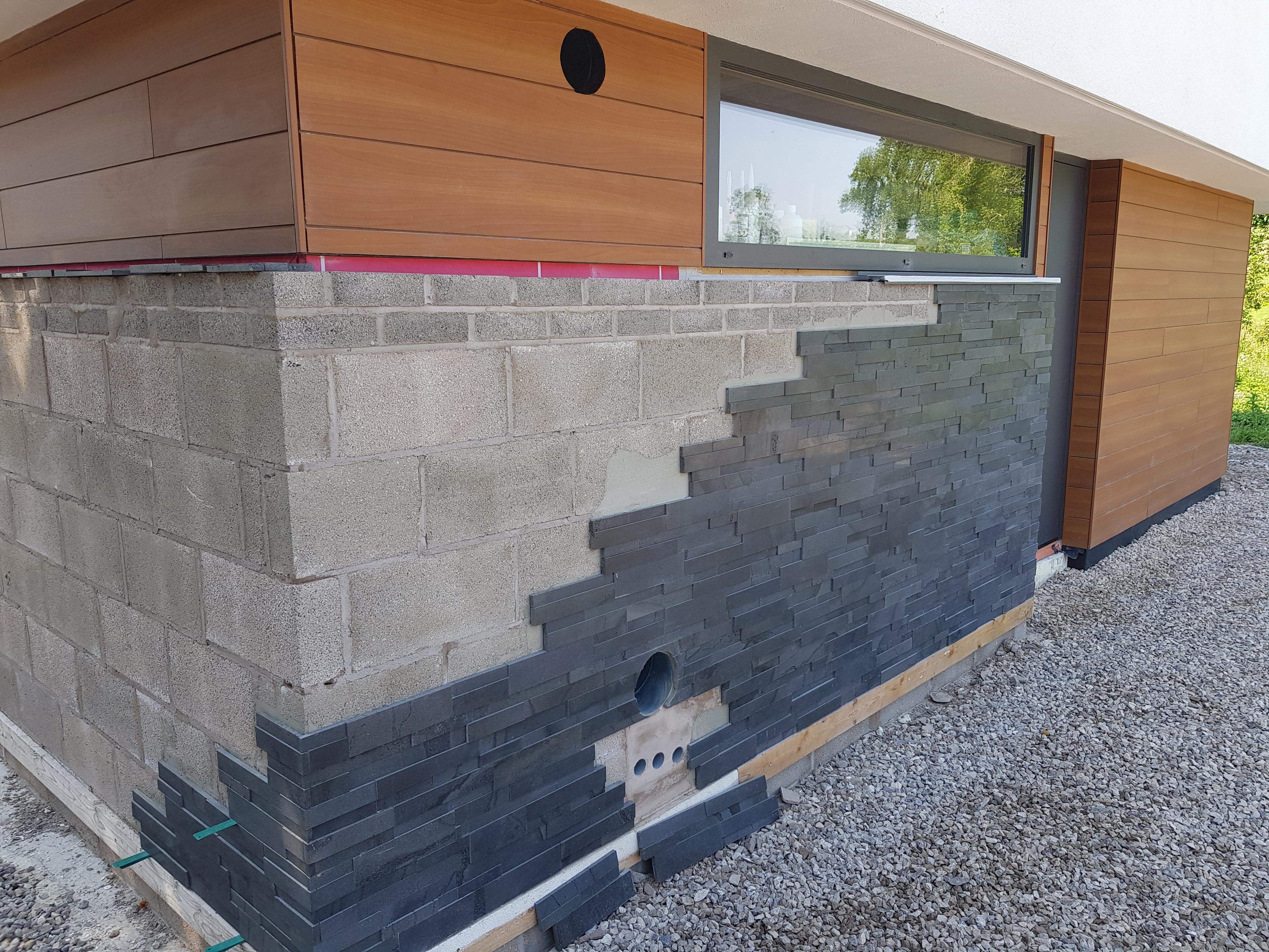

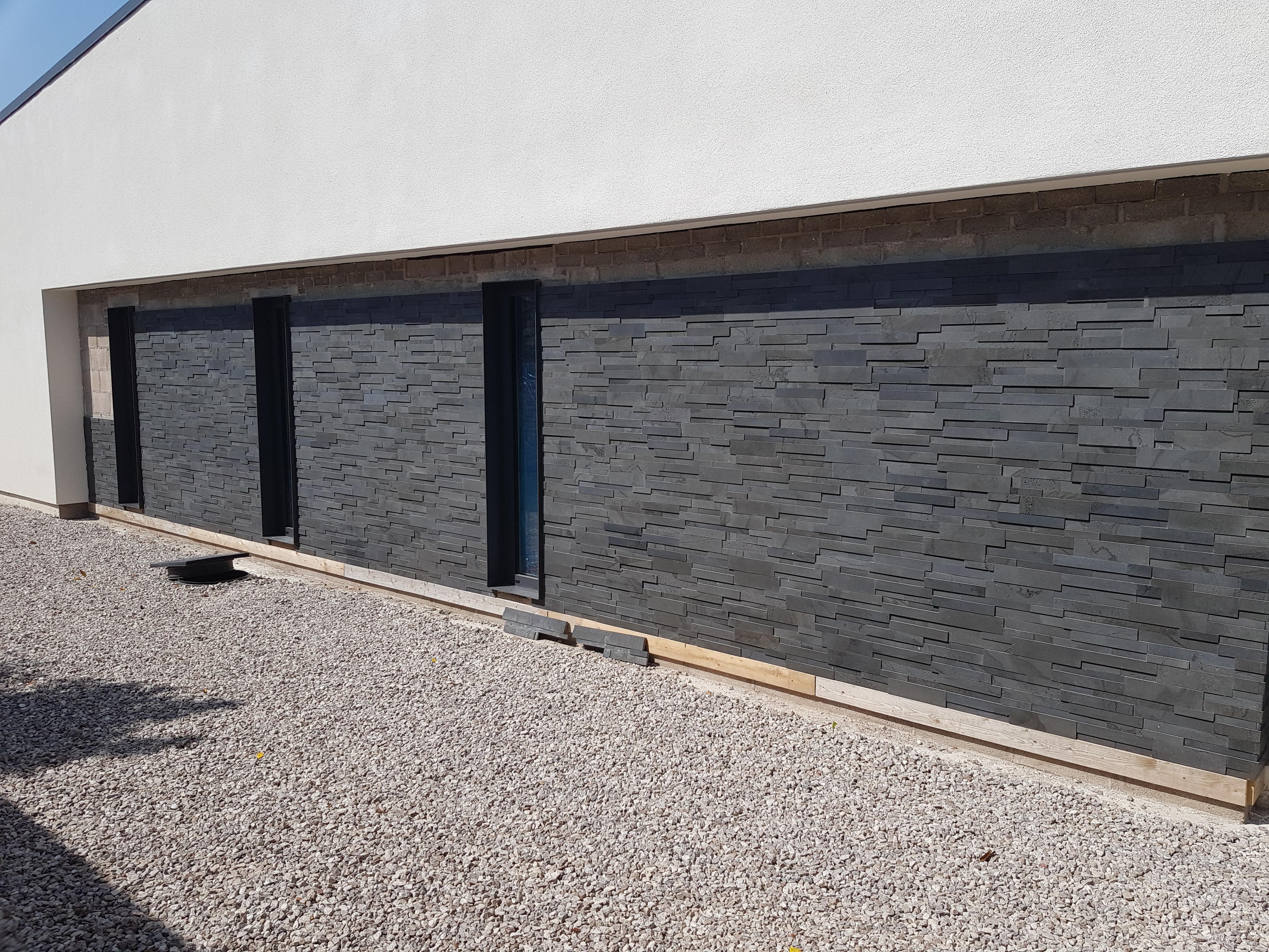

Pete Posted June 24, 2020 Share Posted June 24, 2020 22 hours ago, Euan G said: Hi Does anyone have any experience/recommendations for stone cladding panels such as z clad, z stone, tier etc. Looking to use on bottom edge below render and on front aspect of living room. TIA Pictures of my Norstone cladding 1 Link to comment Share on other sites More sharing options...
Dan F Posted June 24, 2020 Share Posted June 24, 2020 9 minutes ago, Pete said: Pictures of my Norstone cladding Looks great. Is this Aksent Grey Basalt? We have the standard rock panels specified, but these looks good.. Did you order direct, or via a supplier? Link to comment Share on other sites More sharing options...
Pete Posted June 24, 2020 Share Posted June 24, 2020 39 minutes ago, Dan F said: Looks great. Is this Aksent Grey Basalt? We have the standard rock panels specified, but these looks good.. Did you order direct, or via a supplier? Graphite Lava Stone, went direct to Norstone, guy called Jack Jago Link to comment Share on other sites More sharing options...
Euan G Posted June 24, 2020 Author Share Posted June 24, 2020 10 hours ago, Pete said: Pictures of my Norstone cladding That looks well! Link to comment Share on other sites More sharing options...
