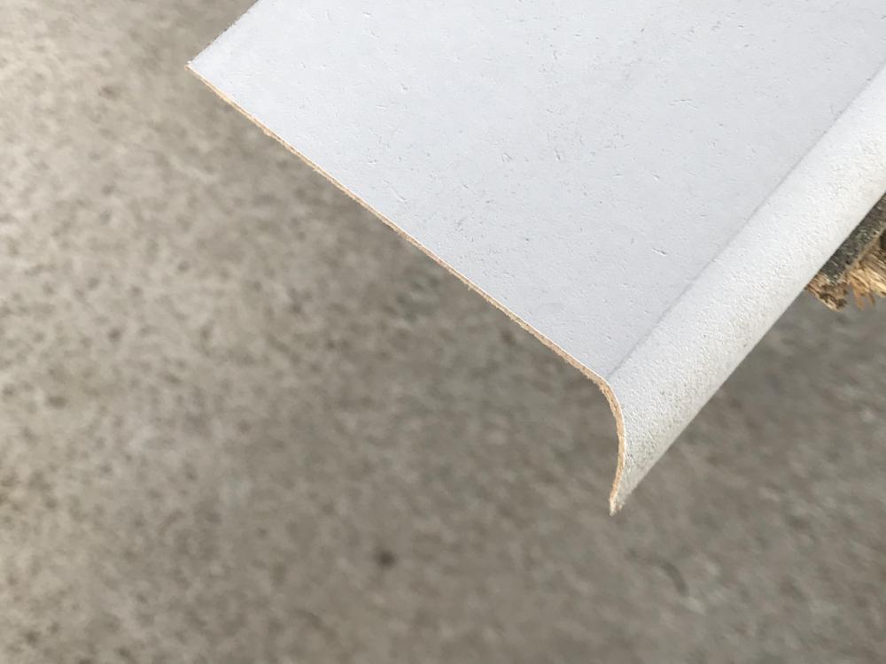

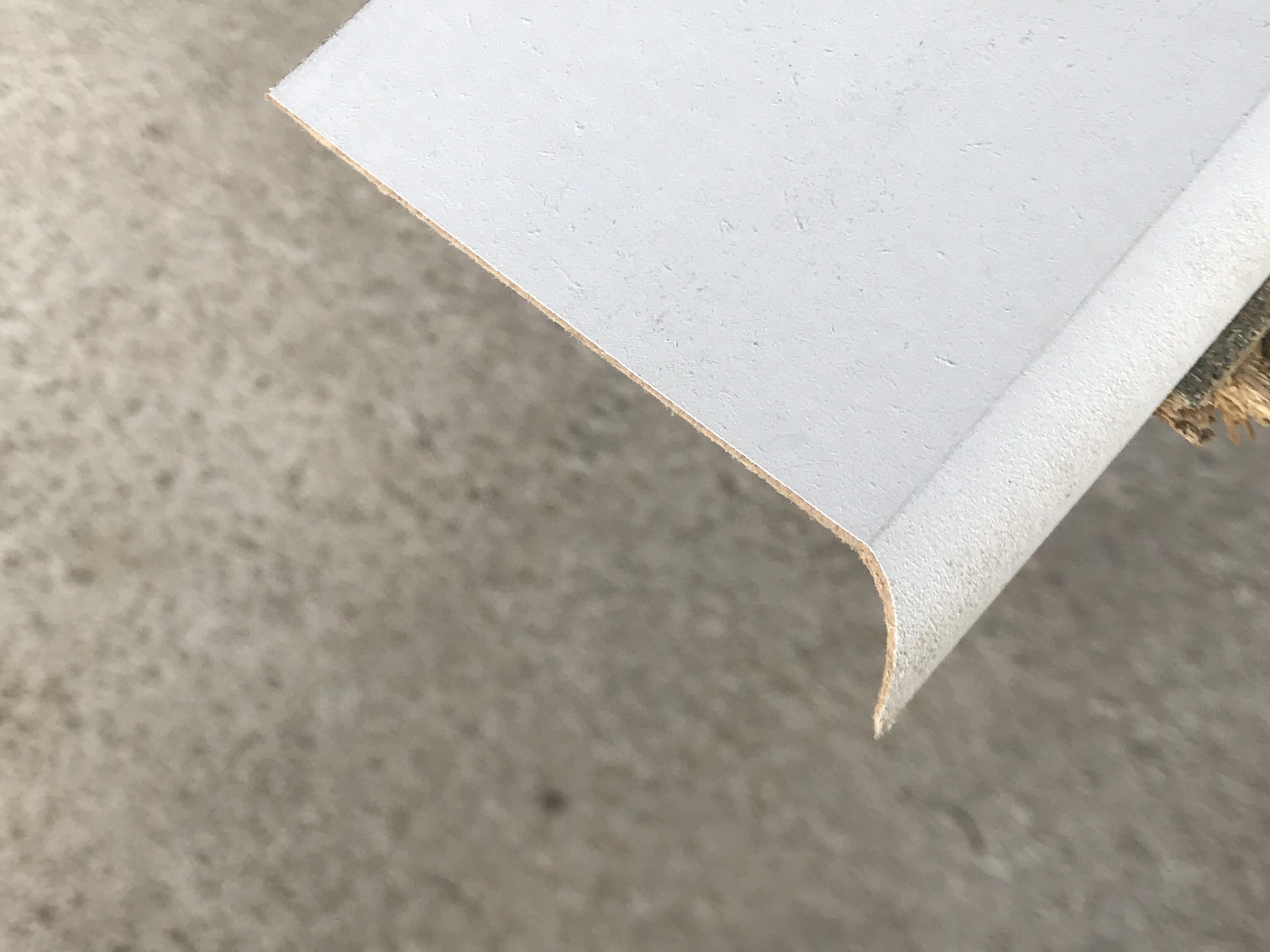

Just started fitting some mdf pencil round architrave / skirting. Bought a few new tools, fine cut saw 9tpi and a coping saw.

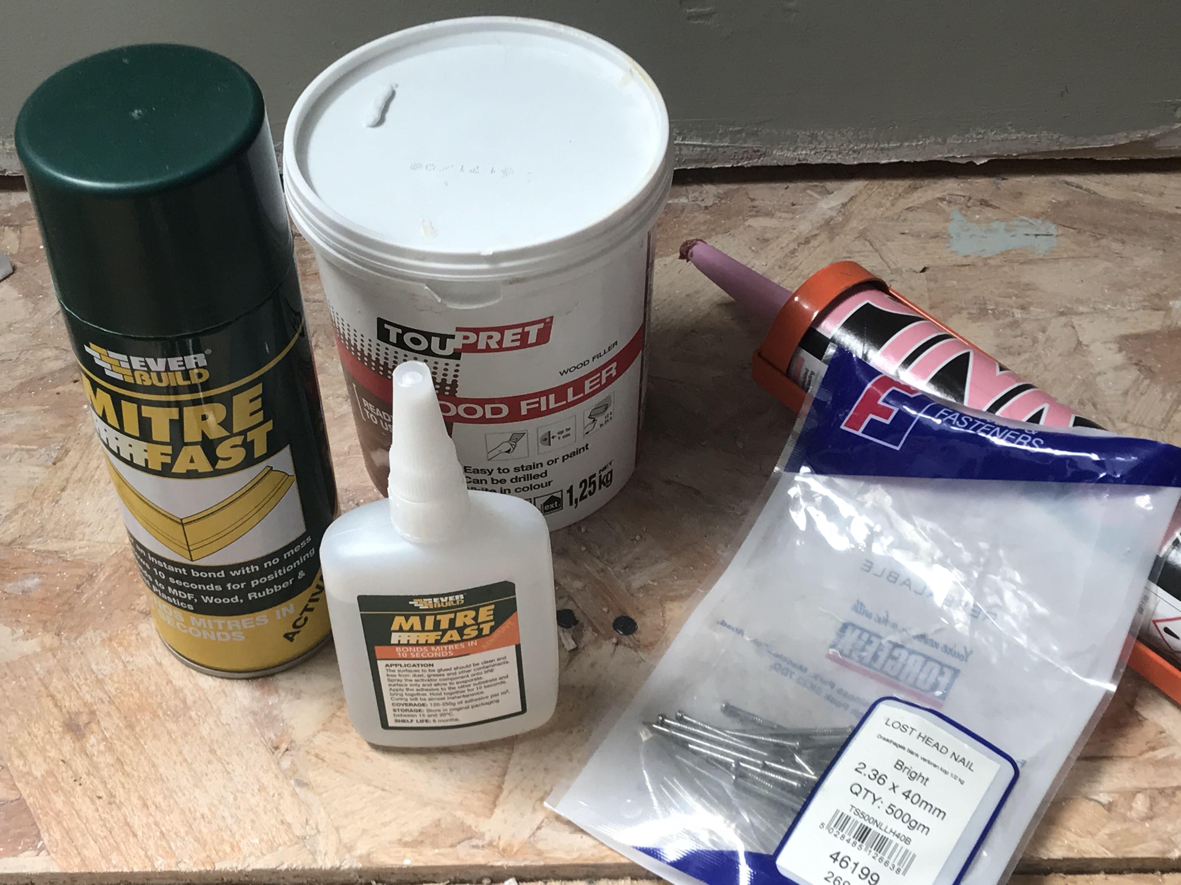

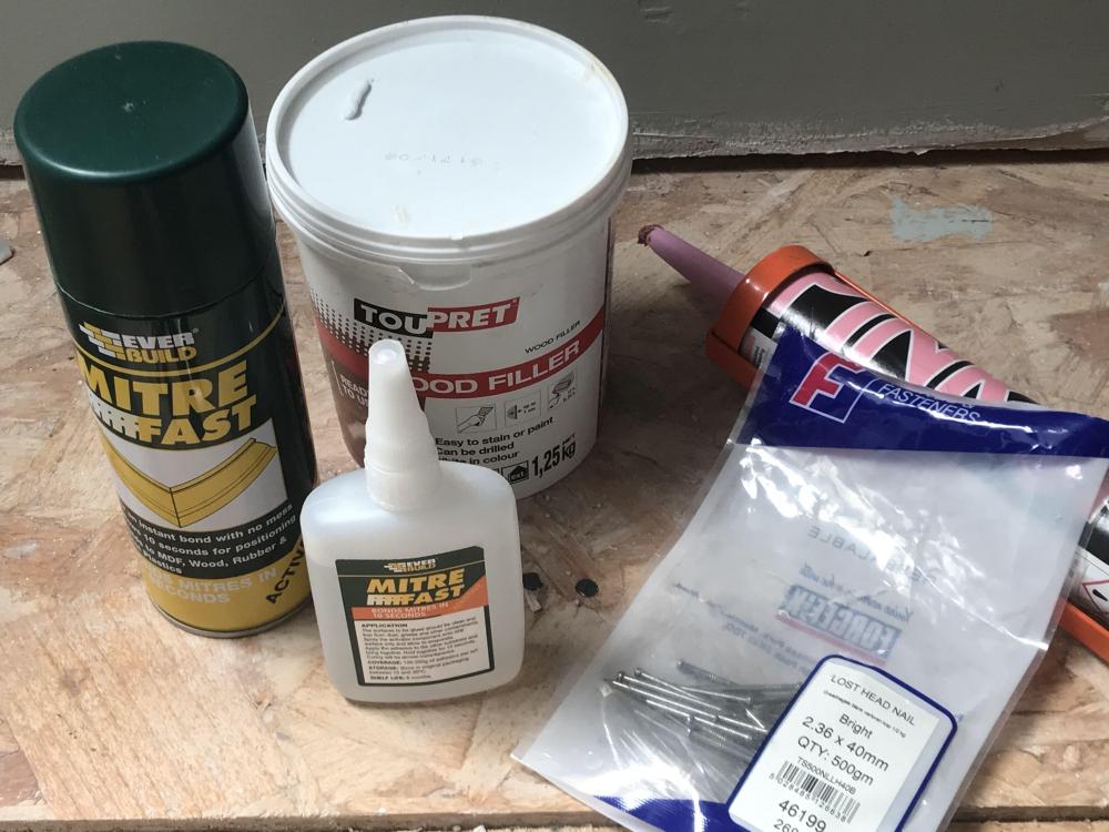

The Mitre fast is excellent for fixing the door architrave together before nailing to the door frame. Nailing which is a novelty in my build.
Pink grip goes off quite quickly and Toupret wood filler excellent. No nonsense caulk for filling small gaps.
I use a damp sponge to clean excess off as you go.
