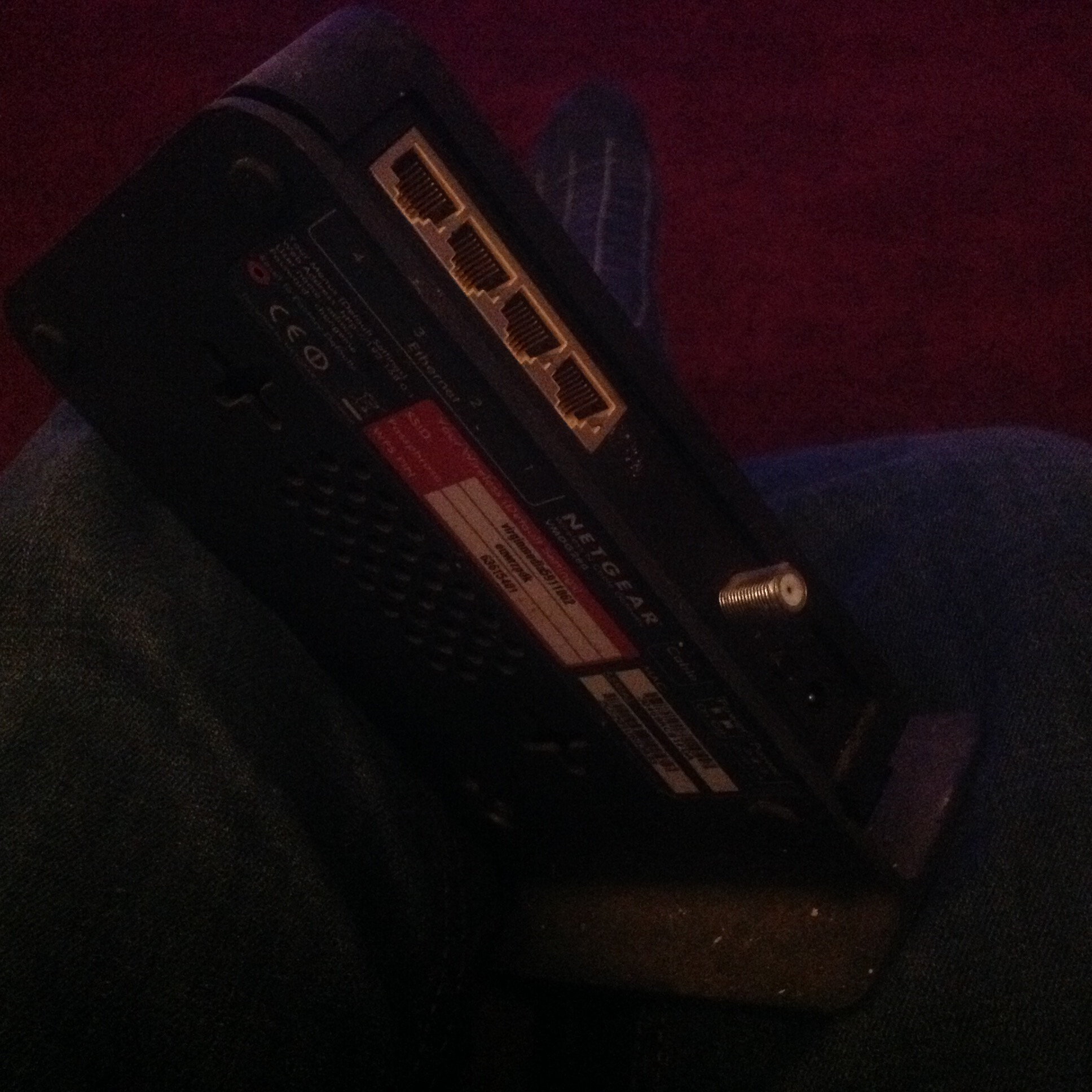

Nickfromwales Posted December 22, 2016 Author Share Posted December 22, 2016 7 hours ago, Onoff said: I can probably dig out and post an old TalkTalk router if you want to have a play: https://community.talktalk.co.uk/t5/Computers/Setting-up-a-second-router-as-a-slave-on-your-network/td-p/800353 This is my old VM one. Any use? I see the one you have has an rj45 in and 4 out. This one has only got the F socket and no other means to introduce the 0's and 1's ? If your saying I can run a cat 6 from my VM box to your one, I gain 4 more ports, and it'll also give me a WAP, then I'd be very grateful indeed. ? Link to comment Share on other sites More sharing options...

Onoff Posted December 22, 2016 Share Posted December 22, 2016 5 minutes ago, Nickfromwales said: This is my old VM one. Any use? I see the one you have has an rj45 in and 4 out. This one has only got the F socket and no other means to introduce the 0's and 1's ? If your saying I can run a cat 6 from my VM box to your one, I gain 4 more ports, and it'll also give me a WAP, then I'd be very grateful indeed. ? Yep that's the concept. It might take a bit of messing around with settings but the collective on here should be able to assist. Nothing lost to try if you can wait for the post. I've done it with two BT HomeHub 3 routers. I've now upgraded to a single Homehub 4. In theory I should be able to try it out with the TalkTalk one. Link to comment Share on other sites More sharing options...
Onoff Posted December 22, 2016 Share Posted December 22, 2016 Your Virgin in then is cable? Link to comment Share on other sites More sharing options...
Nickfromwales Posted December 22, 2016 Author Share Posted December 22, 2016 Yup. Link to comment Share on other sites More sharing options...
PeterW Posted December 22, 2016 Share Posted December 22, 2016 @Nickfromwales stop being a tight arse and buggering around with old cable modems and buy this !! 16 Port Switch Won't give you a wifi point but none of the others will either as they have no way of becoming slave access points... Link to comment Share on other sites More sharing options...

Steptoe Posted December 22, 2016 Share Posted December 22, 2016 ok, so the main problem with using an old router as a switch is you 'normally' lose one of the ports, as you need it for your 'incoming' cable, but, if you think you can work with that then i'll have a dig in the loft and see if I have another router kicking about, I'll even send it to you 'plug and play' , so to speak. Link to comment Share on other sites More sharing options...
