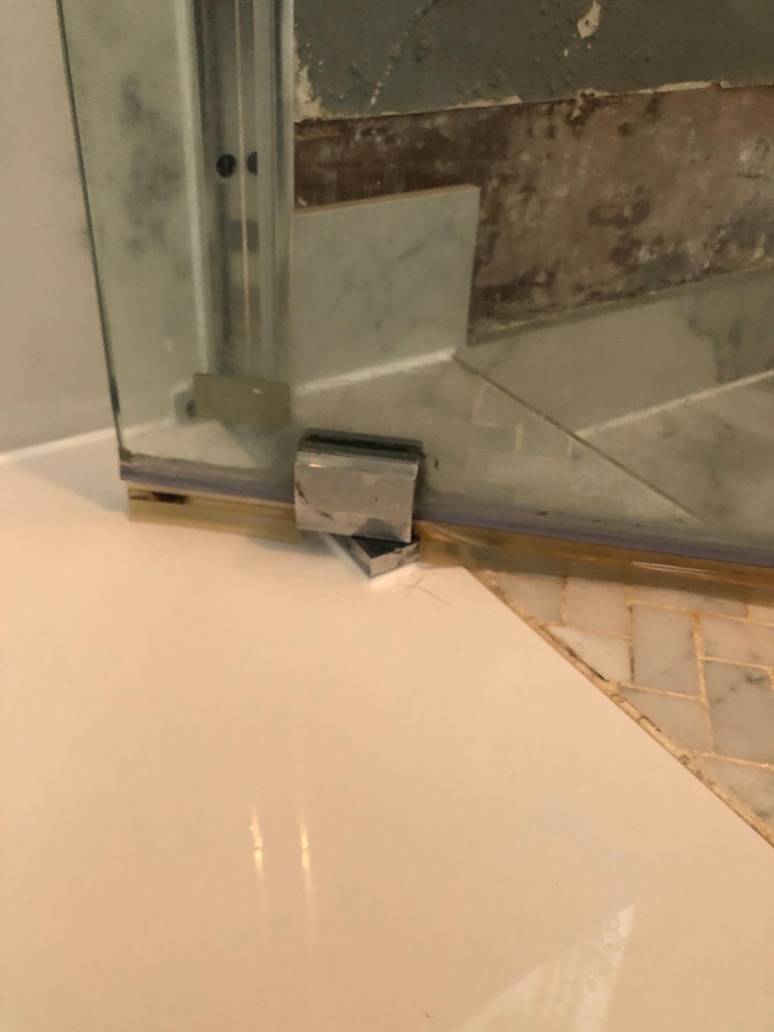

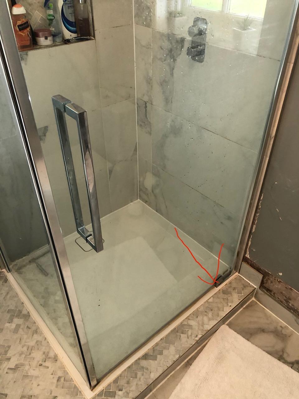

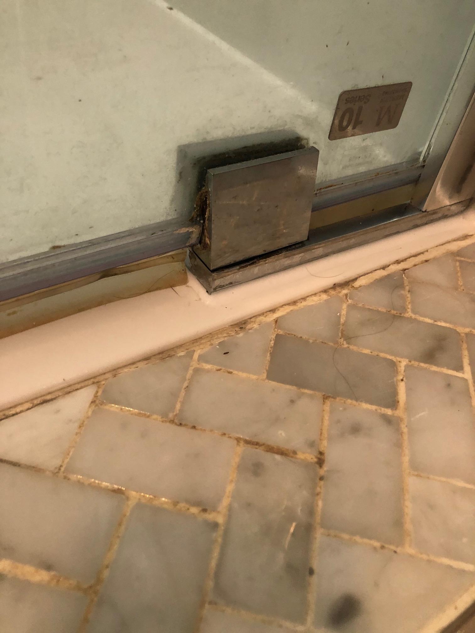

TomHarry Posted June 18, 2020 Share Posted June 18, 2020 Hopefully someone can help. The shower seal isn't quite doing enough to stop water coming out of the gap between the shower door frame and the sill. Really can't think of a solution but causing us a few issues as can be seen on these pictures. Any recommendations? Maybe an aluminium profile that sticks to the shower tray to create a barrier, might be a bit ugly? Link to comment Share on other sites More sharing options...

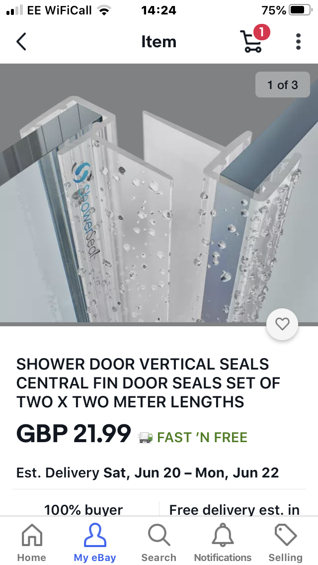

Mr Punter Posted June 18, 2020 Share Posted June 18, 2020 It is a pretty bad design. You could try replacing the seal with another. Some have fins that stick out to deflect the water. The one you have does not look great anyway. Link to comment Share on other sites More sharing options...
nod Posted June 18, 2020 Share Posted June 18, 2020 Plus one with above I’ve used these guys Just measure the thickness of the door glass Link to comment Share on other sites More sharing options...
Temp Posted June 18, 2020 Share Posted June 18, 2020 (edited) Can't really tell from the photo but how deep is the tray? Looks almost flat? There are seals like this one... https://www.theshowerseal.co.uk/shower-seals/shower-seal-h1-4-6mm850.html ...that have a drip/deflector but they really need a barrier/upstand to deflect it over. You might need to run a bead of sealer along the tray just inside the door to form an upstand so the water drips off the deflector on the tray side of the upstand. This won't work on the small part that pivots into the tray. Edited June 18, 2020 by Temp Link to comment Share on other sites More sharing options...
TomHarry Posted June 19, 2020 Author Share Posted June 19, 2020 Thanks guys, the tray is flat with a small gradient to the drain and has always been an issue so I would agree that it's not the best design. I've tried a different seal and was worse so put the old grubby one back on. The only part it leaks is the small gap between the pivot door and the seal, Can Link to comment Share on other sites More sharing options...
ProDave Posted June 19, 2020 Share Posted June 19, 2020 43 minutes ago, TomHarry said: The only part it leaks is the small gap between the pivot door and the seal, Can Can you not slide the seal along a bit more so it closes up that gap? Or does it open up again? If so a few spots of clear silicon to stop it sliding along and keep that gap closed. Take the seal strip off and soak it in bleach to clean it up. Link to comment Share on other sites More sharing options...
TomHarry Posted June 22, 2020 Author Share Posted June 22, 2020 Already seems as close as possible but it still just leaks out. I'm thinking I might have to put something like this in but I can't say it looks very attractive - https://www.byretech.com/acatalog/drip-guard.html Link to comment Share on other sites More sharing options...
