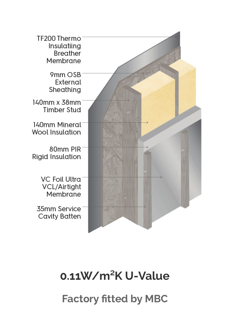

oldkettle Posted August 19, 2020 Posted August 19, 2020 1 hour ago, Thorfun said: ... a little different to our open panel TF but still looked like very good work. What insulation are you planning for the open panels?
Thorfun Posted August 20, 2020 Author Posted August 20, 2020 9 hours ago, oldkettle said: What insulation are you planning for the open panels? pretty standard really. 140mm Frametherm 32 with 80mm PIR on top. 1
dpmiller Posted August 20, 2020 Posted August 20, 2020 80mm plus service void? That's LOTS of very long screws...
Thorfun Posted August 20, 2020 Author Posted August 20, 2020 11 minutes ago, dpmiller said: 80mm plus service void? That's LOTS of very long screws... this is true! I am still toying with the idea of just using 50mm PIR (or somewhere in between, maybe 70mm) but the building control drawings are being done with 80mm PIR and the SAP calculations as well. so I'll probably just stick with that and deal with the screws as and when I get to it. I based the build up on the MBC wall as well as many other companies' designs...
