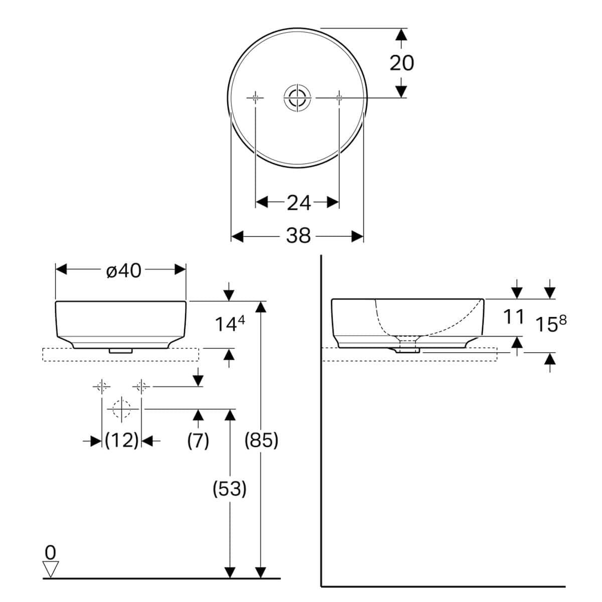

ToughButterCup Posted June 8, 2020 Share Posted June 8, 2020 I have one of these and need a single, table top (sometimes called deck mounted) mixer tap. The sink height is 144mm. Is there a recommended height for a tap for a sink of that height? Link to comment Share on other sites More sharing options...
ProDave Posted June 8, 2020 Share Posted June 8, 2020 This sink is 160mm high so a bit taller. the tap is 330mm to the very top Link to comment Share on other sites More sharing options...
Temp Posted June 8, 2020 Share Posted June 8, 2020 Our basin is 170mm high and about 275mm from plughole to spout. Fitted a pressure regulator to hot and stop water splashing. Link to comment Share on other sites More sharing options...

Mr Punter Posted June 8, 2020 Share Posted June 8, 2020 Sometimes it is handy to be able to get a mop bucket under the tap, so size height accordingly. 1 Link to comment Share on other sites More sharing options...
