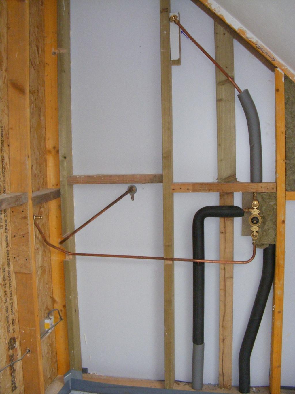

Jenni Posted June 6, 2020 Posted June 6, 2020 Hello. Please could you help me understand concealed shower valves. I'm looking for one that will run an overhead rose and a small hand shower. I've found this that I like https://www.victorianplumbing.co.uk/hudson-reed-round-triple-concealed-thermostatic-shower-valve-with-diverter-rndtr03 When I read the information about it, I think the middle knob sets the temperature, and the 2 other knobs are one for each of 2 outlets. But, it says it diverts to a third outlet. Can anyone explain please?
Onoff Posted June 6, 2020 Posted June 6, 2020 (edited) That seems expensive for a start! Similar to the Reign model I and a few others on here have. Still Hudson Reed. Top control does the rainfall head flow Middle sets temperature Bottom does the handset flow You can have both going at once. Good price here: https://www.qssupplies.co.uk/bathroom-furniture-shower-taps/57864.htm Edited June 6, 2020 by Onoff
ProDave Posted June 7, 2020 Posted June 7, 2020 I have exactly the same one as @Onoff Here it is before the wall board goes on: This is where mine came from https://www.britishbathroomcompany.co.uk/reign-triple-shower-valve
Jenni Posted June 7, 2020 Author Posted June 7, 2020 (edited) Thanks for the heads up on the price, I'll have a good scout around before buying. It's thanks to BuildHub numbers that I'm focusing on Hudson Reed, I just prefer the completely round knobs to the ones you guys have. Interesting the link you post gives an option of with diverter or without. So it seems I need one without, though I wonder if I got one with diverter, how would the unit be different, and could it function with just 2 outlets in use? Edited June 7, 2020 by Jenni
Jenni Posted June 7, 2020 Author Posted June 7, 2020 Thanks for the picture ProDave, I'll add it to my file, they're so helpful when it comes to biting the bullet and starting a job / getting a Job done.
