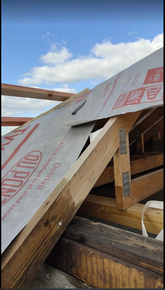

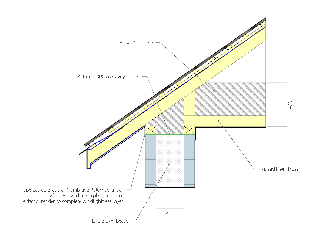

tonyshouse Posted September 7, 2020 Posted September 7, 2020 What happens re insulation above the cavity closure?
Iceverge Posted September 7, 2020 Posted September 7, 2020 @tonyshouse A picture painting a thousand words and all that. (BTW I took a lot of inspiration from your blog!Thanks) m 1
GaryW Posted December 2, 2020 Posted December 2, 2020 On 12/06/2020 at 14:50, Iceverge said: We've had a 250mm Cavity done this week with blown eps bead. I climbed into the attic earlier to have a look as I was sceptical the beads would fill right up to our cavity closer (450mm DPC). I checked the entire perimeter of the house and was pleased to find the beads had billowed up the DPC everywhere. Its given me confidence that around the windows and doors there's a tight fill as well. I may do some trial holes if I can find the time but thus far I'm more impressed than I thought I'd be. Did you have a cost per m2? toying between 200mm or 250mm cavity and cost will swing it ?
Iceverge Posted December 5, 2020 Posted December 5, 2020 €100/m³ installed including VAT. Beware there may be structural issues with a wider cavity and extra costs with wider footings and wall ties.
Oz07 Posted December 5, 2020 Posted December 5, 2020 (edited) So 8.30 ish exc vat per sq m of 100mm cavity, 1.5 for 150, 2x for 200 etc etc Edited December 5, 2020 by Oz07
Sophiae Posted June 13, 2023 Posted June 13, 2023 Are you still happy with your choice of beads? How are your heating bills been?
Iceverge Posted June 13, 2023 Posted June 13, 2023 The beads haven't settled in the least. They bowed up the 450mm DPC cavity closer when they were blown in. Earlier this year I climbed into the attic and did a few spot checks to see if any settling had occured. None had. Similarly when I checked with a thermal camera there were no voids. We've used about 17kWh/m2 over the last 2 years in heating bills. A bit more than PHPP predicted but I'm not sure why. I don't think it is the beads. One thing that I think is important is getting wind tightness very secure as the nature of them is porous and susceptible to wind washing. (Where heat is lost by blowing through the insulation) If you are building a cavity wall I would recommend them or full fill fiber batts. 1
