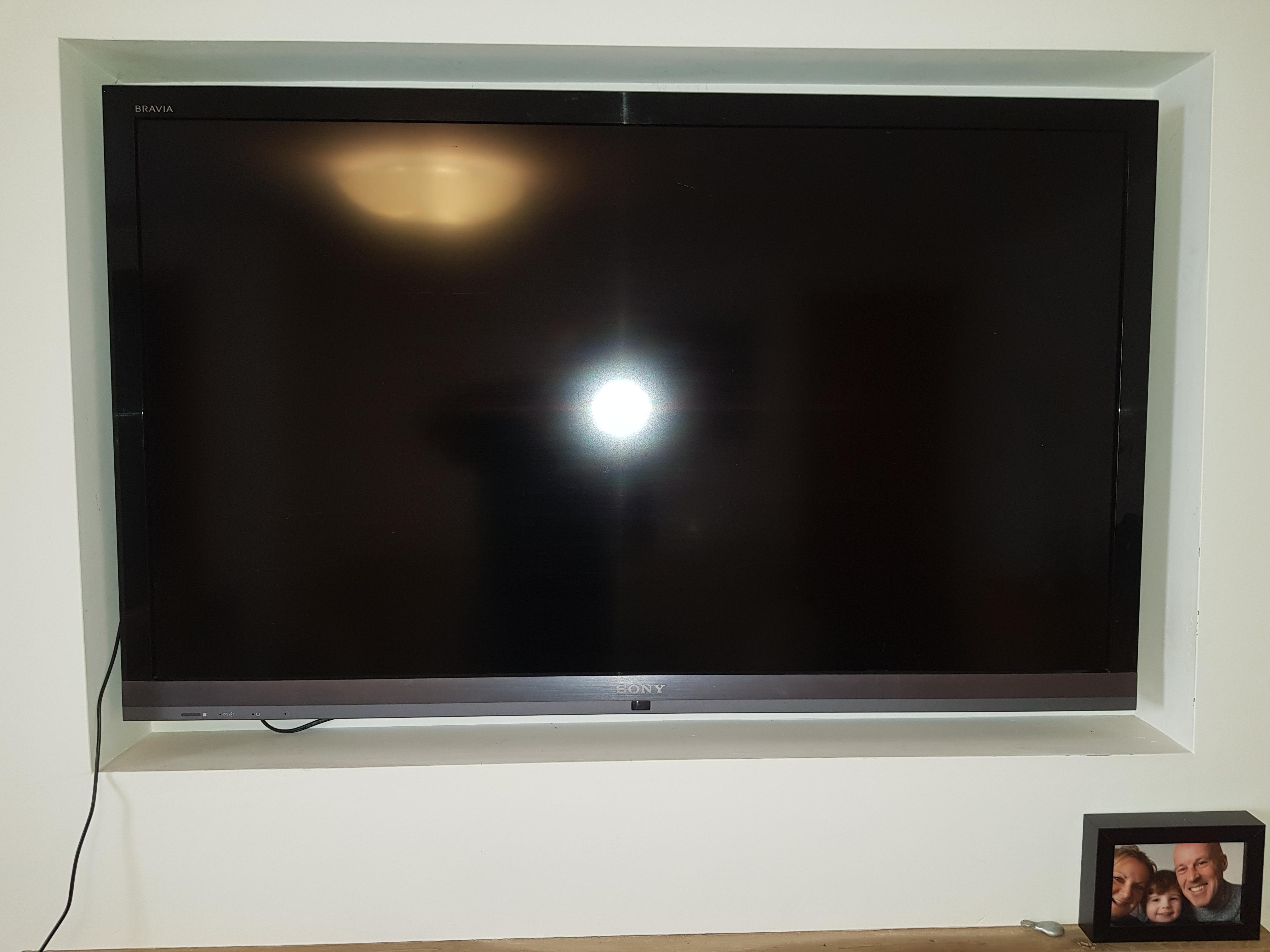

Pete Posted June 5, 2020 Share Posted June 5, 2020 This is mine that I built in. It has a 35mm gap all the way round and I can get the tv onto the bracket easily enough. Dis regard the cables as i have been trying something out, they are not normally there! Link to comment Share on other sites More sharing options...
