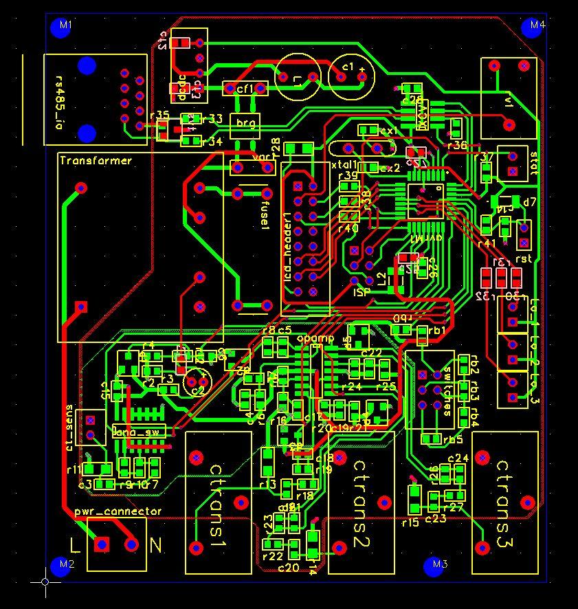

The subject of solar diverter design has come up a few times on here. I know I could buy one, but the ones that work properly cost rather too much for what they are, and the cheap ones don't do what I need... So I am making my own - it's a fun job that keeps my hand in with PCB design, layout, coding etc now that I don't get to do this any more at work. I have a design based on this one but with a "few" changes to add robustness, simplicity and a better display.
I have a few considerations to review, and this site is pretty good for finding these things out.
What do we think is the smallest input current we need to differentiate from zero? Is it smaller than 50mA, or is this sufficent resolution?
How accurate does the microcontroller clock need to be? At 1% it gives a 0.5Hz accuracy for mains frequency measurement, and I think this needs to be better - 50ppm seems more reasonable - this gets to near to a perfect mains frequency measurement.

Hopefully got my concerns resolved... Yes, resolution down to 100mA is useful, so it is included, and yes, accurate frequency measurement is needed.
So, can anyone tell me what this is going to be? ;)
Board dimensions are 80mm x 95mm. I think it packaged up nicely.
Next steps are to double check the netlist and make sure the ground plane doesn't have too many holes poked in it. Then I can think about getting a prototype made assuming I can remember how to hand solder 0.8mm pitch TQFPs!
Typically for an engineer, spec creep happened. So in addition to the usual energy metering it has:
Current monitoring for all loads for the purposes of monitoring use and fault detection
RS485 interface for control and reporting
20x4 LCD character display
Lots of filtering and EMI suppression - sometimes I think half the components on a board don't do anything when all is working right...
Capacity for 5 control switches (may not need to use all of them in the code)
Thanks. I used to this sort of thing to pay the bills so I hope I am not too rusty...
That one is single phase. It just has 3 current transformers for monitoring the loads. All a bit unnecessary for the case where everything works but it is useful for fault indication and various monitoring schemes I am planning. The main current clamp is off board.
