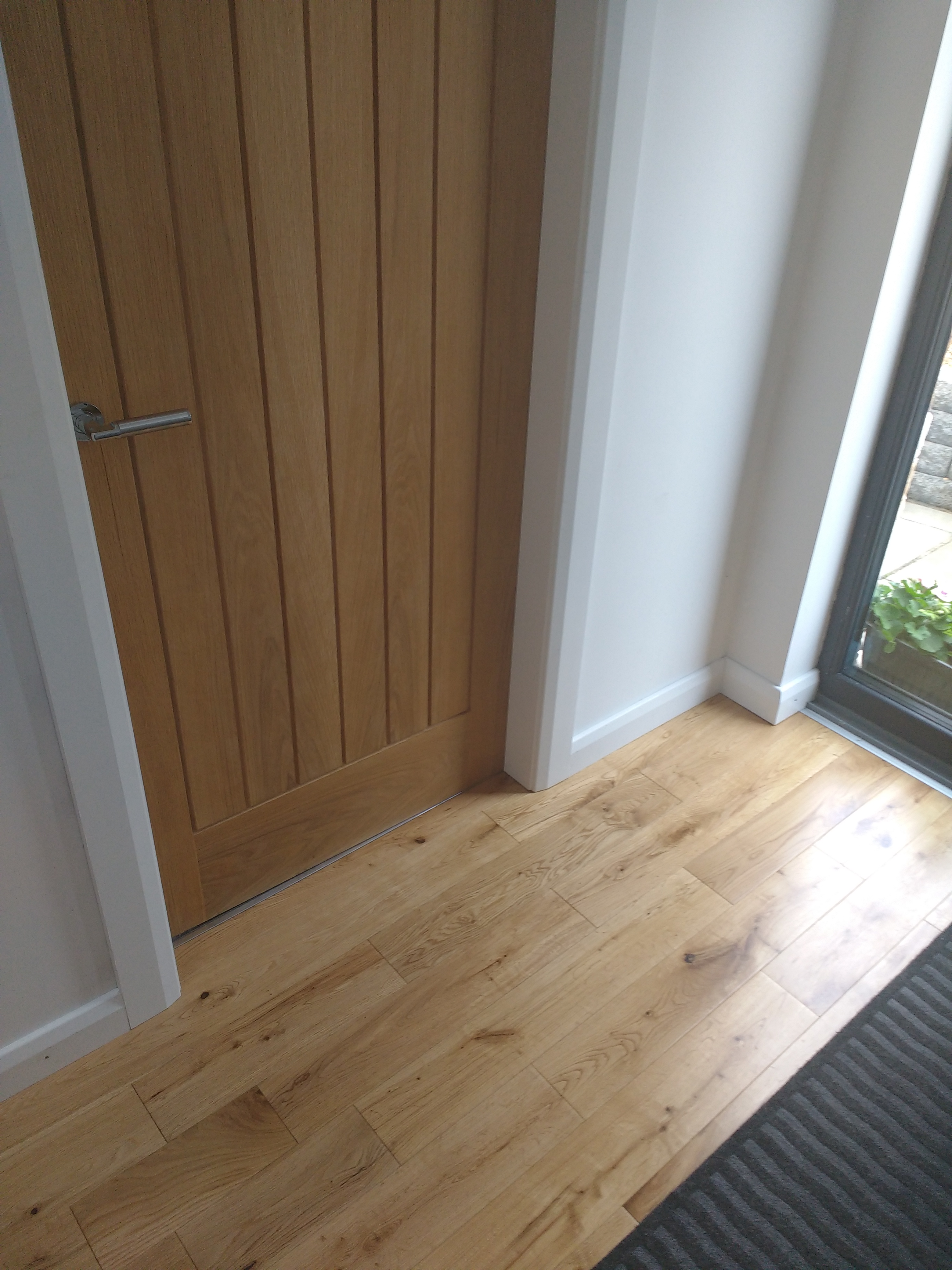

I went MDF route and used 75mm for both the skirting and architrave. Of hand I think a 5.5m length was £6. Easy to cut and easy to fill and as you say no knots to worry about. Below is the only picture I have on my phone.
I've used 69mm MDF skirting and architrave. It doesn't warp or move and is easy to glue to the wall. I wouldn't use soft wood with a painted finish again.
