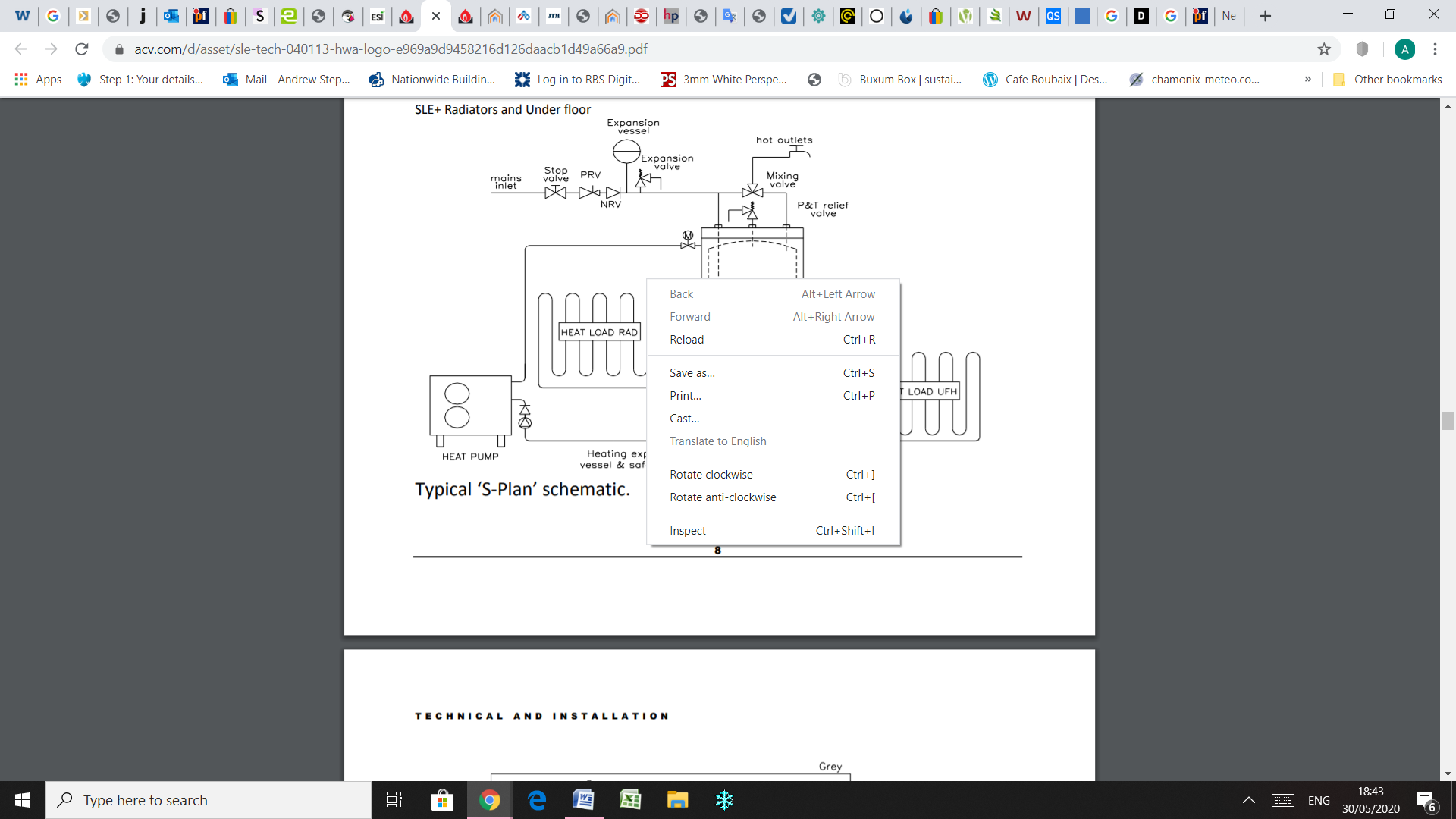

If you haven’t already bought it, avoid that ACV like the plague as they are a nightmare to plumb in and really don’t work that well.
Depending on air tightness and uValues you could go UVC but for 3 en-suites it will need to be 400 litres. Alternative is a thermal store that will also take your excess PV but both need good water pressure. Option on the UVC would be fit a small buffer tank too to keep the boiler condensing and not short cycling.

Hi Peter
I have not purchased a cylinder yet, only Hep20 pipe. What are the issues with plumbing the ACV cylinders? On the face of it they appear a good solution, fast reheat times, using the heating water as a buffer to feed the UFH. Also have an immersion elemnet to dump my solar. Can see they need filling/emptying in a defined sequence to stop the inner tank being deformed. Attached one of their schematics.
We will be well insulated, and as airtight as we can. Not ready for airtest yet. Going to fit Hansgrohe Ecosmart showers as 9ltrs/min. What would you recommend if not the ACV? Thanks for your input, it is appreciated, thanks
