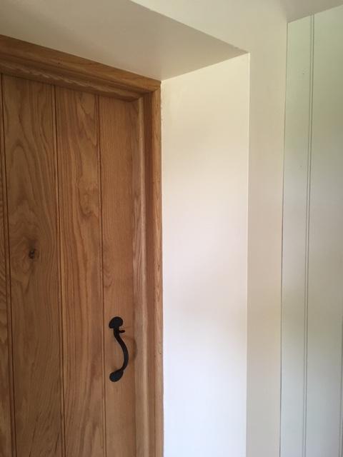

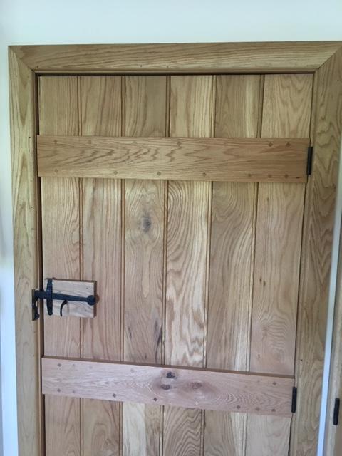

Redoctober Posted May 26, 2020 Share Posted May 26, 2020 Hi @Boris we too have a similar set up leading from our kitchen area into the utility room. See photos below as to how we overcame it. Doesn't look out of place and if anything, i feel it adds a bit of character. Two shots from the kitchen side showing the deep recess and then one from the other side, in the utility room showing it to be flush so to speak. I hope this helps. 1 Link to comment Share on other sites More sharing options...

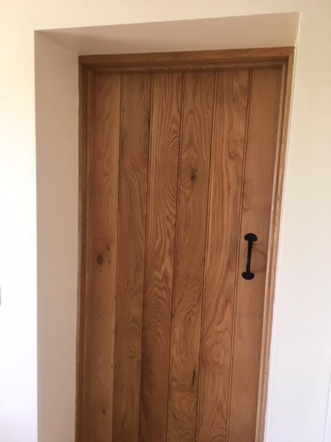

ProDave Posted May 26, 2020 Share Posted May 26, 2020 My door to the garage is as above. I have several internal doors on wide load bearing structural walls and I had to make my own door liners, doubly difficult because they are Oak. 2 Link to comment Share on other sites More sharing options...
Boris Posted May 27, 2020 Author Share Posted May 27, 2020 Thanks Redoctober and ProDave, they look great. Our style of door is more like ProDave's. ProDave could you post a pic with a door open ? TIA Link to comment Share on other sites More sharing options...
