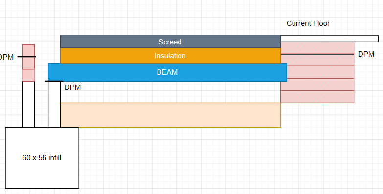

carlosdeanos Posted May 26, 2020 Author Posted May 26, 2020 (edited) @nod @Russell griffiths I only have an engineer to work out my steel calcs at the moment. I might just wait to see what the BC inspector says once he checks out the foundations. The extension is 8m wide and only 3.3 out, so I would only need 3m beams I think. I am just a bit confused about how they tie into the existing wall as it looks like it would be below current DPC to me, in order to get the insulation and screed on and be at the same level as the current floor. Edited May 26, 2020 by carlosdeanos
Declan52 Posted May 26, 2020 Posted May 26, 2020 19 minutes ago, carlosdeanos said: @nod @Russell griffiths I only have an engineer to work out my steel calcs at the moment. I might just wait to see what the BC inspector says once he checks out the foundations. The extension is 8m wide and only 3.3 out, so I would only need 3m beams I think. I am just a bit confused about how they tie into the existing wall as it looks like it would be below current DPC to me, in order to get the insulation and screed on and be at the same level as the current floor. They don't need to tie into your existing wall. You need to work out from the finished floor you have what depth of screed and insulation you intend to use for the extension. This will then give you the top of the beam. From that you can easily work out what height they need to sit on and thus how many courses of block/brick to get to this height and your finished concrete height of the foundations.
carlosdeanos Posted May 26, 2020 Author Posted May 26, 2020 @Declan52 This is what I believe I would need to do to tie into the existing wall. please excuse the terrible drawing, just threw it together. That is how I assume I would make this work. Going outwards from the existing wall.
Declan52 Posted May 26, 2020 Posted May 26, 2020 So you can either build another wall along your existing wall to hold the beams. More money. Or bust out holes in the wall and have them sit on the existing wall. More time Use a slab. Best option. What is the floor construction of the house. Is there any air bricks on the perimeter which would indicate a suspended floor, block and beam.
carlosdeanos Posted May 26, 2020 Author Posted May 26, 2020 Its suspended timber and yes its got some air bricks. Yes I would much rather do slab, I think I may well just do that and make sure I compact the hardcore well.
