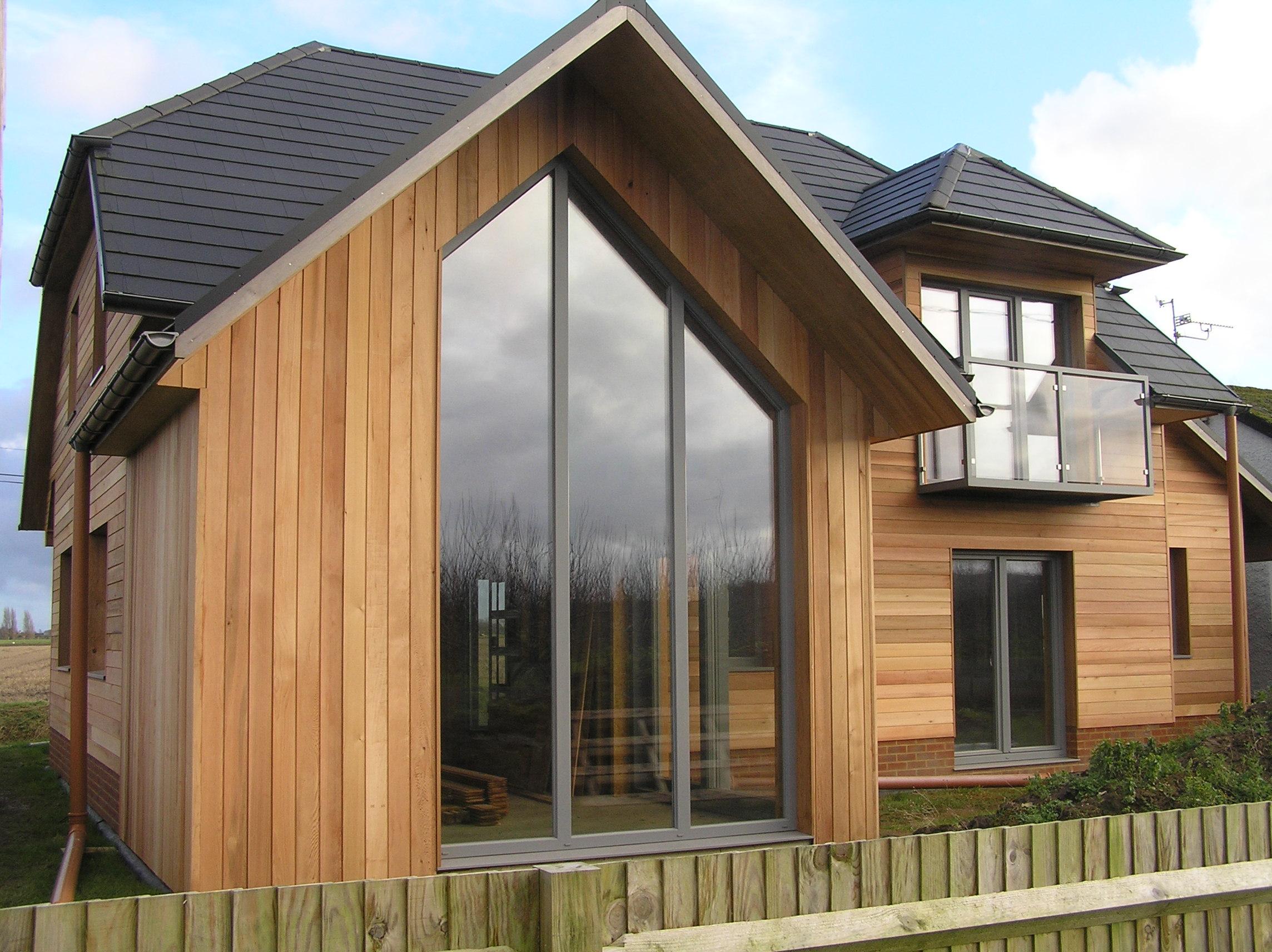

We have a single storey gable end on our sitting room which is just over 4m high. We decided to have it 3/4 glazed to have it look a little different to the normal fully glazed gable. It also reduces heat loss as the corner of the gable faces North. The biggest installation consideration is the weight of the glazing which in our case was 6mm triple units. The installers broke one of the units carrying it from the front to the back of the house. IIRC it weighed 150kg and was unsupported.
