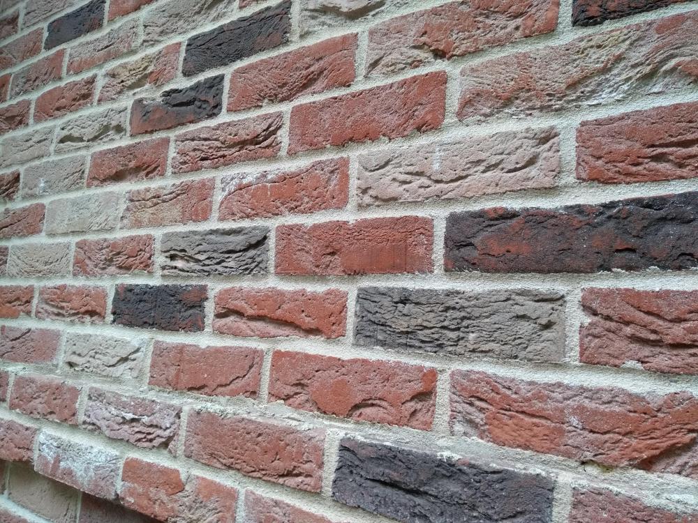

Temp Posted May 17, 2020 Posted May 17, 2020 On 17/05/2020 at 11:13, Danzka said: Unfortunately no, good idea though... did you have any trouble with the irregular shape of them? Expand This is our brickwork. Perhaps not quite as rustic?
