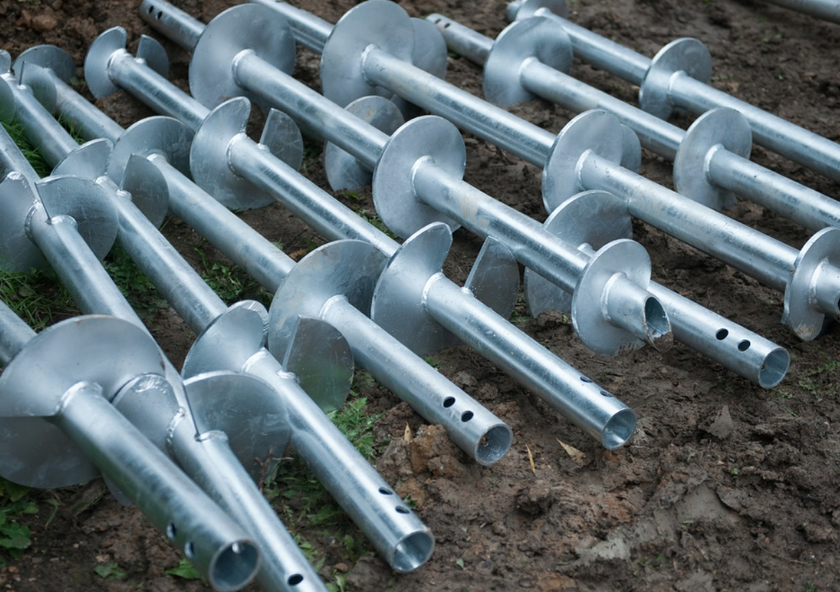

Herbie Posted May 14, 2020 Author Share Posted May 14, 2020 2 hours ago, Dreadnaught said: Welcome to BuildHub Herbie! What type of piles are you going for? I will be using screw piles for my build in Cambridge (once restrictions are lifted). Hey mate. Well the quote we had and will likely go for is for 30, 300mm open bore piles to go down up to 10m. Not sure if that's screw piles? It's because the ground is soft clay with high plasticity and we will need to level the land somewhat. Do you know what foundations you're putting down after the piles at all? I've not even looked at quotes for this. The piling alone is close to 40k. Certainly eye-watering but if it has to be done, then it has to be done. At least you know your house won't go anywhere. Meeting the pilers on site next week, so ill see if he has a better idea to reduce the cost. Link to comment Share on other sites More sharing options...
Dreadnaught Posted May 14, 2020 Share Posted May 14, 2020 (edited) No, yours aren't screw piles from the sounds of it. With yours, they will drill a hole, remove the auger, and then fill the hole with a metal cage and concrete. With screw piles, the steel pile itself has a screw ending. It is torqued in to the ground and left there; no concrete involved. See picture below. For mine, above the screw piles I will have insulated reinforced concrete raft, 100mm thick, with 200mm edge "beam" and cross-ribs, all tied in with the screw piles. The insulation under the raft, which is often EPS, will for mine be PIR. It is all being designed for me by a specialist in Ireland. Edited May 14, 2020 by Dreadnaught Link to comment Share on other sites More sharing options...

Tom Posted May 15, 2020 Share Posted May 15, 2020 18 hours ago, Dreadnaught said: For mine, above the screw piles I will have insulated reinforced concrete raft, 100mm thick, with 200mm edge "beam" and cross-ribs, all tied in with the screw piles. The insulation under the raft, which is often EPS, will for mine be PIR. It is all being designed for me by a specialist in Ireland. Are the screw piles themselves isolated from the concrete in the raft? Thinking about thermal bridging... Link to comment Share on other sites More sharing options...
Dreadnaught Posted May 15, 2020 Share Posted May 15, 2020 3 minutes ago, Tom said: Are the screw piles themselves isolated from the concrete in the raft? Thinking about thermal bridging... Its an understandable question but, no, the tops of the screw piles, which are capped, are embedded in the concrete raft, so that the dwelling's weight is fully transmitted through the piles and does not bear upon the ground (and so the tree roots are happy). The issue of thermal bridging from the piles is occasionally raised. It is a marginal thermal bridge that can be taken into consideration in the overall thermal modelling. The piles can be sheathed with insulation for some of their depth if needed (not in my case). Link to comment Share on other sites More sharing options...
